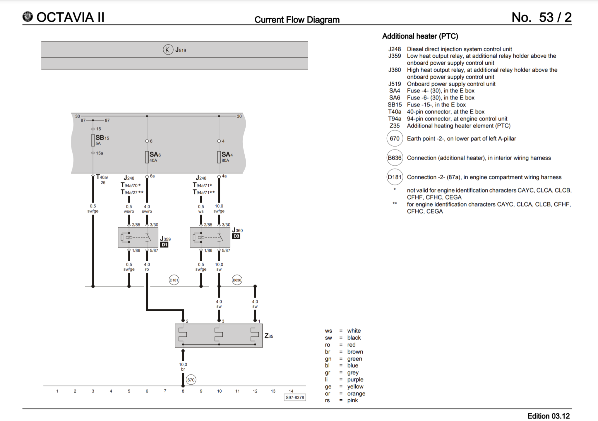

  2. I managed to find the wiring diagram now, I'll post it on here incase someone comes across it in the future. Yeah the later one seemed like an easier install but just a bit trickier to source and are a lot more expensive. This one has 2 relays one for a low setting to heat one element, and the second relay to heat 2 elements, I'm going to use the original wire set up, but instead on the wires going to the ECU, I'm going to have them on a 2 way switch on the centre console, so I can control it manually, it's something I should have done at the beginning of winter instead of just after it lol

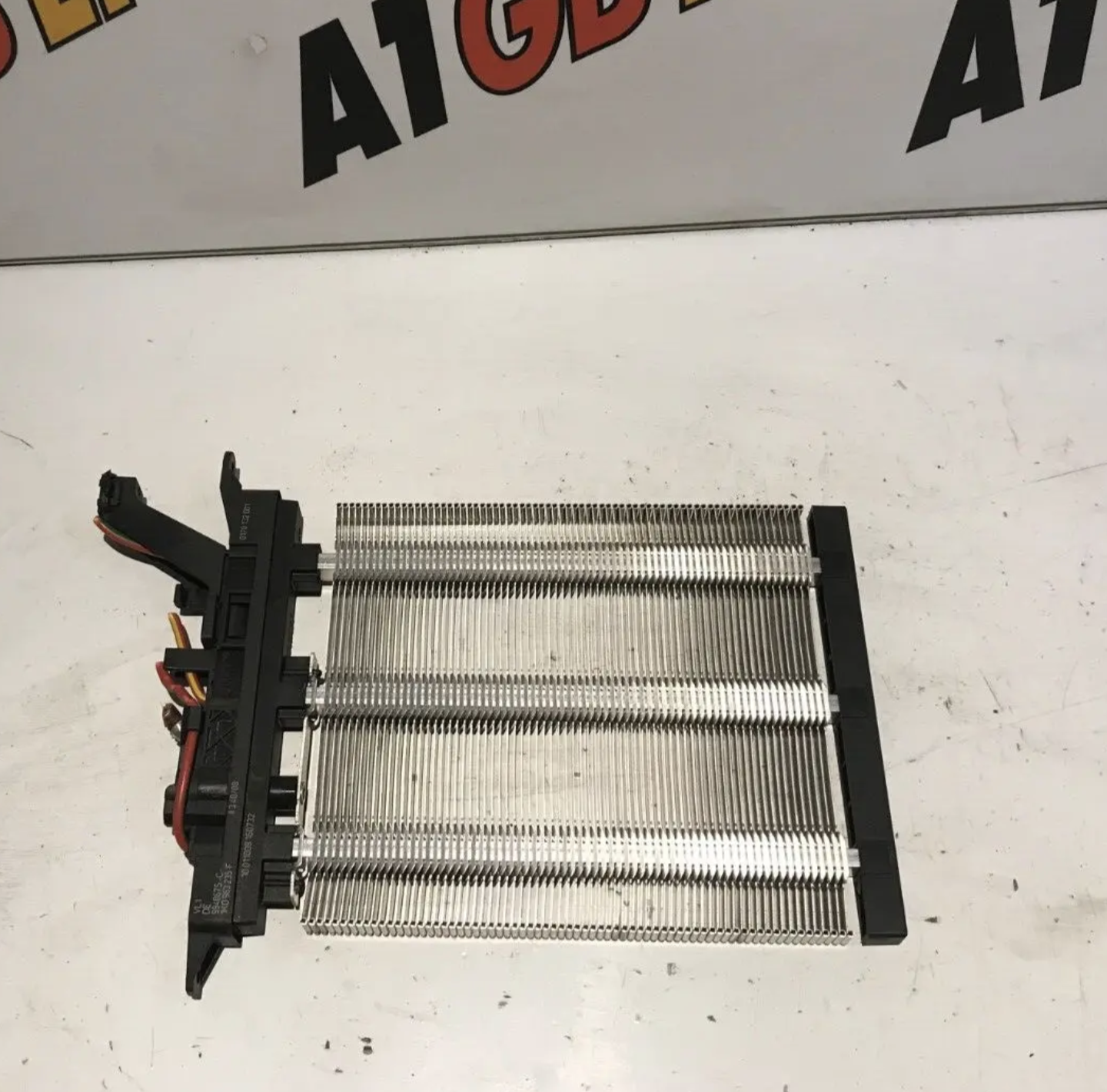

  3. Hi I would like to retro fit a aux electric heater to my 2011 MK2, part number 1K0963235F I can't seem to find the wire diagram on my workshop manual, only fuse locations and relays, but nothing on the heating element itself, I have found plenty of them on eBay, and can source all the cables and connectors. does anyone have a full circuit diagram available, or a link to any thread of people doing a retrofit, I've seen a few of the 1K0963235E but they are harder to get hold of. also has anyone ever installed one of these but bypassed the control unit, and just had an on/off switch?

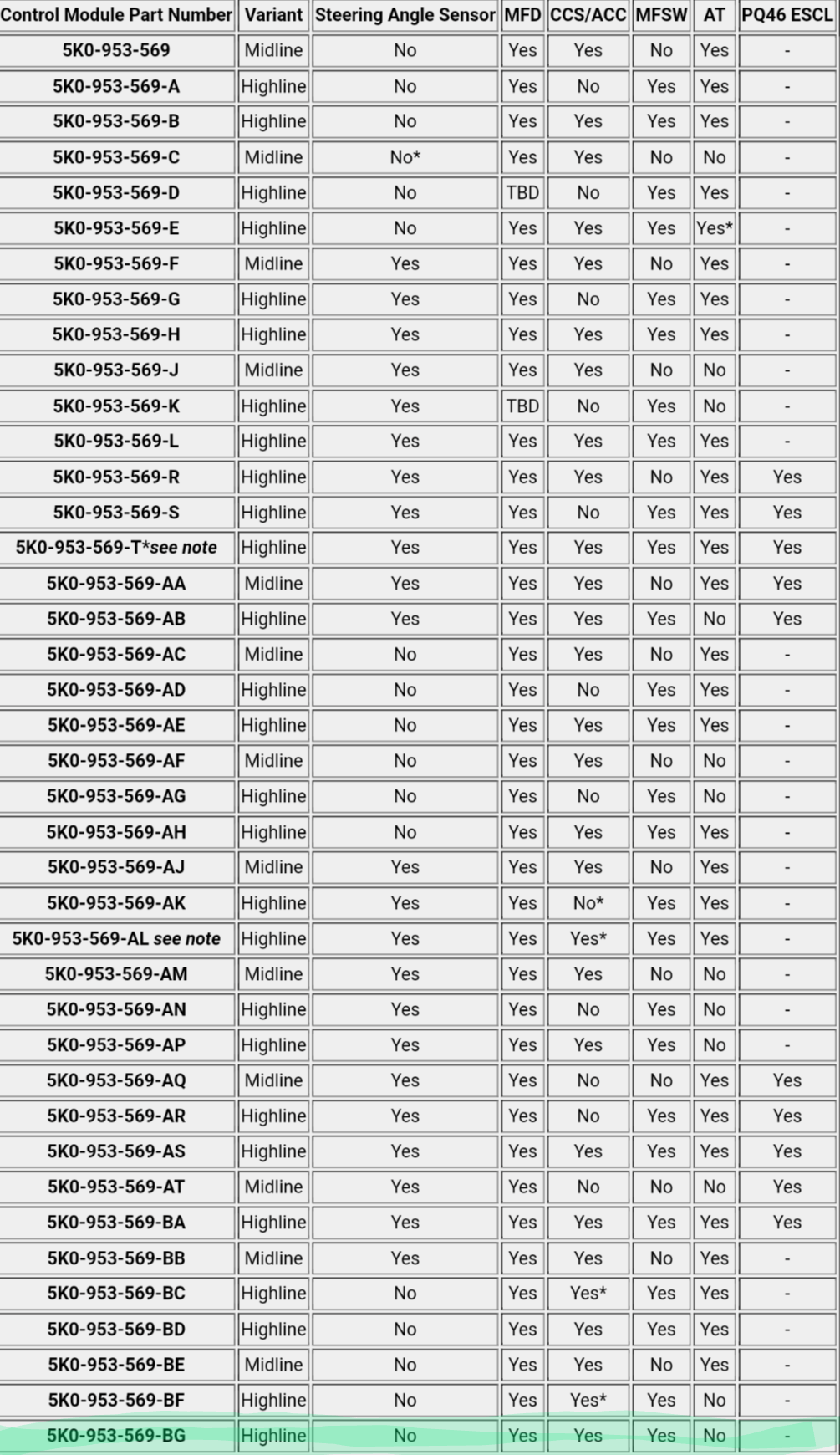

  8. Hi I got a new one with part number 5K0953569AE and it accepts cruise control and multi function steering wheel :)

  14. Hi I've just bought a steering control on eBay to work with multi function steering wheel (5K0953569BG) I've installed it but now my cruise control won't work. And the buttons to change the instruction cluster screen for temperature, mpg etc My car is a 2011 estate, does anyone know if this module is made for steering wheels that have a separate stalk for cruise, and the buttons for display on the steering wheel itself, I've coded everything to work, like the cruise by turn leaver and the board computer control via wiper lever. I'm thinking this might be a bit too advanced for my car or should I have got the 5K0953569B Thanks for any help as this has got me scratching my head :s
