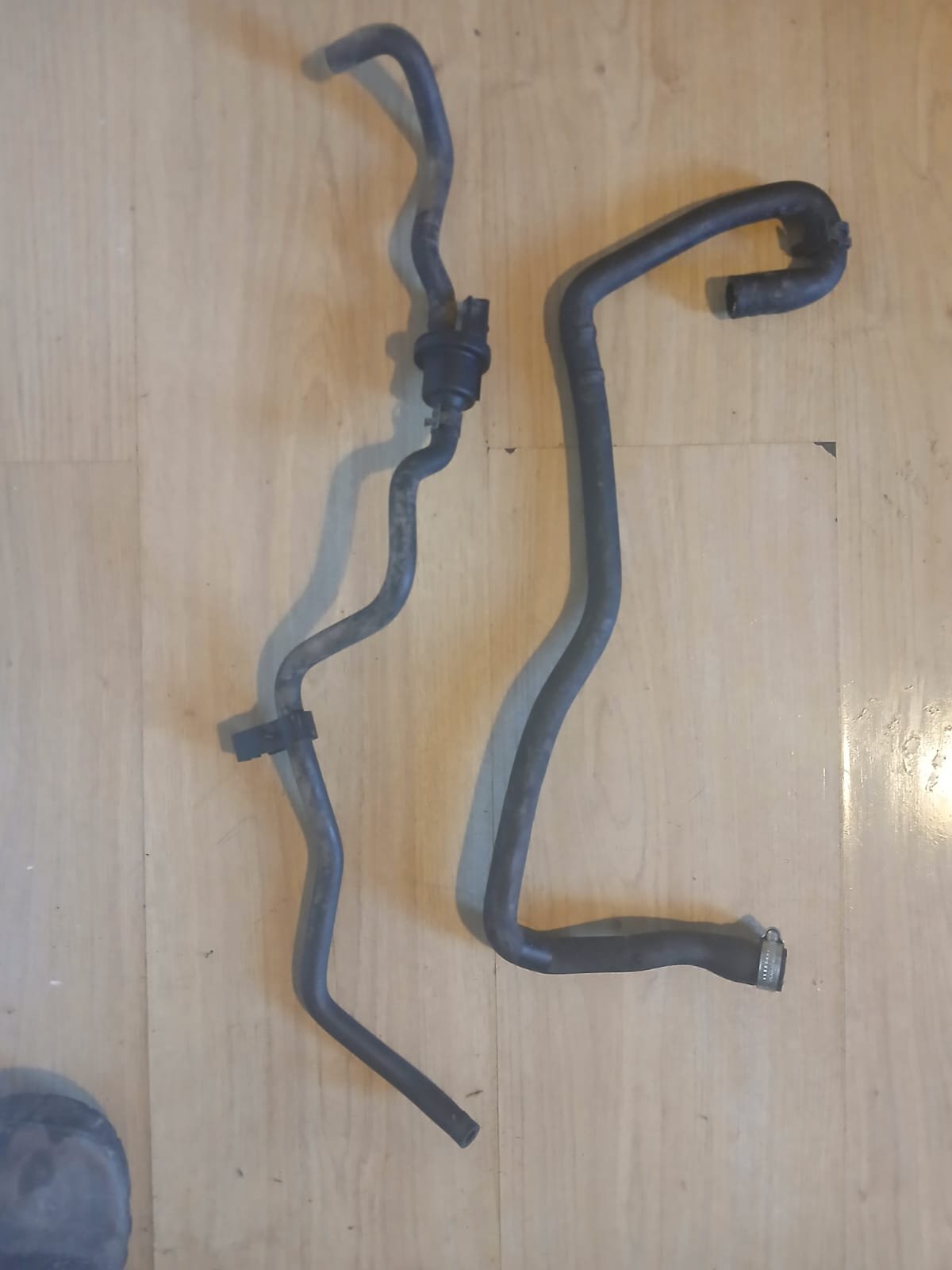

  3. more dumb newbie questions got the engine in and running and worked out where the pipes etc go on the inlet side thanks for that one but time be dammed if I can work out where the horn fits and the correct routing of the wires to the alternator and sensors on the exhaust manifold if anyone has a picture or 2 I would be eternally grateful skoda fabia mk2 1.2 12v
  4. Including results for purge valve 1.2 12 Skoda fabia location. Do you want results only for purge vlve 1.2 12 skoda fabia location? Between the vent line and the throttle This is located between the vent line and the throttle. The EVAP purge valve is located next to the coolant expansion tank, disconnect the plug and test for continuity, if the valve is open circuit then you need a new one, if not there may still be a wiring fault to the valve. Thanks Guys!! does that look like where one side connects
  5. so it connects to the manifold think I have found the eleti are all connecters different in the engine bay I have found one above the inlet manifold that it fits
  6. the pipe on the right is from the expansion tank still not worked out the other one although it fits a connection above the intake manifold
  7. panic over the bolts are offset so you can align them
