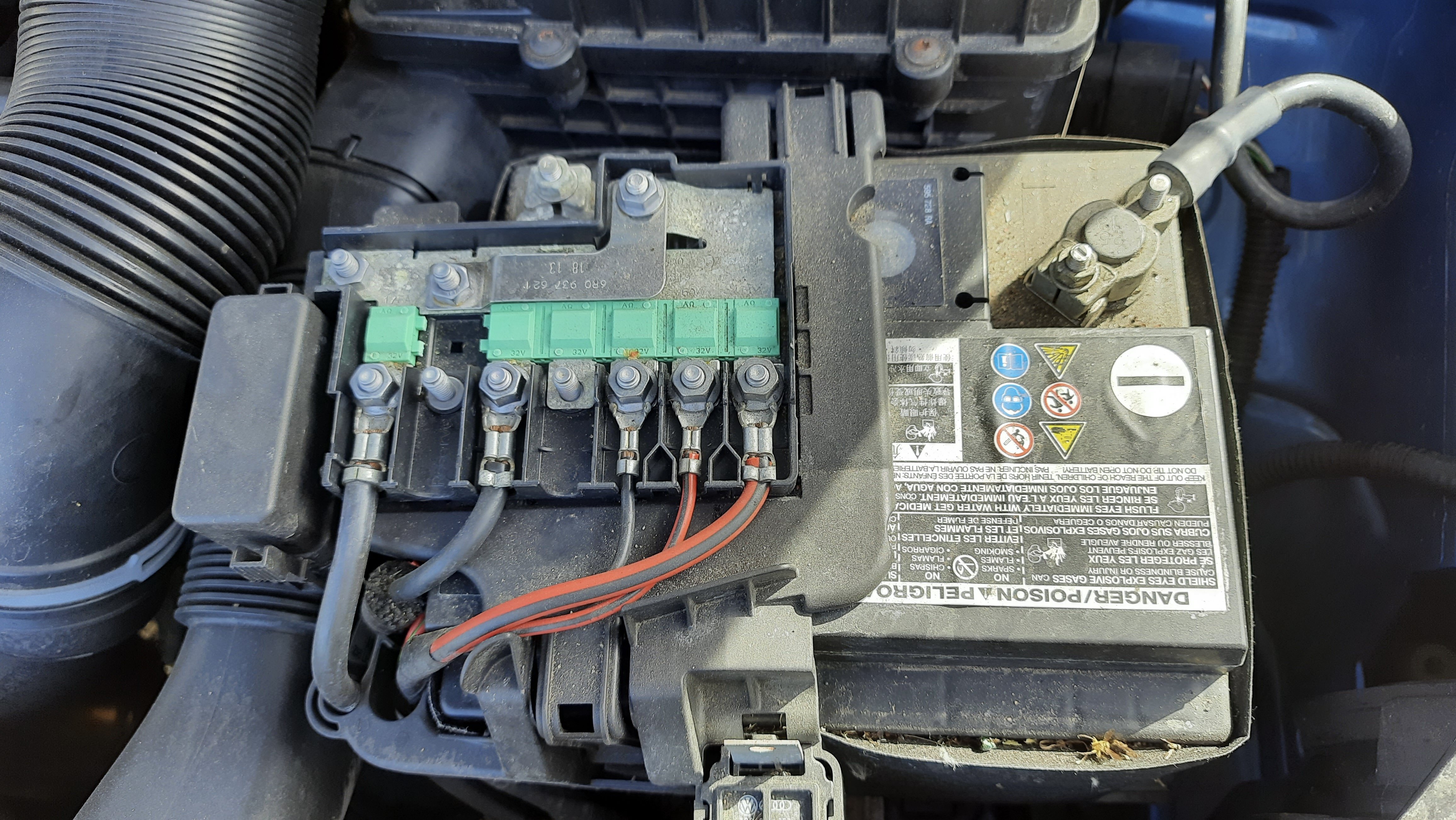

Thanks folks. A friend came over in his Landy and we jumpstarted from that…..with his engine running. So right now the Fabia is starting from cold, but who knows what tomorrow morning will bring. This morning before the Landy jumpstart my battery was offering 6v. After the jumpstart and a 20 min drive it was up to 13v when first parked up. 30 mins later it was down to 12.5v…and I didn’t have time to check it after that. So, a couple more questions: 1) Can I charge the battery on the Fabia tonight with terminals still connected? 2) We have my wife’s MX5 on the drive tomorrow and, if needed, I could jumpstart from that. But her car is worth a fair bit more than mine. So I’d like to avoid any chance of frying the electrics on hers. Obviously I have to get to the bottom of the battery drain, which is most likely the trailer/towbar electrics. But first I need to get through an office move that requires the car and trailer between tomorrow and Monday. Once that’s over I can start chasing the towbar fitter, but it may not turn out to be that.

Ok, tried using the leisure battery, but the engine wouldn’t turn over. Instead the car alarm started going off constantly (pausing for only a few seconds, before starting again). I took one battery terminal off….it still kept going. Took the other one off, and it kept going. Reconnected both terminals and on the next cycle of the alarm it stopped. Might need to get a friend to come over to jumpstart.

Went to start my mk2 2013 1.2 TSI Elegance this morning and the battery is completely dead. I haven’t used it in 2 days, but during that time I’ve had a trailer attached via a tow bar that was professionally fitted 2-3 months ago. This is the first time I’ve left anything attached to the towbar (electrically) overnight. So my suspicions are it’s the towbar wiring that has drained the battery. But that’s something I’ll have to deal with in due course. My immediate problem is I need to jumpstart the car and be somewhere. We’ve only owned the Fabia for a few months, so not had to do any jumpstarting on it before. On examining the battery I noticed this box (see photo) on the top of the battery containing five cables that attach to the positive terminal. What is this box of wires and does it have any impact on jumpstarting the car? The last thing I want to do is fry something expensive on the car’s electrics by jumpstarting in the normal manner with this box attached to the battery. Hopefully someone can provide a quick answer since I’m supposed to be somewhere this morning and obviously need to start the car ASAP. On that note I do have a fully charged leisure battery sitting in the shed. Can anyone advise whether I can use this to jumpstart the Skoda? It’s quite an expensive leisure battery, so I don’t want to damage that either. If I can’t, I’ll need to get a friend to come over so I can use their car. But that obviously takes extra time to arrange. Thanks.

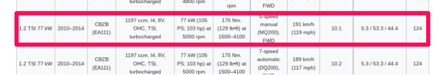

Based on the options, it can only be this one: But does that tell me if it’s a cam chain or belt? because I’m not able to tell sadly.

Hi Roottoot. All I know (being mechanically under-skilled) is I have the engine that falls in the 103-105bhp category (ie it’s not the 90bhp version). I couldn’t tell you if it has a cam chain or belt drive. Is there an easy way to find out? Where would I find that?
