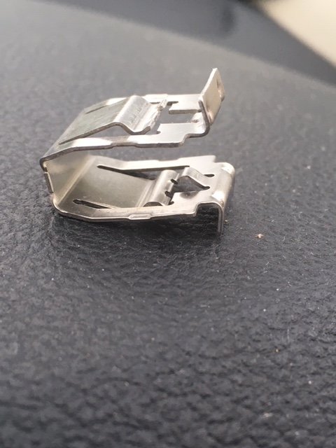

  2. Hi. What is the name of this clips. Im missing this as it’s got inside. And now i need to buy one. Anyone that knows the exact name?

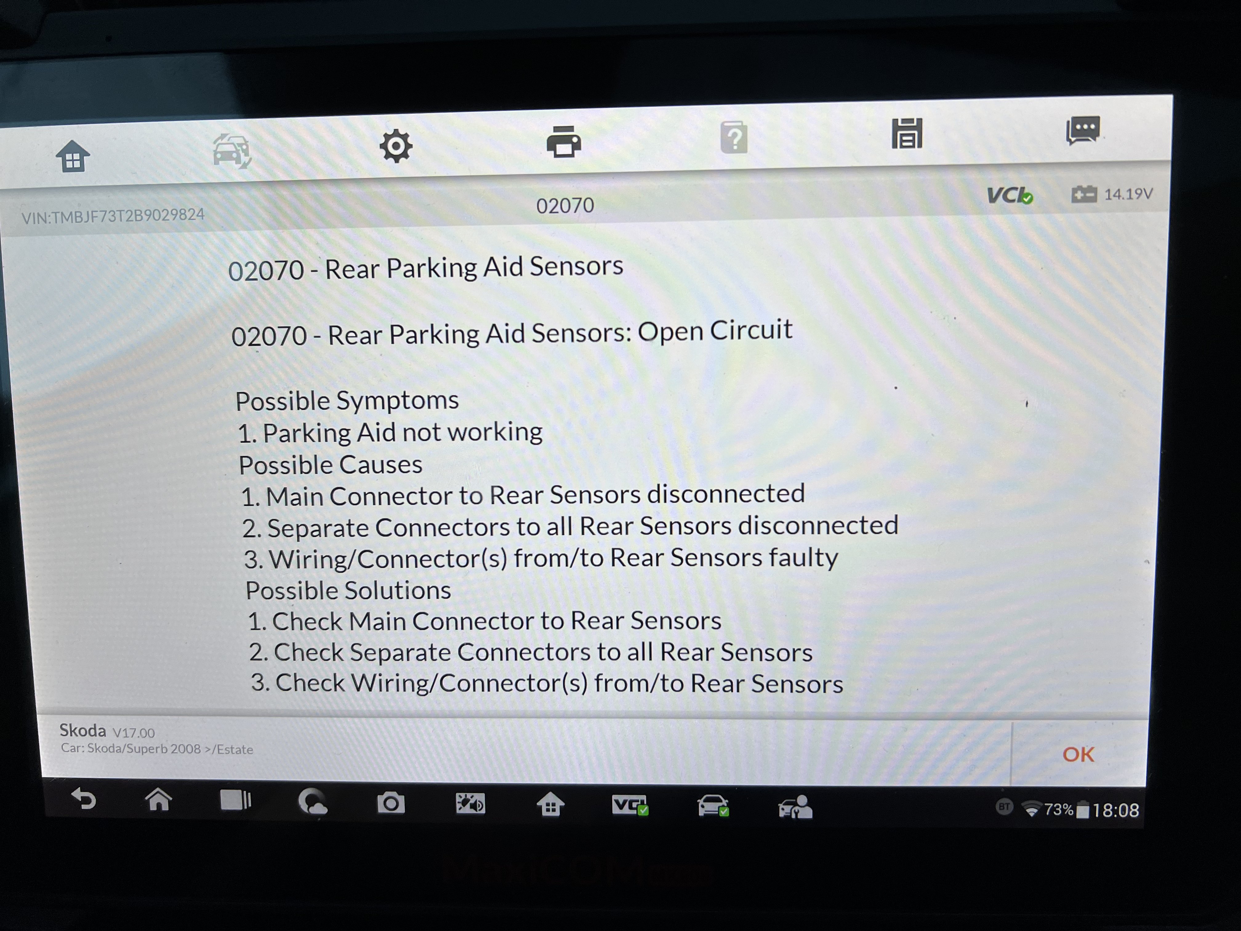

  4. Yes. I got it scan. And i already changed one sensor but doesn’t help. But now I don’t have scanner on me. I have to go to workshop next week to reset it and read the code again. But the question is: do i have to reset when I change the modul?

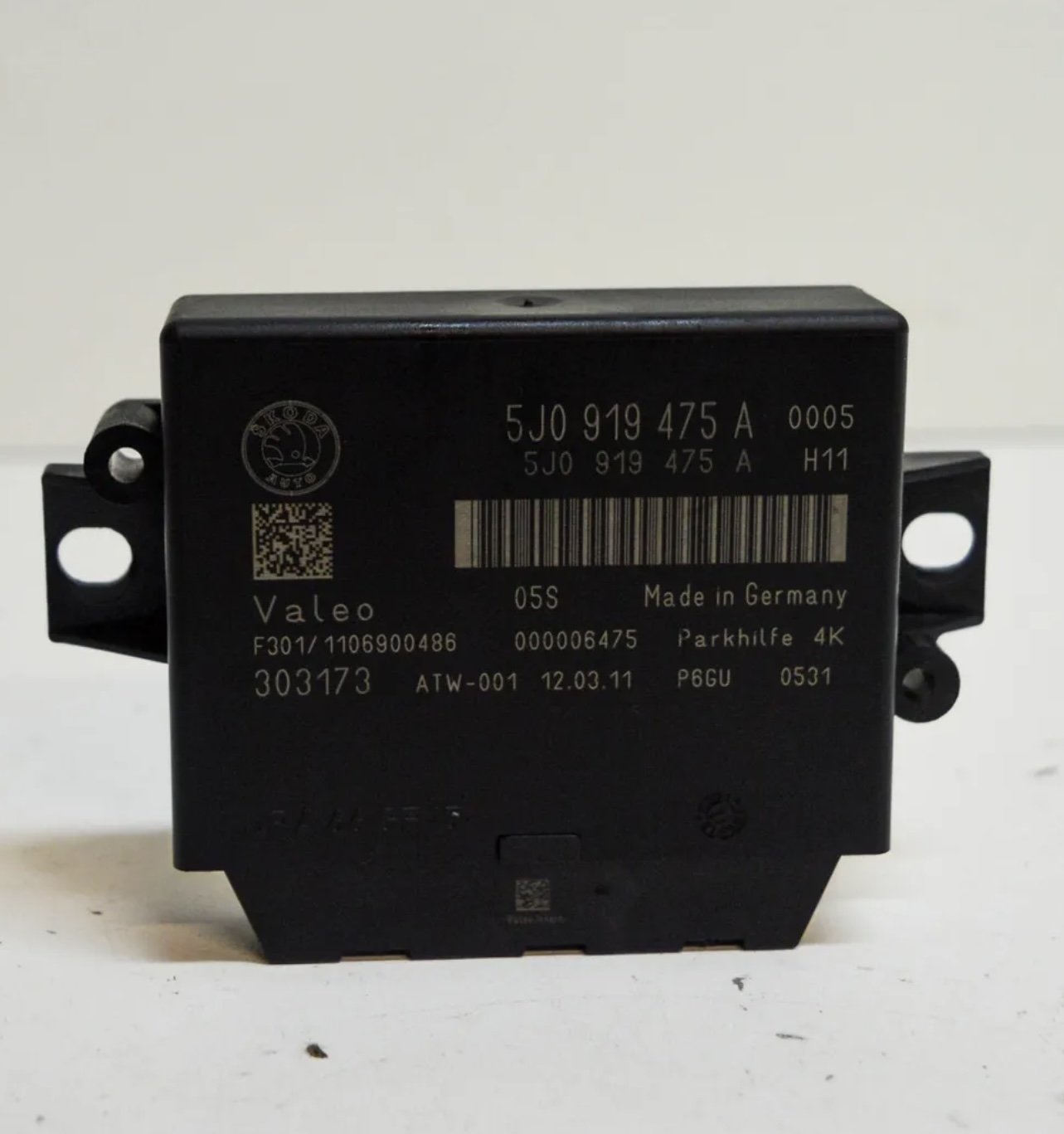

  5. I bought a new parking sensor module from Skoda and had it changed myself today. I have removed the battery and replaced it to be on the safe side. But the problem now is that it still doesn't work. there is just a long beep sound and then it goes out as before. I have not reset it with computer. Is it necessary to reset it?
  6. Thanks a lot for the video. I bought a new parking sensor module from Skoda and had it changed myself today. I have removed the battery and replaced it to be on the safe side. But the problem now is that it still doesn't work. there is just a long beep sound and then it goes out as before. I have not reset it with computer. Is it necessary to reset it?

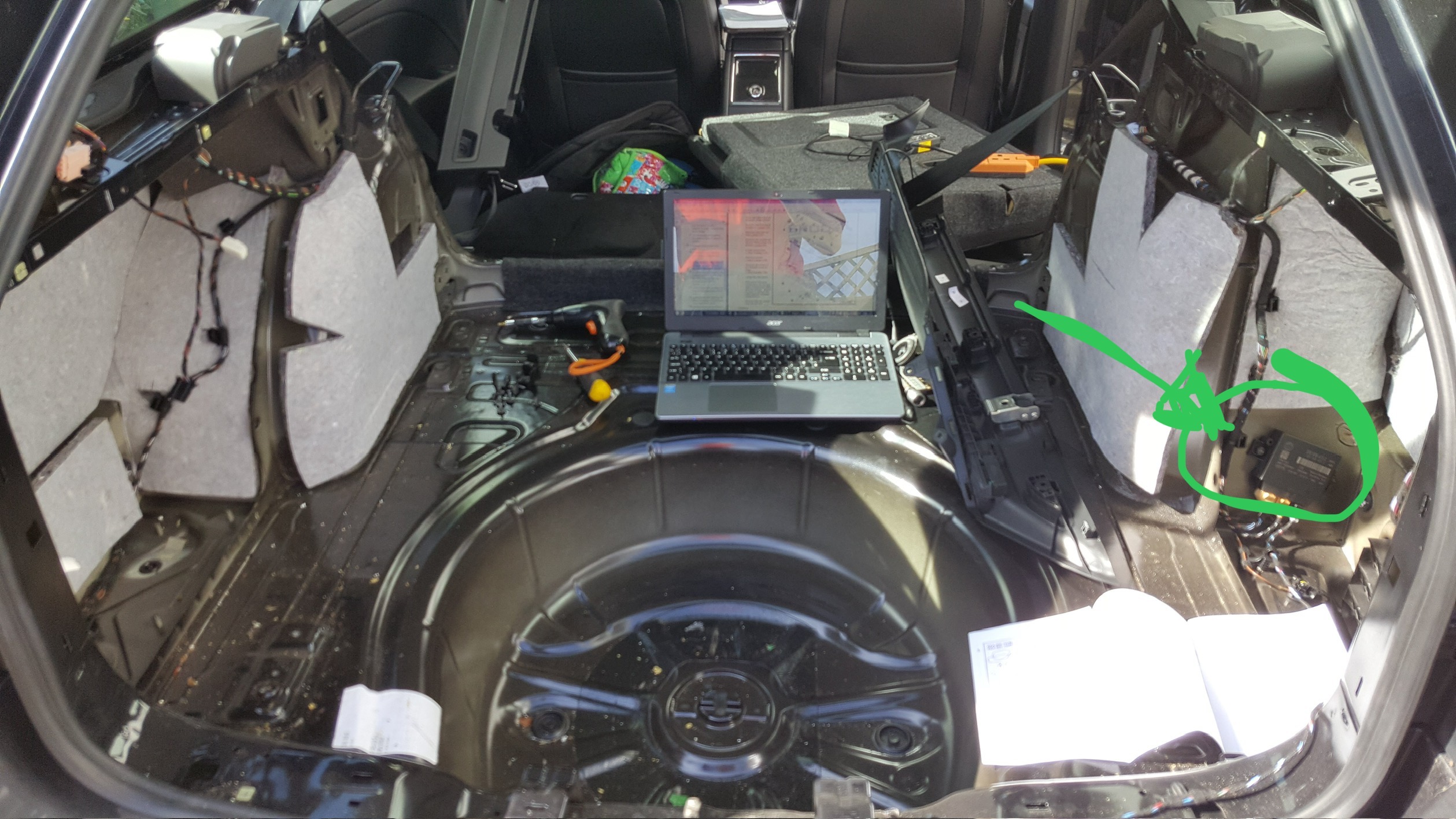

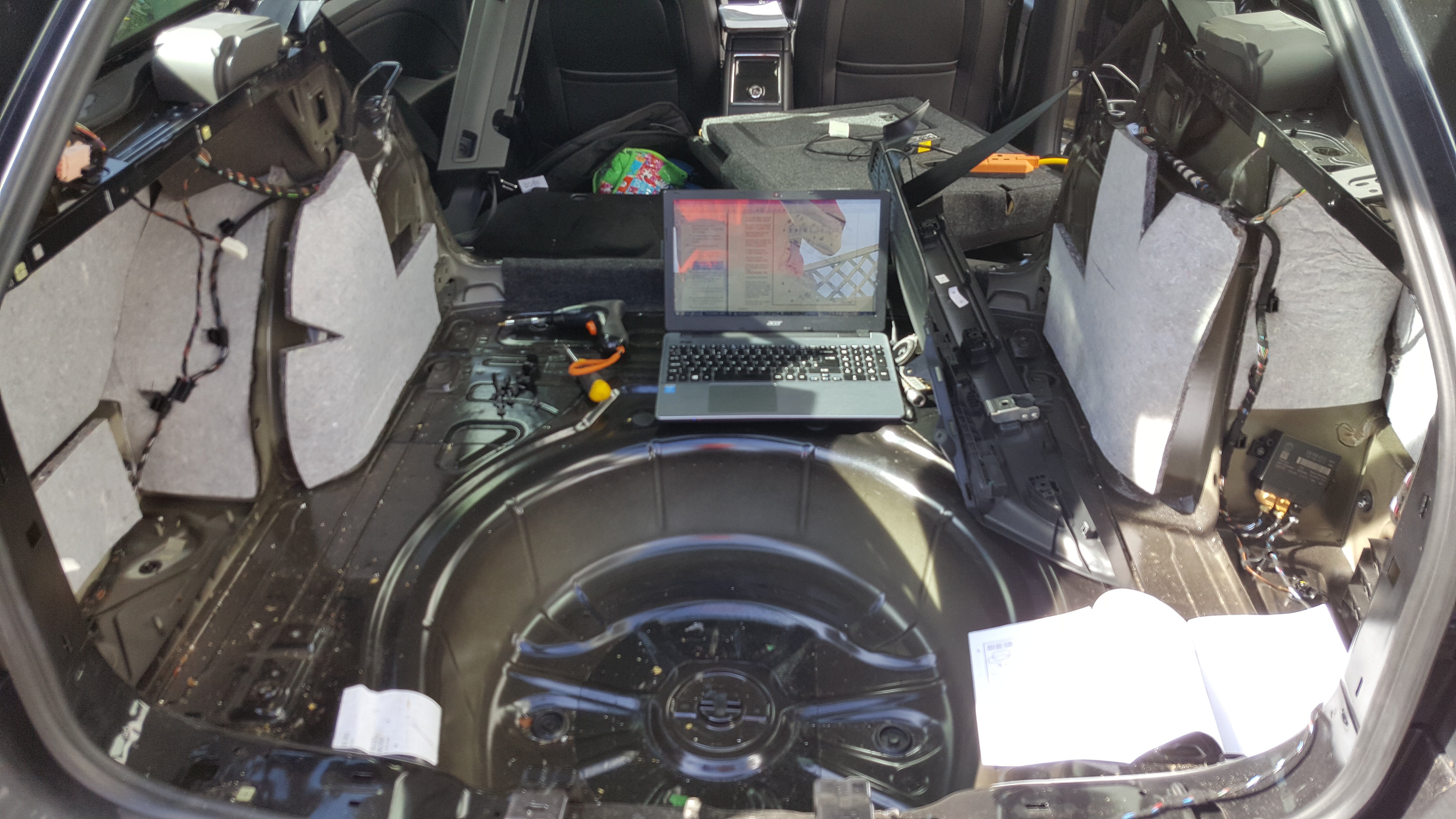

  7. my parking module for the parking sensor is highly likely to be defective. I must therefore have changed the module. I have googled myself until it is on the right as shown in the picture. Does anyone have instructions or a video on how to remove the side panel in the luggage compartment to get to the module. I can't find anything for skoda superb 2010 on video. Would like to know where the screws are located exactly.
  8. Can it be the modul. I can maybe buy the modul and c if its works. I remember my sensor stoped working after i tried to park automatically, ones i push the button its stopped working since. i found one modul at ebay. And I searched on the web for were the location is for the modul. Its at the right side as showing in the picture. I didn’t open it yet. I will do that after i getting the modul.

  14. This is the fualt. 02070 - Rear Parking Aid Sensor : open circuit
