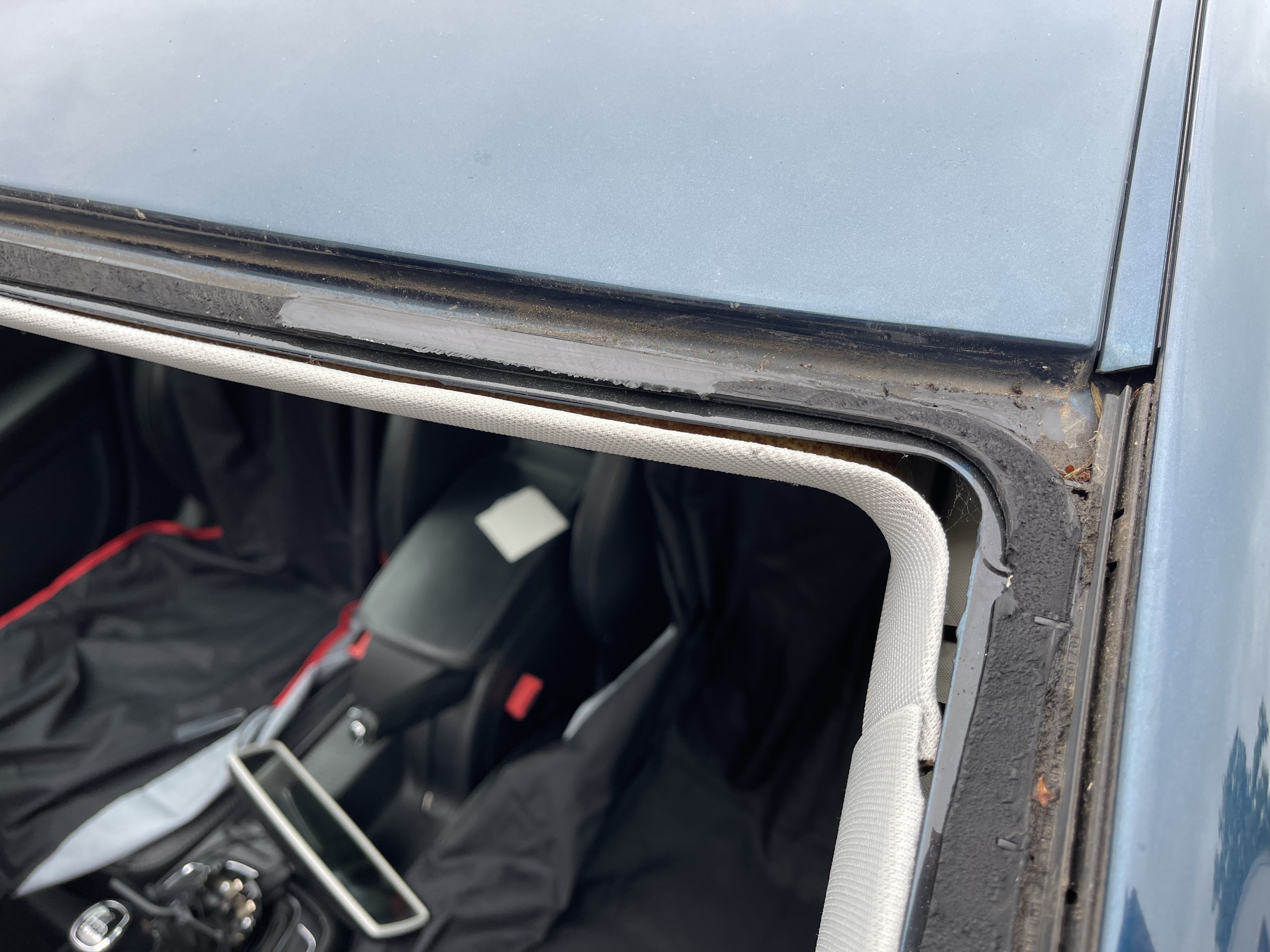

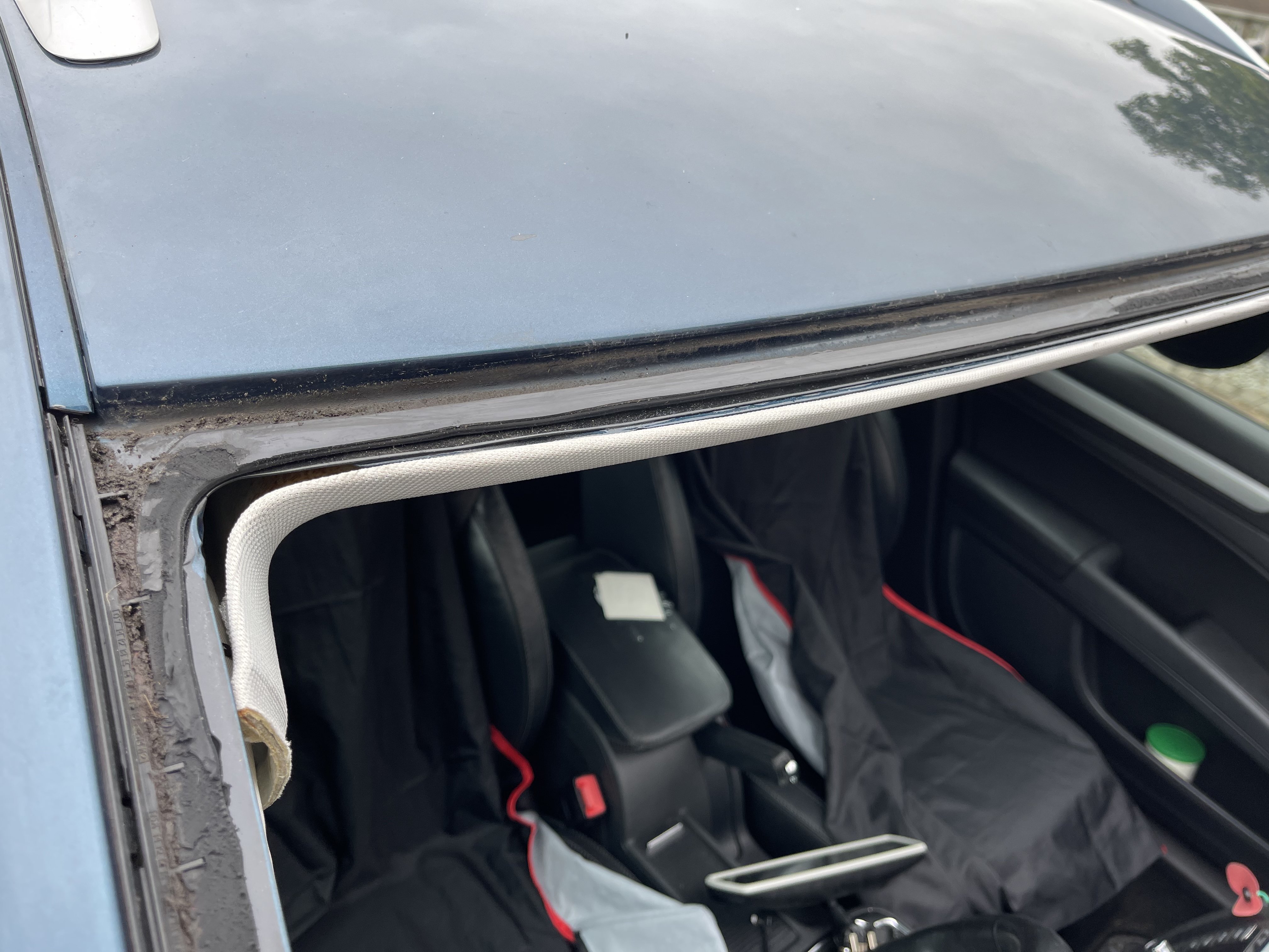

First time it rained it poured in, turned out windscreen wasn’t bonded and water was running down A post pillar trim in to dash and dripping in to foot well.
pics of where windscreen wasn’t bonded
I’ve video of it leaking in but file is to big and unsure what to do.
