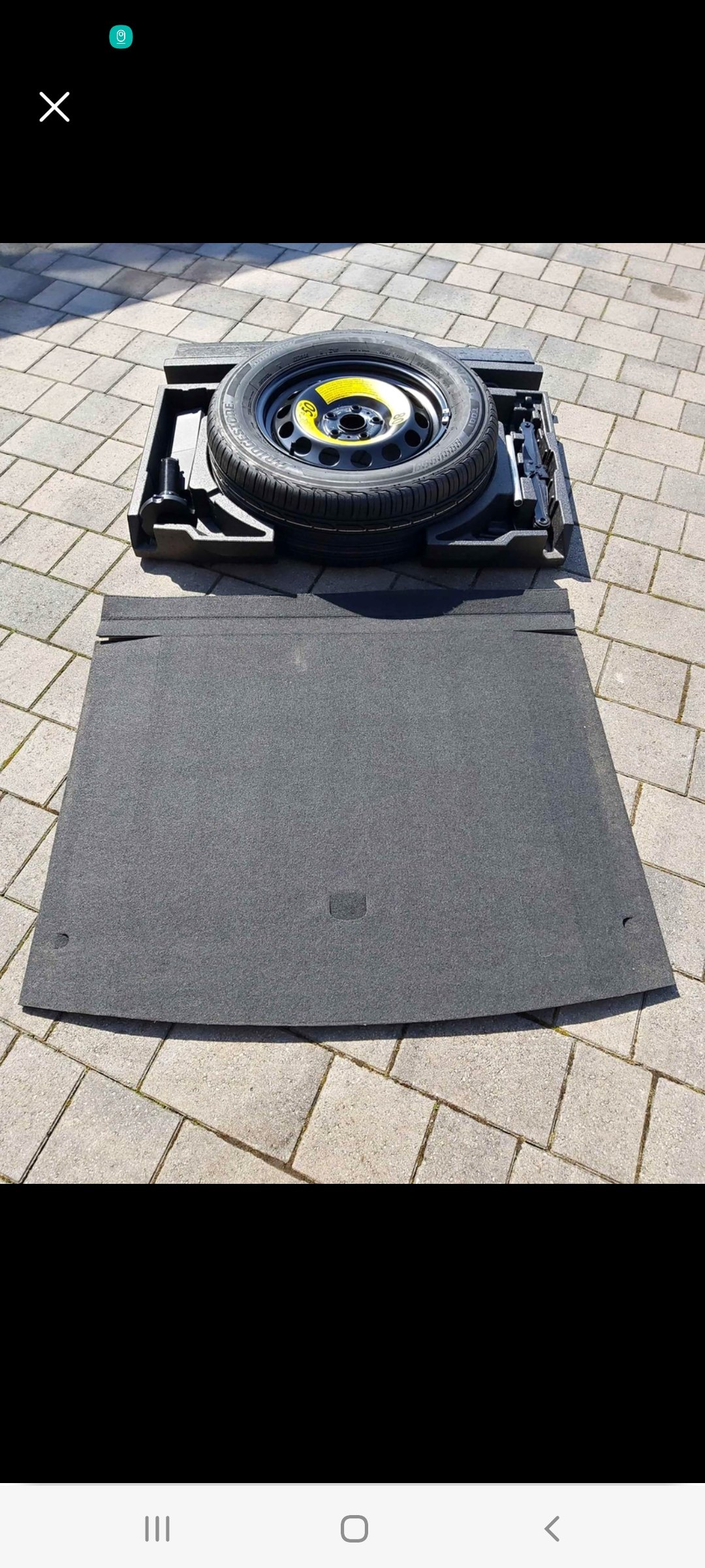

  12. Afternoon all, A local seller on FB market place is offering a Karoq spare wheel, full polystyrene surround with tools, and additional carpet for £120. The seller tells me the spare's size is 215/60 16". The size of my SE 5 spoke alloy is 215/55 17". Therefore the overall diameter difference is 3mm. Apparently the wheel lifts the height of the boot floor to more or less level with the opening. Two questions: 1. Suitable size? 2. Good value? Thanks, James

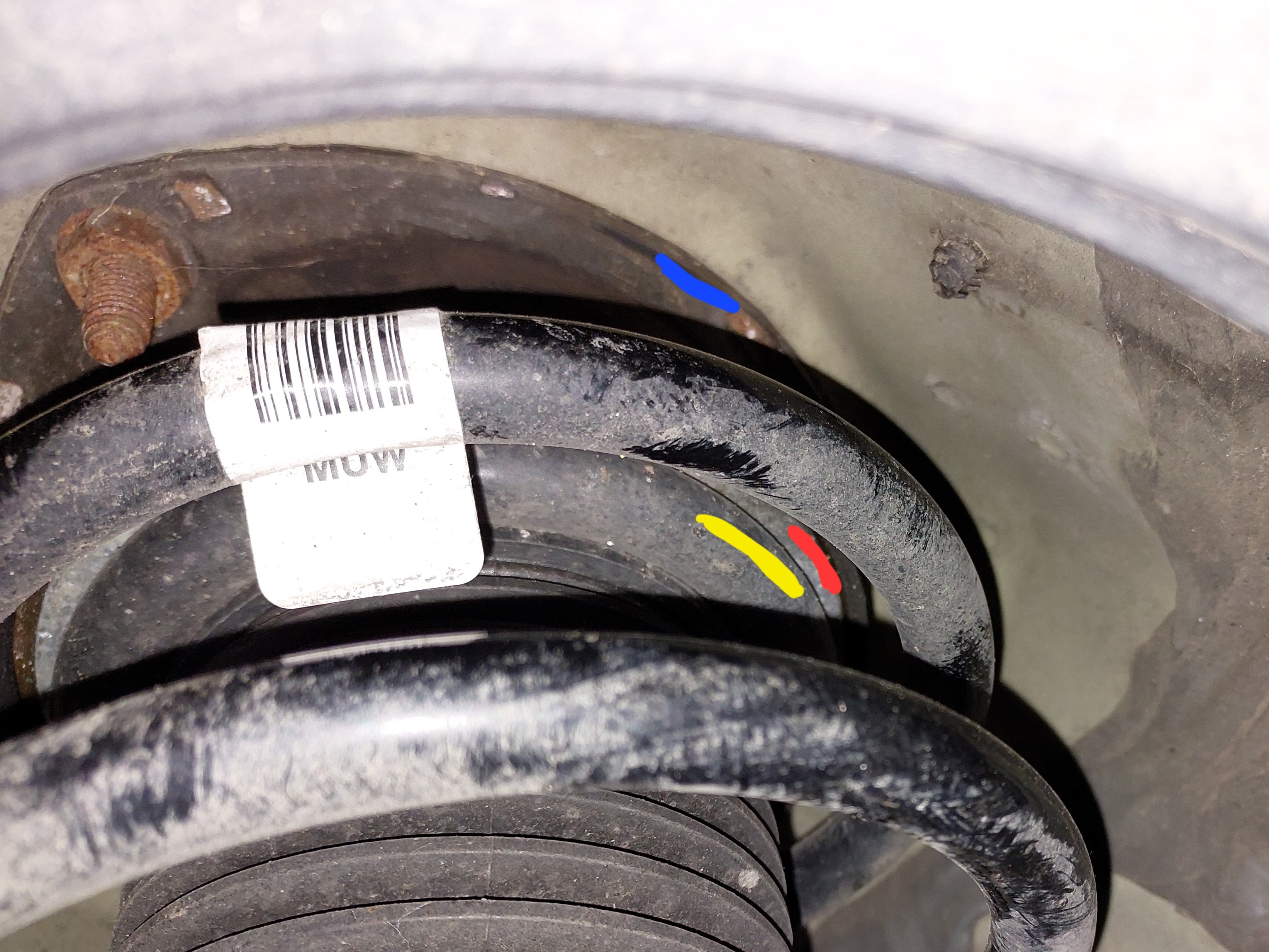

  13. Hi all, Had a go at a few things this weekend. Jacked up the driver's side at the jacking point (both sides are knocking) and let the wheel hang freely. Used a spade as a lever to lift the wheel to lift the wheel up and down from underneath. 20220611_182856_1.mp4 Can't tell if that up/down play should be there. It wasn't the shock compressing as far as I can tell. The noise from inside the cabin sounded like a thud rather than a knock but the noise could be different with the suspension unloaded. From above, it was also difficult to see any play but a thud could be heard. Above_1.mp4 JR - the bearing does rotate freely when not under load.... 20220611_183442_1_1.mp4 However, I did turn the steering wheel lock to lock (when on a hill) and heard the same knocking clear as day. ( No video). Hmmm... Local(ish) wise mechanic needed I think.

  15. Thank you JR. Where am I looking for the rubber to distort then jump round? I have no drawings so can't fully understand the assembly. Red, yellow or blue?
