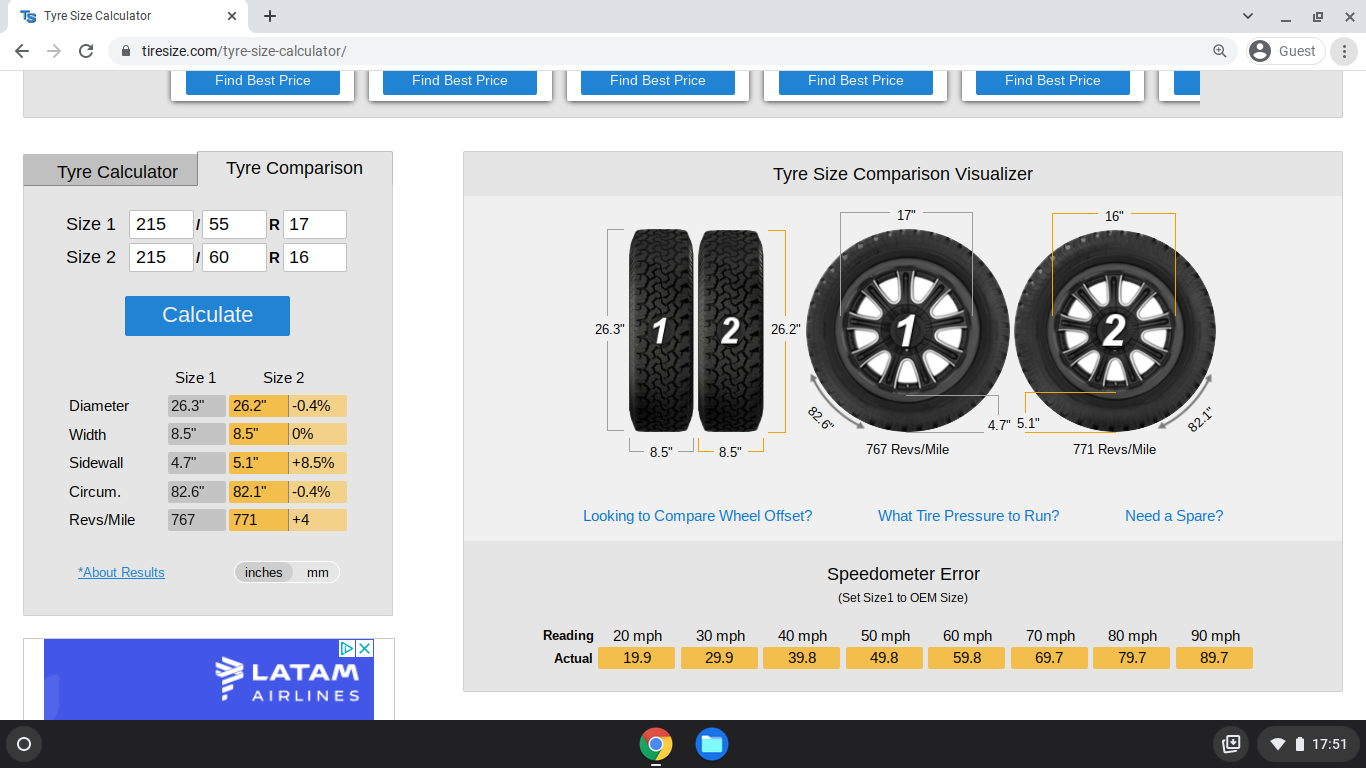

A local seller on FB market place is offering a Karoq spare wheel, full polystyrene surround with tools, and additional carpet for £120.
The seller tells me the spare's size is 215/60 16".
The size of my SE 5 spoke alloy is 215/55 17".
Therefore the overall diameter difference is 3mm.

Sounds like a good price.
Size is fine for a temporary spare but you still need to reduce your speed if fitted with an odd one out tyre / tread / compound and wheel.
If your boot was full and you needed to fit the spare you would be putting in the spare tyre well the wheel that came off so as well to have a full size spare carried.
