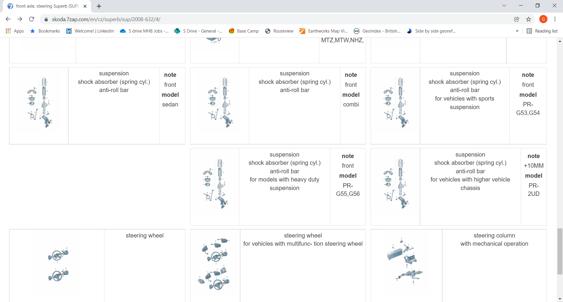

Thanks Carlston. Mine is the above to it must be 3C0411105C but i will check the build code today. This is something i totally forgot. many thanks

Hi, looking for some help in identifying the part number for my 2009 superb 2TDI 140BHP. i need to replace both front coil springs and i had a look on ETKA to find the part number but seem to get confused with the various models and letters thrown at me... any help in decoding this for me is highly appreciated...
