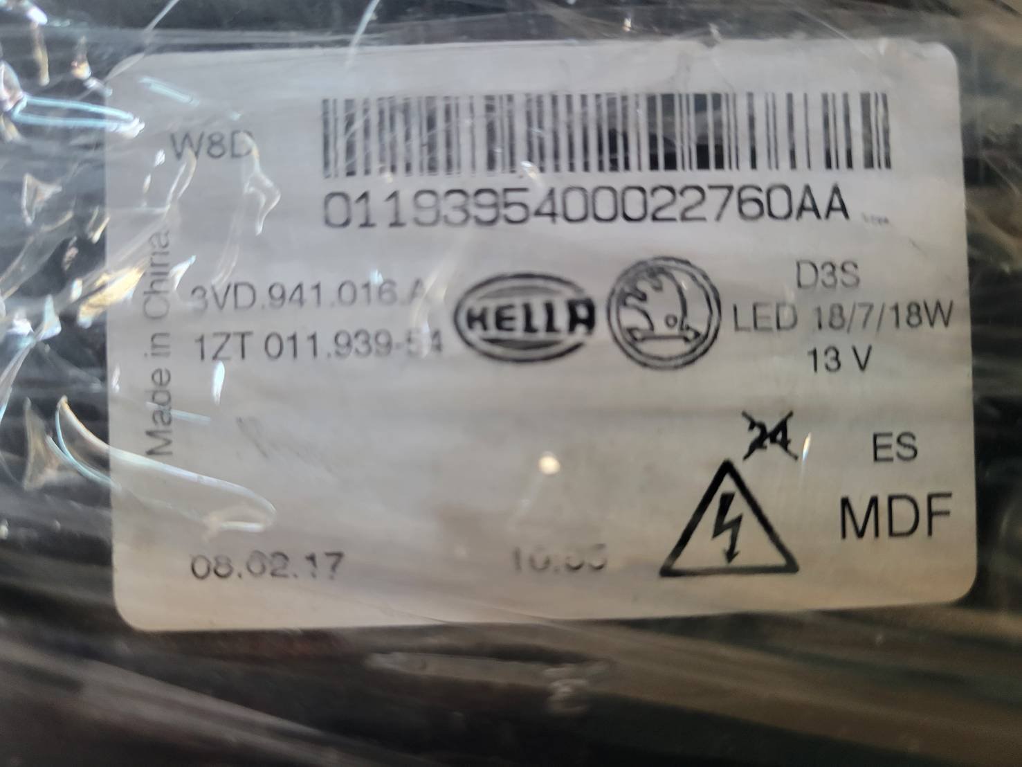

  1. But my current 3V1 headlight right DRL is no longer lit, so I just bought this set of 3VD headlights to replace OK! At present, it seems that there should be little difference in the functions of these two sets of headlights. I will find time to replace them and test them later. Thank you JR RS and ApertureS

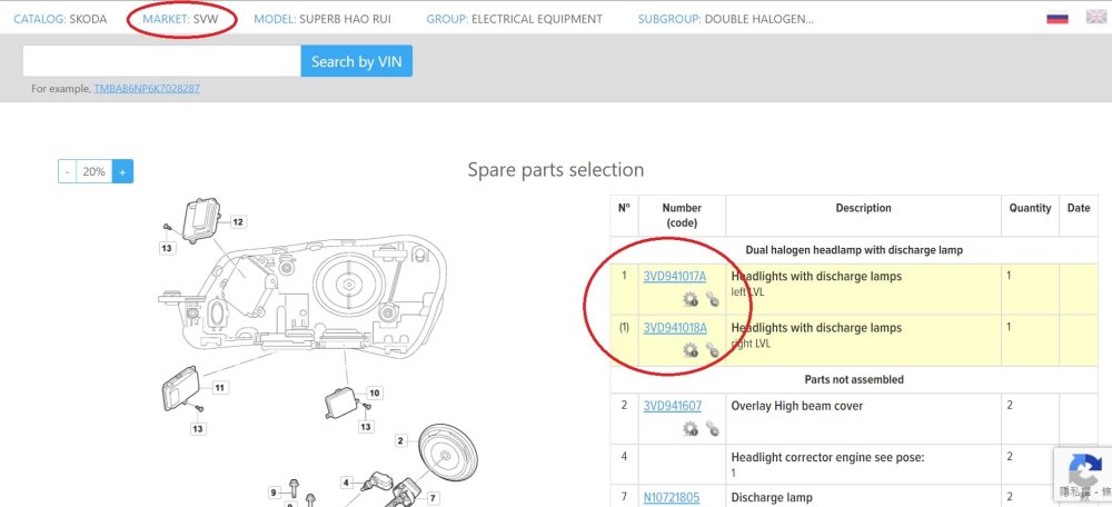

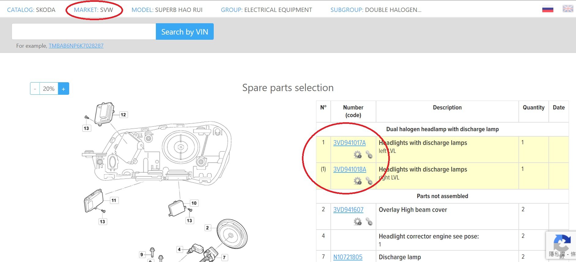

  2. 3VD is the China SKODA version ,not CZ SKODA version http://www.ilcats.ru/skoda/?function=getParts&market=SVW&model=SUPC&modelcode=881&year=2016&group=9&subgroup=941&part=941020

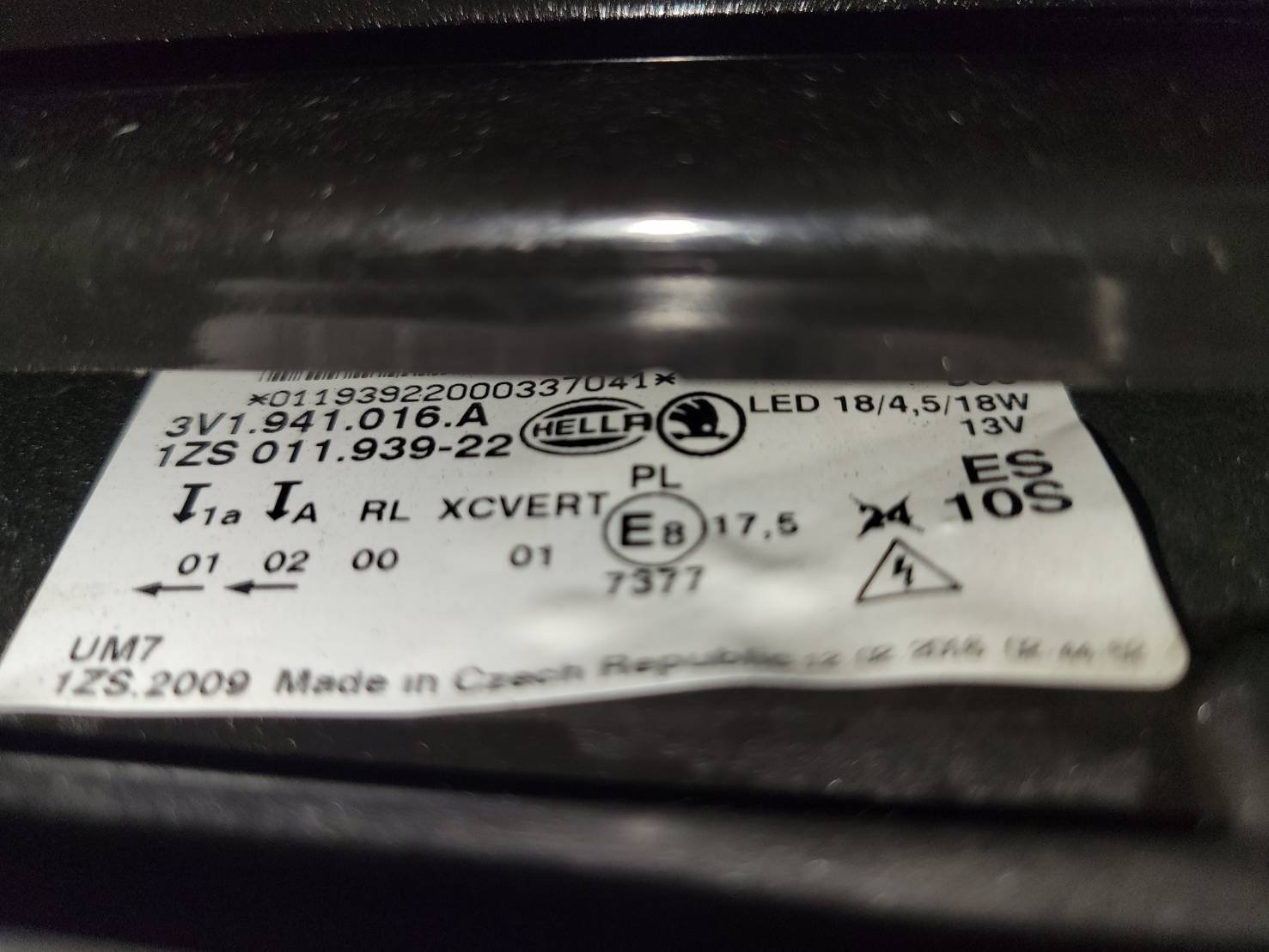

  3. Hi, @JR RS 3VD941016A is the headlight of the China SKODA version. It is a Bi-xenon with afs function, the same as the original headlights (non-SLA version A) on your car,and the module configuration is also the same. My 3V1941016A Bi-xenon headlight doesn't have afs function, it also doesn't need to set afs slave modules (like 8U0941329) I just want to change the headlights on the original car from Bi-xenon without afs function to Bi-xenon with afs function, Just like your original headlight function. I don't want to upgrade to version B headlights with SLA function.

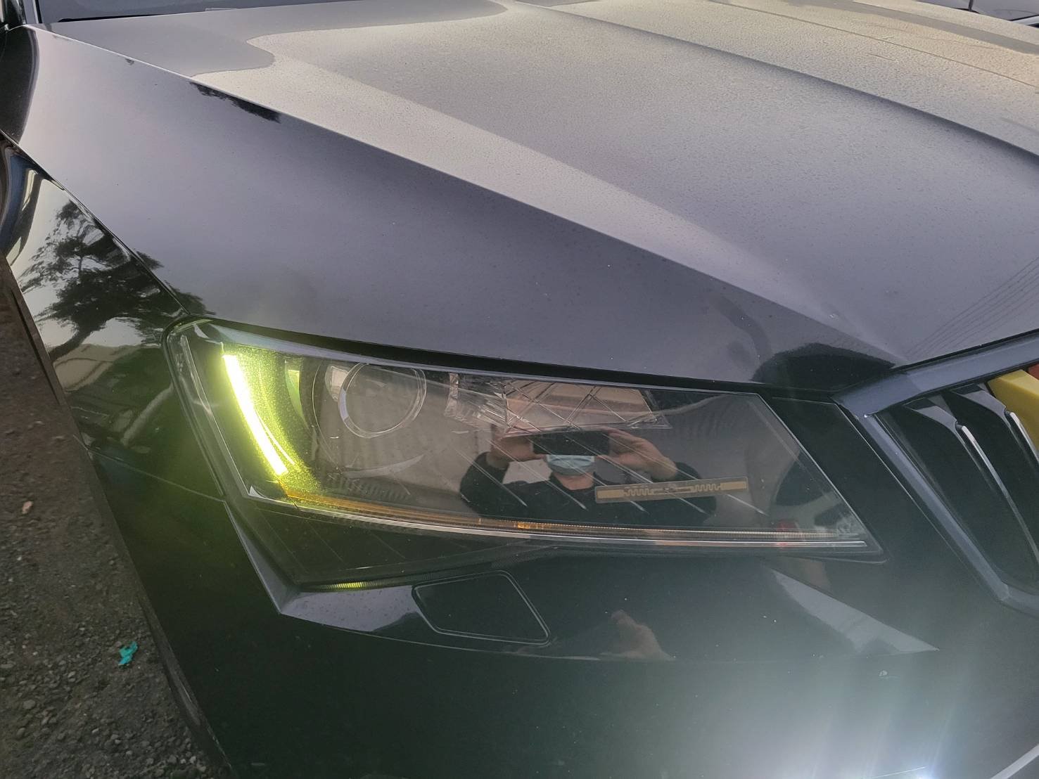

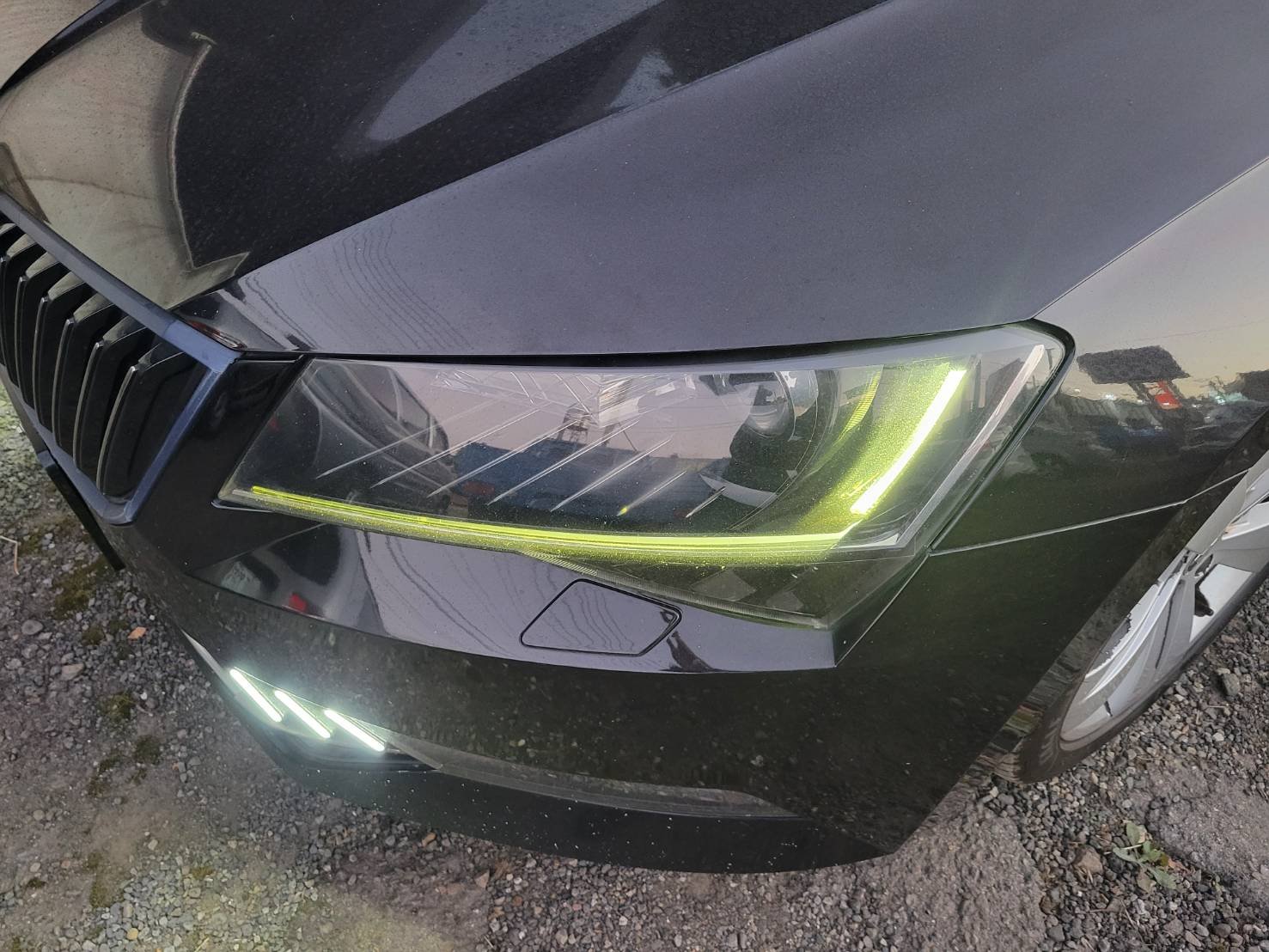

  5. Hi , @JR RS I am a car owner from Taiwan and my 2016 Superb 1.4TSI is equipped with bi-xenon with DRL setup headlights (3V1941016A), now the right DRL does not work, I bought a set of bi-xenon with DRL & AFS headlights (3VD941016A) including AFS Slave modules (8U0941329) should be replaced What kind of function opening or encoding setting do I need to use VCDS for after changing it? Could you help me to give me advice?Thanks
