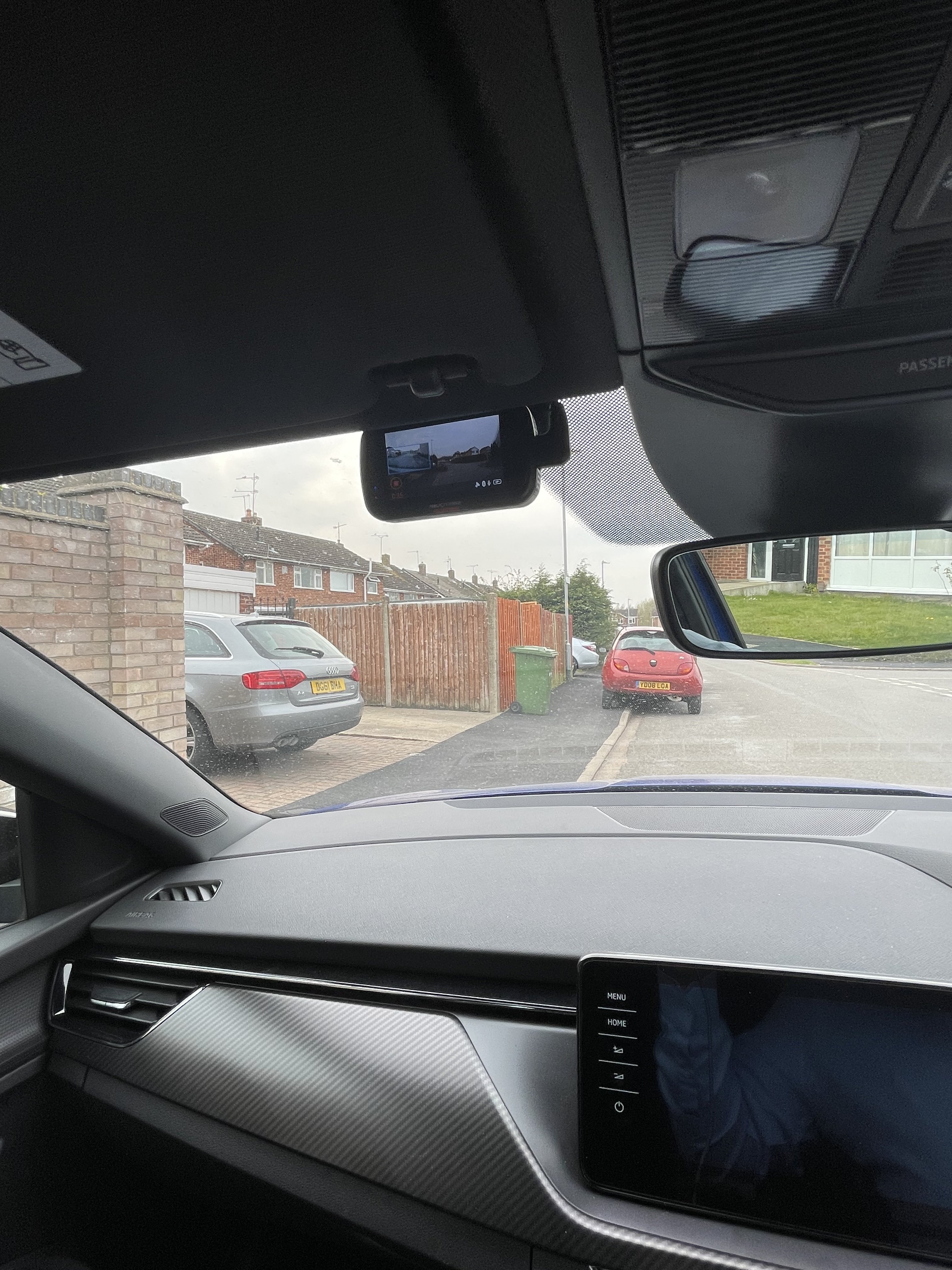

  2. No worries, USB is an option and this car is leased. Not paying for things for other people!!
  3. Not the best photo sorry. Fortunately I’ve done a few and rarely break anything these days! Biggest problem is trying to avoid airbags on modern cars. I also struggled to find a switched 12v, all the large fuses are permanent, looks like the micro2 are the ones I need, unfortunately that’s the one that Nextbase don’t include as standard. Quick phone call and they are sending one free of charge, just have to remember to disconnect it every evening until I can switch it out.
  4. Yesterday was a good day! Front Dashcam fitted, rear one almost done, just got to route the cable through the tailgate rubber boot. I've forgotten how much I hate trying to loosen trim on new cars!
