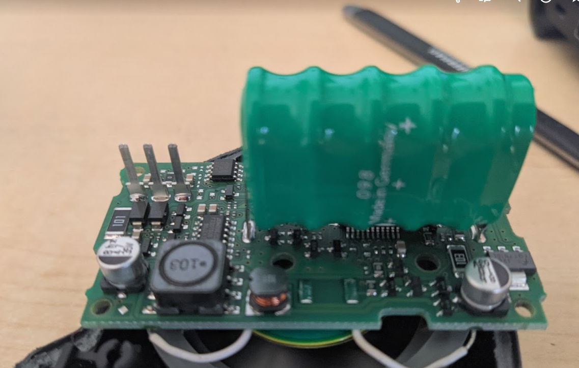

  11. this sounds like its falling off, can here it rolling about inside ๐Ÿ˜
  12. scappers is off to swap it, if they said they didnt want it back, Id happily open it up myself lol If battery on one I took off the car was leaking it was going to replace it, but voltage is still holding over 6v and looks fine So only thing i could guess which maybe causing fault is the 3 capacitors, which i could swap, but thats just guessing ๐Ÿ˜ž
  13. guessing I got a fault unit from scrappers, fitted it, when alarm triggered flashing lights but no siren ๐Ÿ˜ž I dont believe the unit needs coding or anything else? strange thig was the unit had a rattle, like a SMD component was loose in side

  18. See i'd go for faulty wiring to LED, but its the fact one time it worked again when alarm was armed, but the car hadnt moved, id not opened the door. But i did read somewhere the LED changed how it lights up or doesnt if theres a fault on system. then theres the error code suggesting its that horn unit which the batteries are only meant to last 5 years, cars from 2009, I was suprised they`d not leaked tbh
  19. did you ever measure the battery voltage before replacing, mines showing 6.98v, but error code is Alarm Horn -h12 01134
  20. So after taking the unit appart theres no signs of leakage Measured the voltage and this showed 6.98v So is it lekely to be the bat or not?
  21. Cheers My thoughts are take unit off, and put arch liner and wheel back on, and not have a alarm for a week or so Then open the unit up, see which battery is in it (as there appears to be 2 sorts) and state of PCB then if its worth repairing to go down this route, and fit back, if its not then order one from Alliexpress etc, and fit this when it arrives
