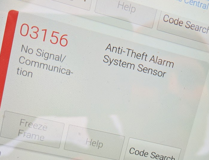

  3. the scanner came up with shows the below
  4. Ok ebay said the other part number i think thats for the plastic cover its 1z0951171 its the ultrasonic alarm sensor one of these https://www.ebay.co.uk/itm/293811201582?hash=item446883262e:g:NGoAAOSwB4Zfn~hK&amdata=enc%3AAQAHAAAAoKrT%2BAek%2FnIlF%2BPGAlAUQDosTq5r%2Fpc9bTP9bq8p3wFj72aZrwLecv8P5Ui8wqnh4PqoWVoxsq1nA4rhH3%2BitRCCx09ptZElHA91HdJGvXcrzkEYJQ%2FxC%2BnlODuxJrbbJlWdBh%2FJdiDCqagP4FVbHdFL6BzbGeV2PMomDW%2Fas1b5VtNe6W6Vr9Iejco9wkXl%2FYxwrFkHKDDv5tqH8%2BZhyu4%3D|tkp%3ABk9SR8j9ycCjYQ

  6. So im getting the error 03156 which the internet doesnt bring much up for, found one that states is this sensor which i believe is part number 1Z0877829B Does this need to be coded to car as odd add on ebay says might need coding, or is it a straight swap?

  10. got replacement, thats fixed the error on the alarm horn, onto next now ๐Ÿ˜ž
