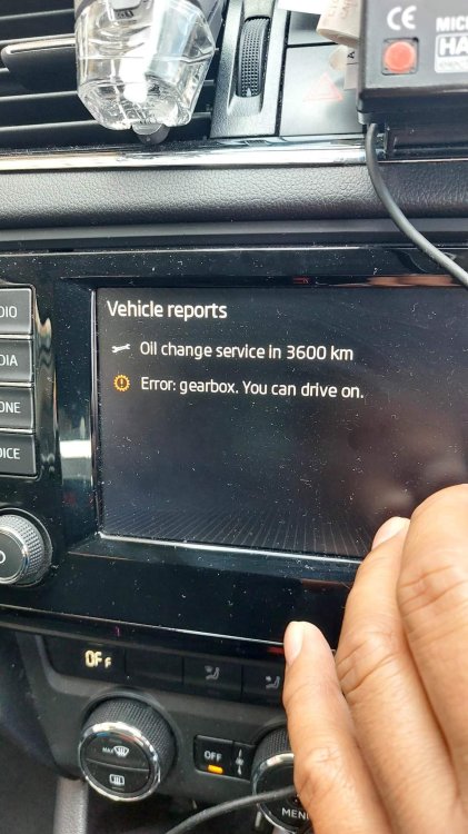

error: Gearbox. You can drive on
hi rot. would you be able to check my car registration if does require oil change? and if it is dry clutch, why did they change it? 171 kk 570, registered in Ireland!
hi roottoot! the garage did an adaptive drive sng found nothingπ
I insisted to get it changed at 90k kms since they didn't advice when it was first serviced when I bought it 53k. diesel 1.6
Hi guys! can someone tell me if it's ok to continue driving the can if it's showing this notice in the dashboard. but when you switch off the car and turn it On, it would disappear. this shows 5times or less since the gear oil was charged. I have skoda octavia 2017 dsg7 automatic
