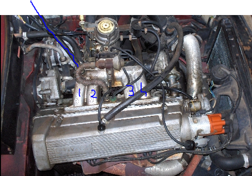

Hi Pete, It comes off at the corner where Nr1 cyl is connected: Marked in blue. This picture is not my car, it's off Wikipedia, but it's the same model, Engine, B201, with the single Pierburg carb. Do you suppose there's a leak around the vacuum line...? Why not? I pulled it out quite easily last time i fiddled around the alternator... And now i see that on this picture under the EGR, that hose connection is made to the valve cover... That's a weird thing. On mine it's blanked off. Warrior193, I'm sorry, the LPG bit was about my Felicia, not the car in question. OFF of the OFF topic: For starting with petrol, it's absolutely right. Over the years i had 5 cars on LPG (it's very popular here) and on the carburetted ones we used just a manual electric switch that would close off the petrol line and open the LPG line. You started on petrol, then switched your ON-OFF-ON switch to OFF, waited till the petrol went low in the carb then turned to LPG and off you went saving the globe. On the injected cars it's all automatic. It starts automatically on petrol then switches to LPG once the coolant is about 40 degrees. I never would have thought that LPG was available in New Zealand... I thought guys down under either drive V8 pickup trucks and SUVs or Japanese key trucks. (I own a Suzuki carry as well)
