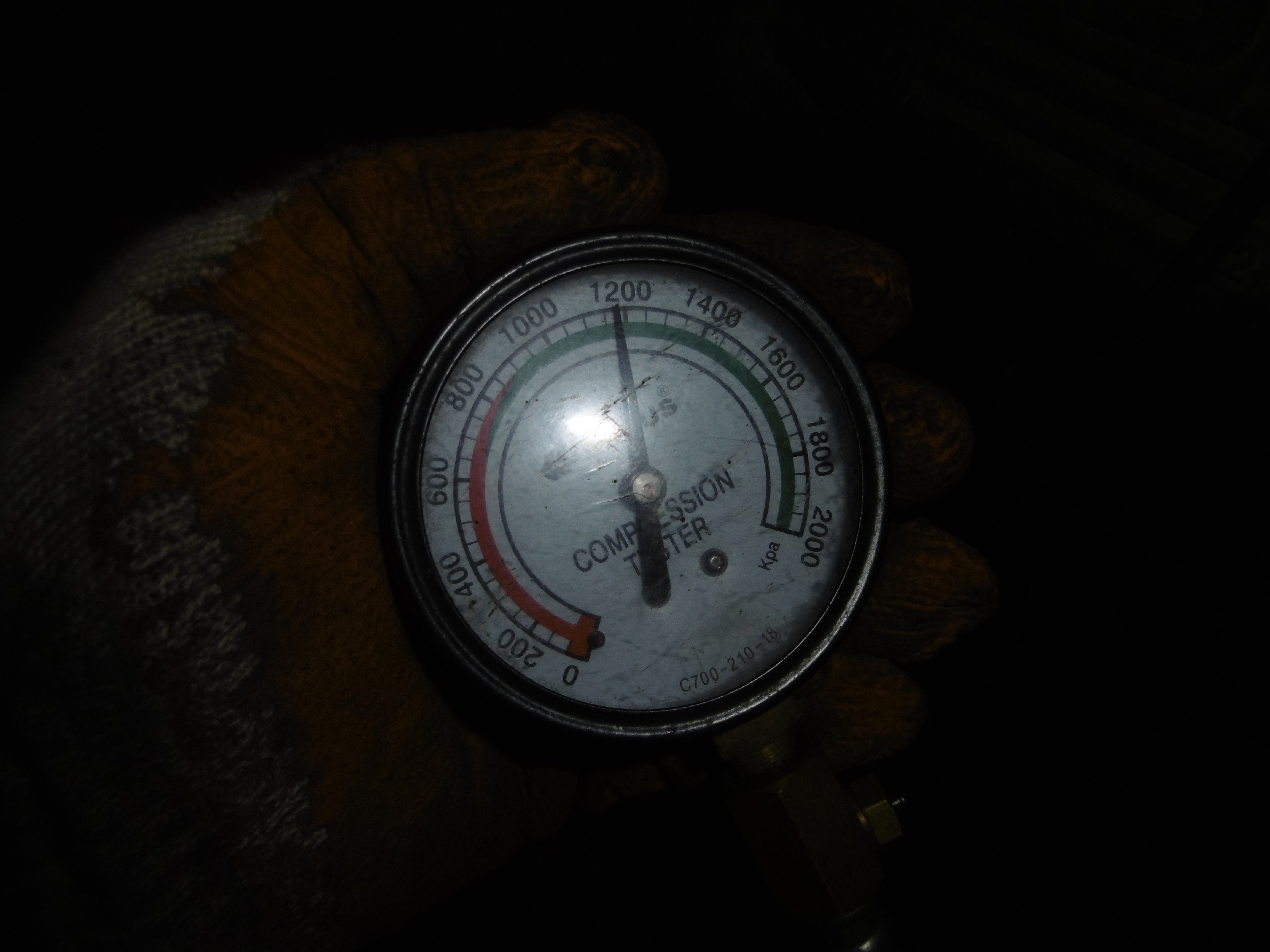

Sorry for not coming back at this earlier, I looked for that info, but found not much. There's compression ratio that's 9.2 I think. I repeated the compression test for a warmed up engine and it's all neat, Nr1-to Nr4, all in the region of 1000-1050 kpa, that's about 150psi. I'm happy with that. Weird is, that it was almost exactly the same when i did the test cold. And Nr4 cylinder showed much higher. I wonder why. And I wonder why i did not repeat the test on Nr4 back then after a weird value. I guess I'm forgetting all that i learned in engineering. Car starts fine now on all 4 cylinders. So I expected the color-coding of the plugs to be sorted but it's not. The outer 2 cylinders are still black / dark grey, inner cylinders are white on the plugs.... But... my carb is probably wildly out of spec So I'll do that in the coming weeks and see what happens. It's definitely too rich, as there's a plug right on top of the engine side flange (exactly where the carb for suzuki carry has idle mixture screw) that looks like... well, idle mixture screw. As I started to turn that out it started to idle higher and higher, so I'm guessing it needs some extra air. I do not remember my last settings, but i recall that i kept adjusting fuel level and whatnot. Best is to remove it, and see if everything is up to spec. I have several different manuals now, thanks to Ricardo, I only need a free afternoon.

Great! Saved them all into the Saab folder on my machine! Thanks a lot! I owe you a big cerveza. Yesterday I also blanked off the EGR and did a compression test while at it. Nr1: 1025kpa Nr2: 1010kpa Nr3: 1025kpa Nr4: 1180kpa As Nr4 was black and wet if i recall correctly now i wonder if it has some oil leak from valve stem for example that would boost the test results. Otherwise decent. Test was on cold engine of course, all components present, but wide open throttle, I gave each cylinders about 5 compression strokes with the starter.
