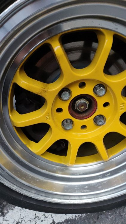

  2. Hey Its the brake upgrade from this forum with ford calipers and hyundai discs thats the only good pic i have..the rest dont show more detail than that. are you interested in any detail in particular? thanks for your help and advice guys

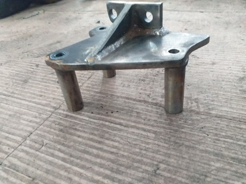

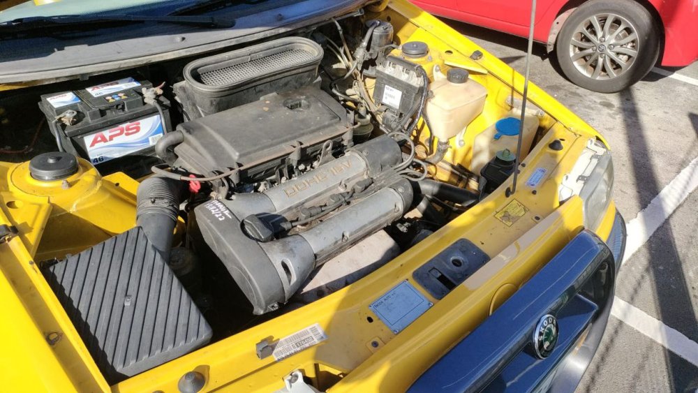

  5. hey guys! Finally done Still got a long way to go to get the car perfect but were getting there! engine and brakes are in, next some minor things to fix such as a proper job of insulating the windscreen and all the locks and starter key thing needs fixing too. then ill refurbish the suspension and lower it slightly (30mm) here are some pics. We built the engine mount different than on the original post to keep the belt cover intact.. also didnt need to change the radiator spot because of it.

  8. Hey guys! I will post when its in the road. I dont think ill be able to find a 1.3 box since no cars were sold in portugal with that engine I think. Im going for the sleeper look under the bonnet with the original cover if i can manage to put it there and the original air filter box since i didnt find the one from the AFH and I already have a KN filter on mine (the air here is pretty clean so no worries about that filter) Thanks for your help and opinions.. Ill be sure to keep you guys posted
