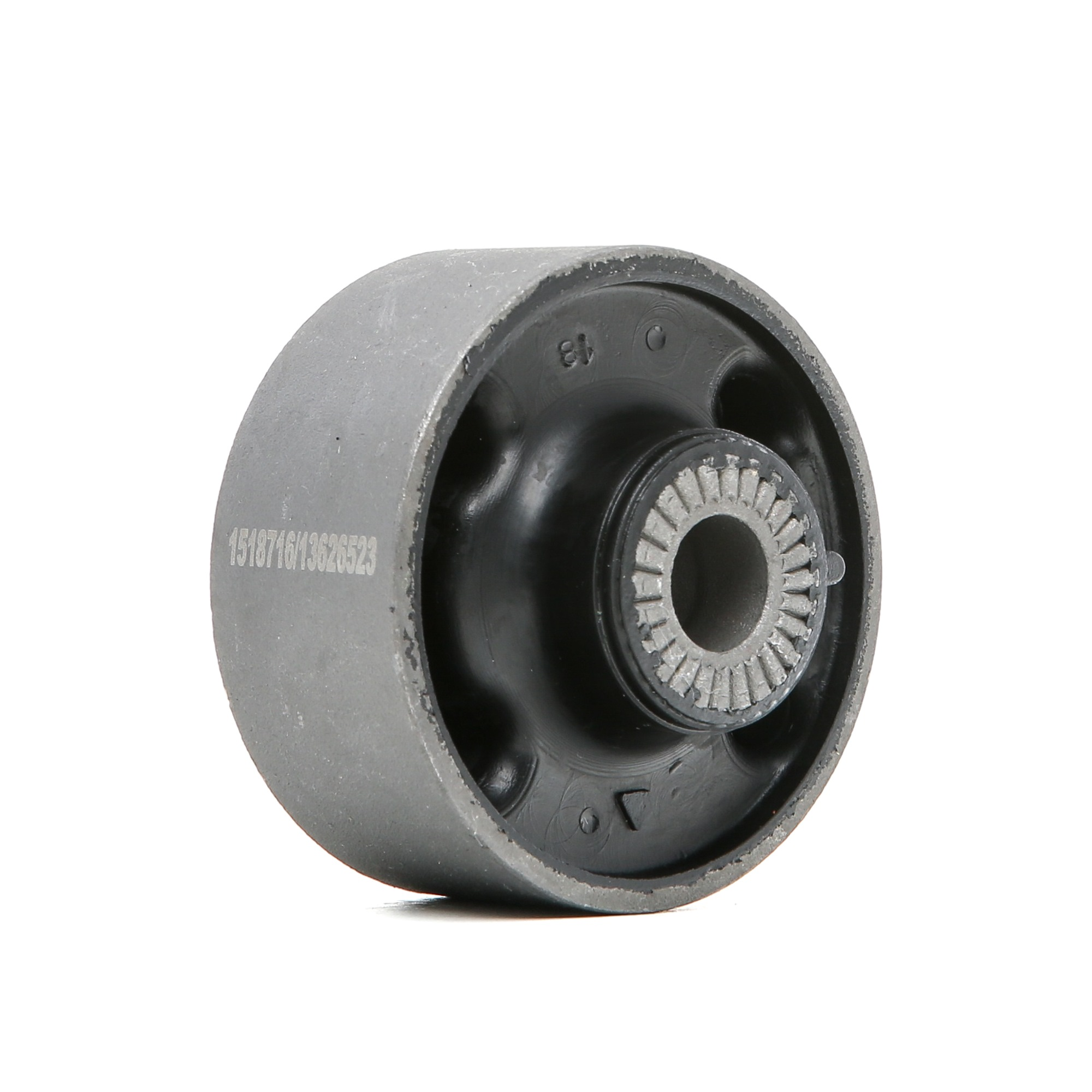

This is coming from front control arms. This thing cracks:
Edited by candasm
5Q0407183F
