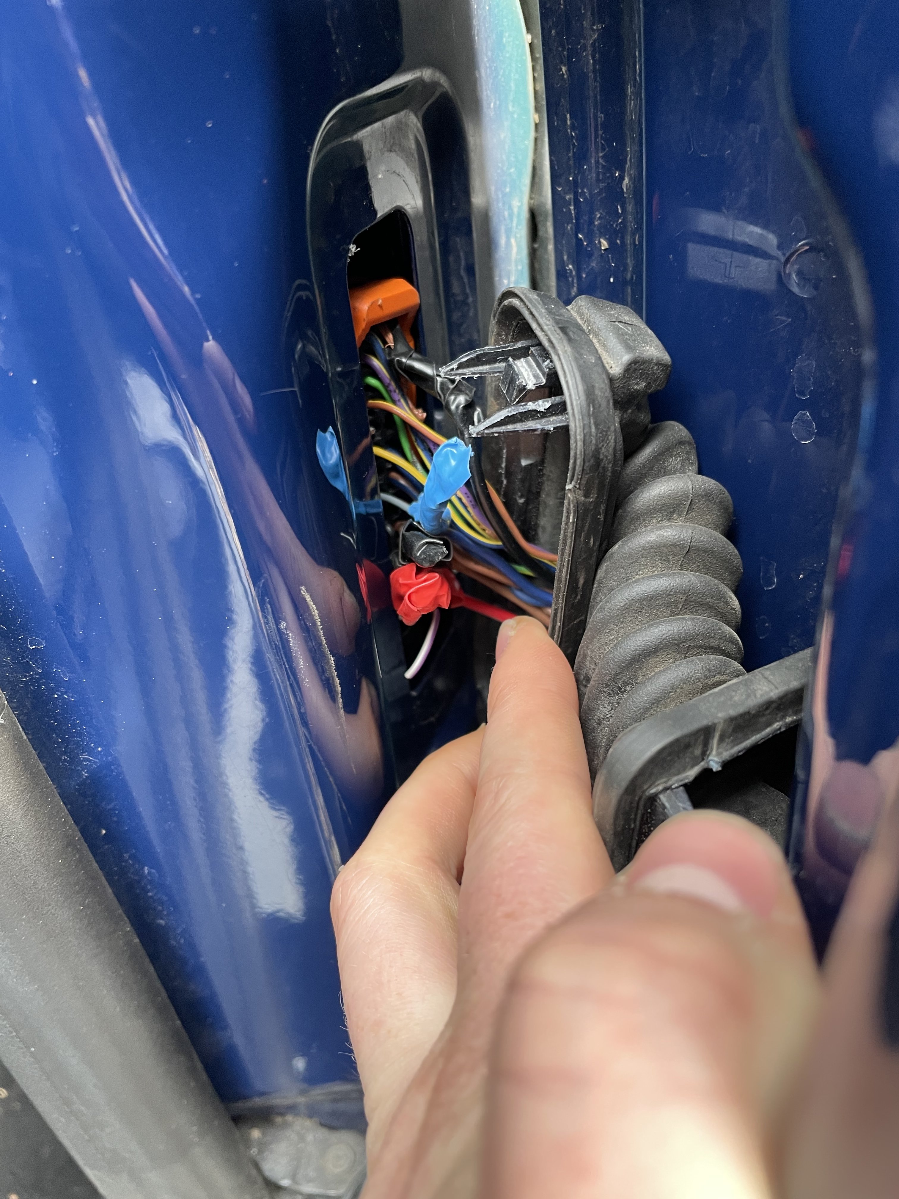

Looking for a drivers door wiring loom colours for Fabia HTP 1.2 2011 its a J5 RHD

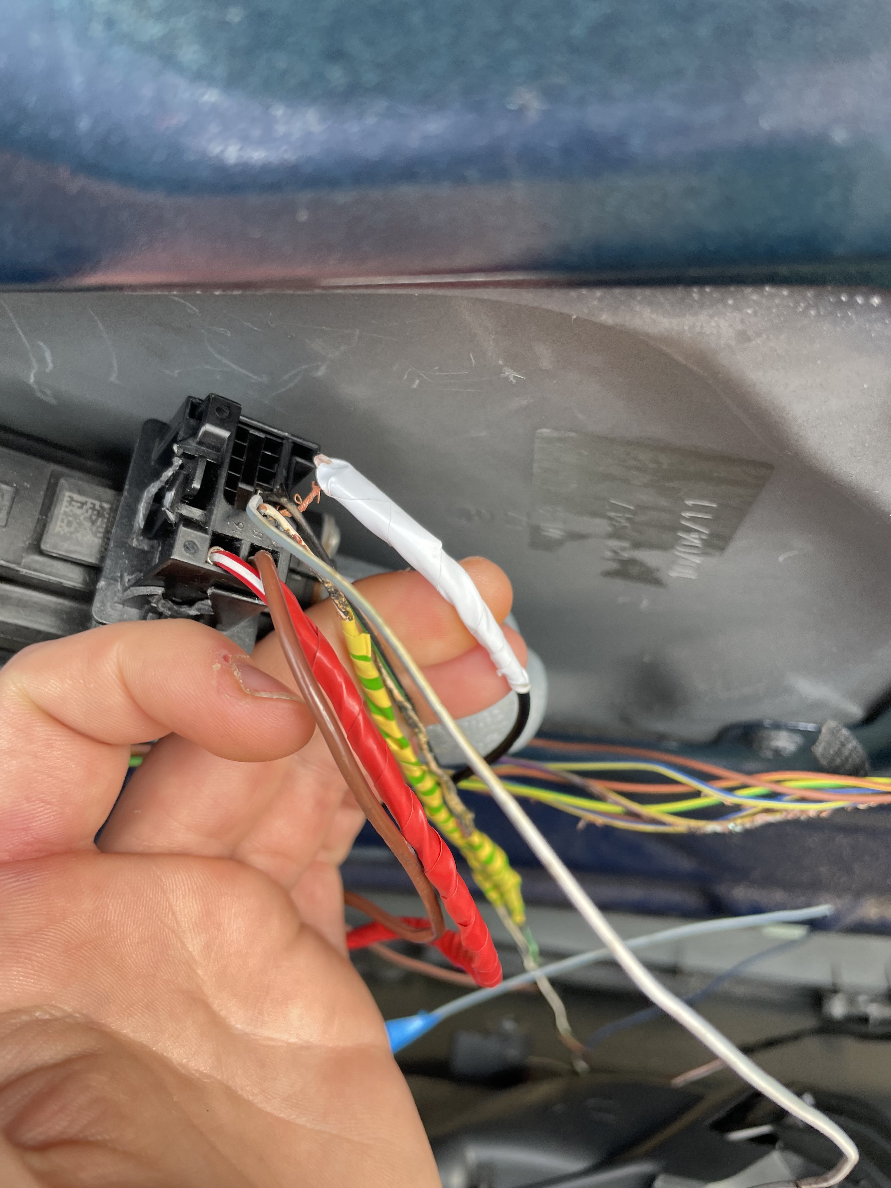

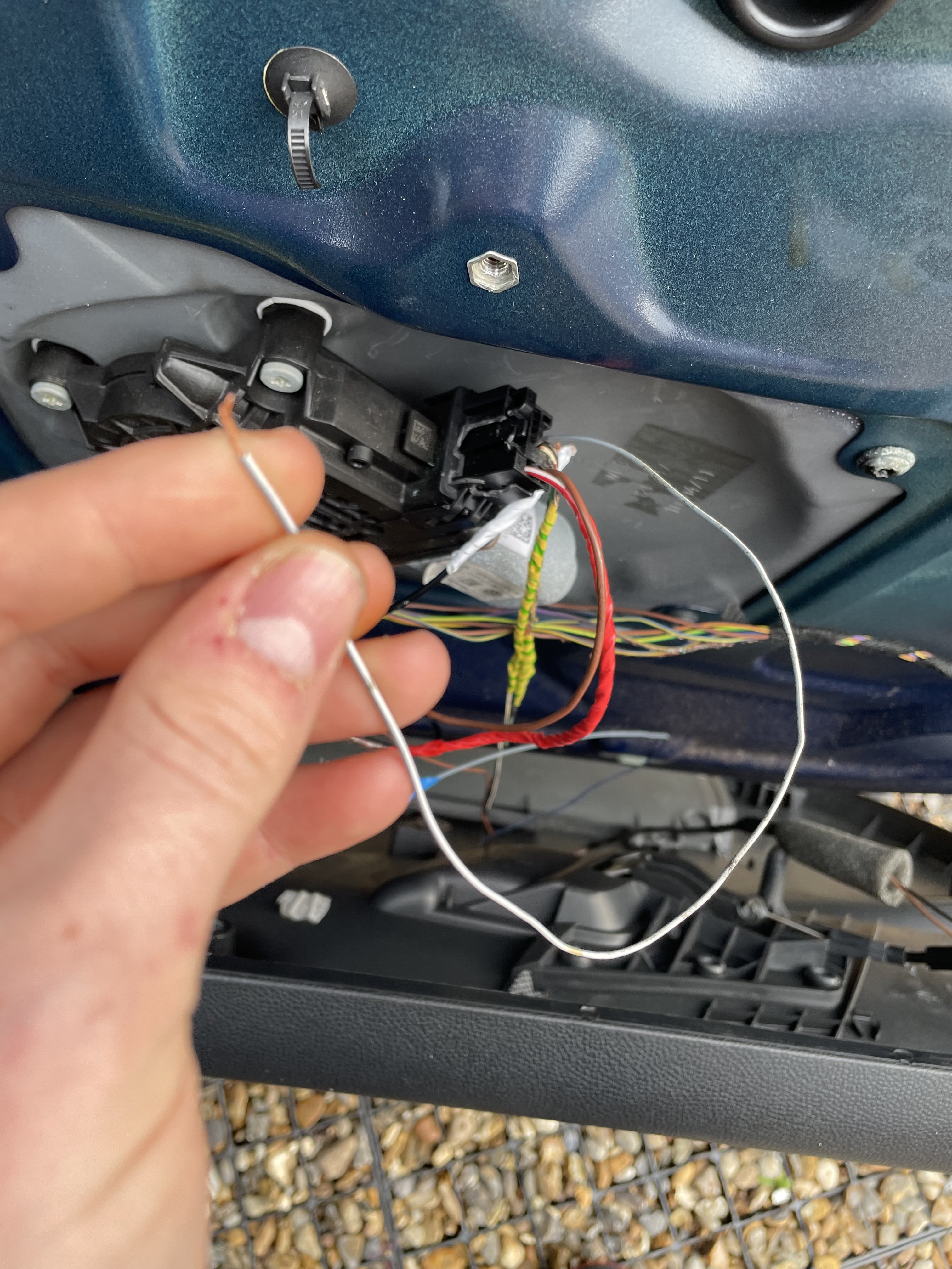

Right the gray and white wire on pin 5 is definitely Signal wire it tells the motor when the car is unlocked if you put 12v to it sometimes will think the car is locked not sure why but this explains when I press the lock button in the car it auto unlocks straight away so I ended up getting a bigger wire and put it into the 5th pin where the shaped cable was and it worked straight away but this will not solve the problem I do still need a new harness I’m going to have a look at some wrecker yards over the week end to see if I can get one any recommendations of wrecker yard websites would be lovely as none of my local ones have a fabia in

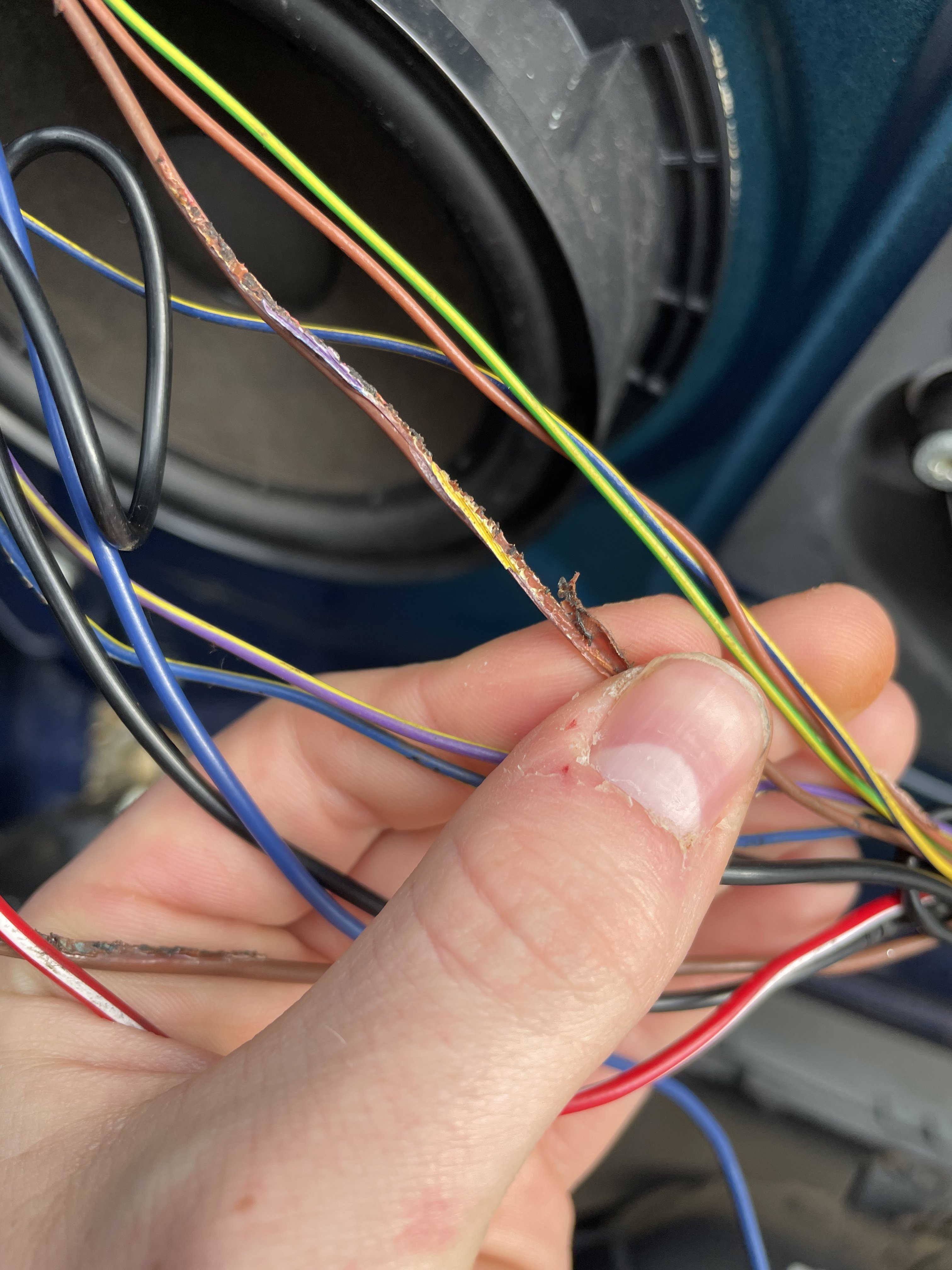

thank you this is what i was thinking just wanted to check is there a way to depin these connectors as i will need to depin pin 5 as its has a broken wire deep in the socket like somebody had yanked the wire out of the connector. 😞
quick one with the numbers at the end as per below example is this the pins they go to? Also i need to repair that smaller wire as your helpful doc states i should have 2 grounds i only have the big ground not the other wire as that was burnt out.

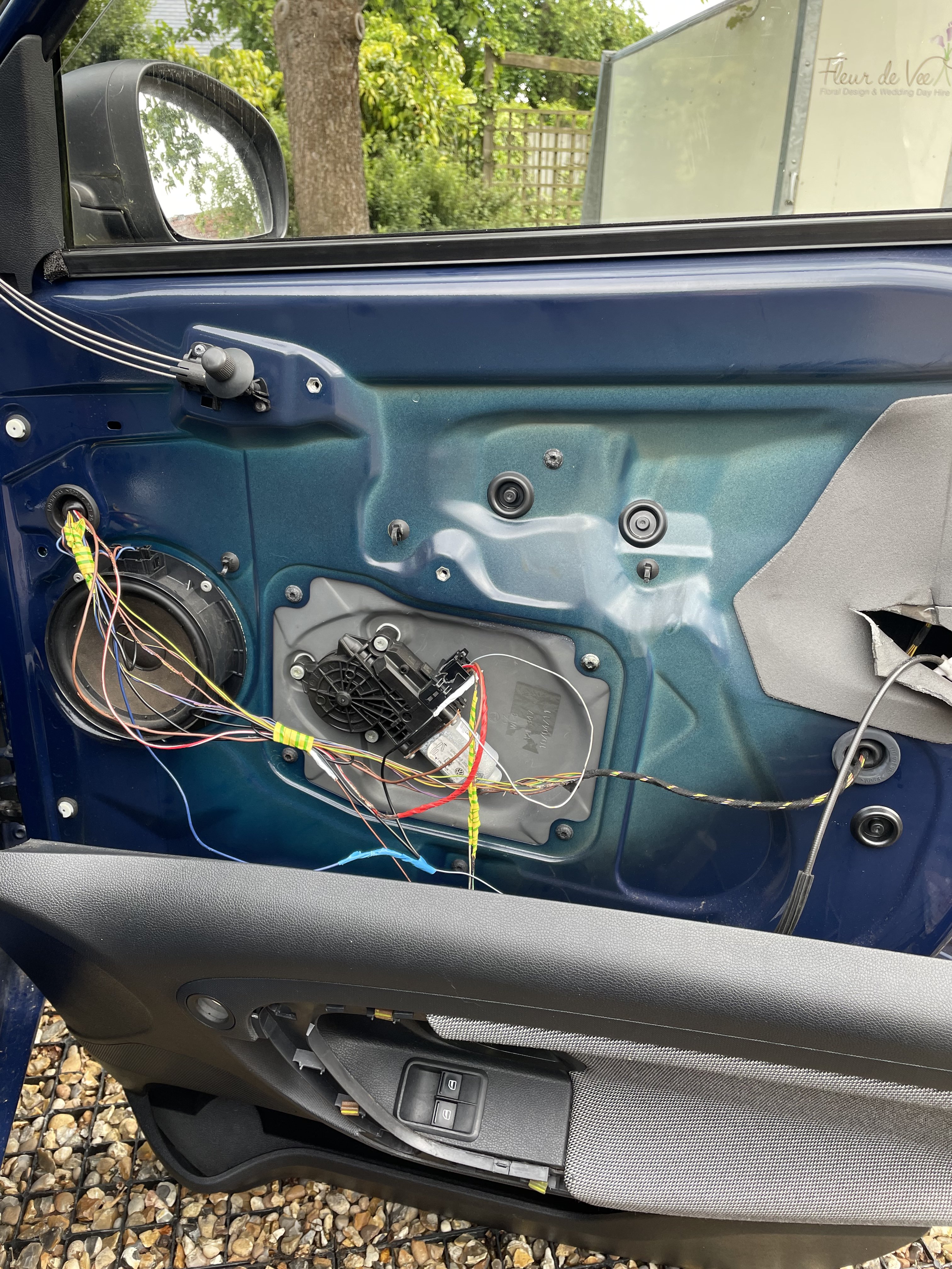

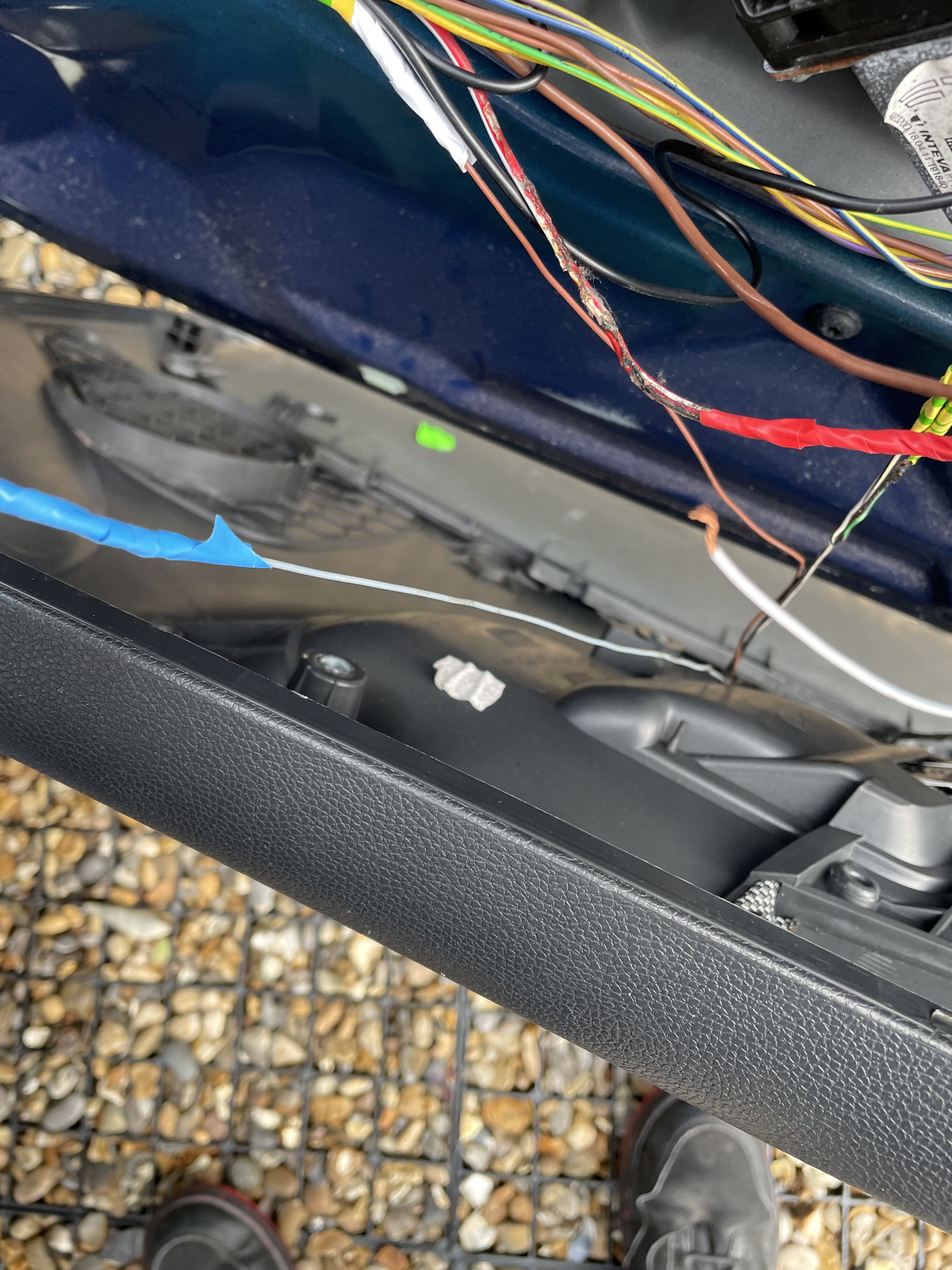

i think the colour of the wire i mean must be a gray and white where it was melted it looked like the led for the switches the colours ill take a picture of my temp fix on this issue after 5pm today.
im assuming no one has one as im not able to get one from anywhere would buying one of these kits be a good idea? https://www.ebay.co.uk/itm/313776901795?fits=Car+Make%3ASkoda|Cars+Type%3A1.2|Plat_Gen%3AMK+II|Cars+Year%3A2011|Model%3AFabia|Variant%3APetrol+Hatchback|Engine%3A1198cc+44KW+60HP+BBM%3BCHFA|BodyStyle%3AFWD+II+542%2C5J%2C5J&hash=item490e8f8ea3:g:jW0AAOSwh8JhqJY8&amdata=enc%3AAQAHAAAA8ALfFHIUFrLW3woRxwhqCQ5k9FDaACCgyI8irRhCcNl%2Fs2gSsZb0iha12BJVpPLysalzrrM2eknlGWa95RDeqwEP8xVkc%2FlIs%2FPeqIEGyUswQW9lPhvnJSftJr695jb9u1owOkV2D20AAMWM7BOriBfy3Kog%2BzVNGzVc83F6OD%2FOSd4%2FEkYI2hVuWthkLOZotJPo0gF87yyZLrY4KTZuw%2FA2bQFuzGlRitV%2BiTbQi%2BeBQAC90hZTK51z1QNm3Vl1%2FpQ93Pjfxie2JUDL8IioU7tXziaaBzfF9D%2F17nN4e8dcbGm1ZZGUwYGFsHY9RaN2bQ%3D%3D|tkp%3ABFBM3ruUn6Ng at least then i can find out and doc it for other people? Please let me know if anyone has any answers im happy to take some pictures of the jobby i have done as its not as bad as when i got the car saturday. Its all temp wiring to find out if the reg had been killed or if the switches had been killed or the locking system as well.
Hi, I have the lovely common fault of the drivers side door wiring loom has been cut so my window has stopped working i have jerry rigged a setup to get the locks working again with the damaged cable by finding the correct cables. But from the motor for the window i have a light gray/light blue coloured cable that had been ripped out of the plug on the plug side towards the car please let me know what this cable does the only thing i have come up with its a signal wire for v12 on when it seems to touch any other wire that has power the window works till the car is locked and won't work again till its taken off the wire and put back on. There seems to be a brown or something else im not sure as the wire was burnt out and has no sleeve on it anymore but seems to be a brown one as that was the cable damaged through the loom. I have repaired about 90% of the loom by hand it took a very long time and i had no instructions or multimeter just took some good guesses from wiring head units in cars. I just need some help understanding what im missing from this i will be buying a repair kit at some point once i fix the current broken loom to see if its worth spending the money or just getting rid of the power window and popping in a hand crank instead.
