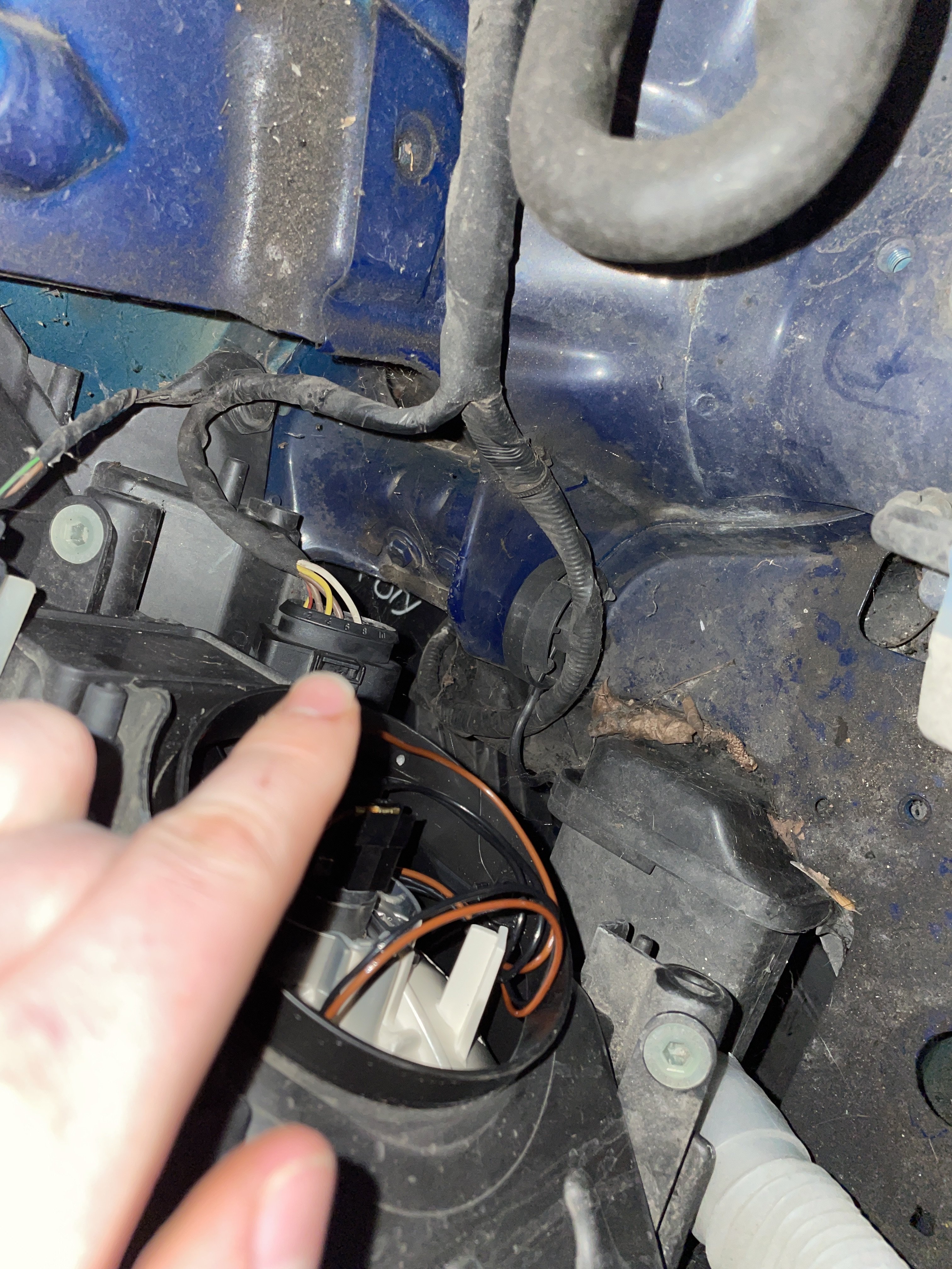

Hi all, I took the plug of the head lights and white is a short to ground and positive any ideas where I can find the end of the white cable

thanks for the info with that white wire does it go into the switch in the car is so i did test a white looking wire but it was shorting to ground as well I did find another wire that look a little bit more white and that was not going to ground

I’m not 100% sure anymore as I’m not able to get the shot to show it’s self again I’m being stupid and I can’t get the connector of the light lol

there is a short to ground on the white wire on the front head light connector

Ahh this is what i mean the side lights the upper single light bulb by its self above the main bulb im assuming this is side light.

Yeah i get what you mean lol yeah i phone the skoda dealer where the previous owner brought the car from and they have informed me that my car does not have DRL and its not factory fitted and was not brought as an extra which is not good for me im going to have a hunt through the engine bay tonight and start on the light connectors to see if there is something poking out i have a theory that the burnt-out earth cable has eaten some wires for the rear of the car and the BCM thinks the dipped beams are always on whitch make sense but nothing so fair on this car has made sense. Pete the wiring god can you please send me the pin out for the dipped lights on the BCM if you have it if not ill prob have to buy the Haynes wiring manual which will make me cry im soo glad im not colour blind.
