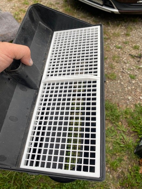

SensibleNick replied to SensibleNick's topic in Skoda Favorit, Skoda Felicia, Skoda Fun and Skoda FormanThe grid fits into the "bottom" of part 15. I'll take pics when it's not raining like hell!!

SensibleNick replied to SensibleNick's topic in Skoda Favorit, Skoda Felicia, Skoda Fun and Skoda FormanThat looks like it could be done Nigel: A little trim and a new card edge, and I think one would fit. I'm fairly confident it'd be rigid enough to be possible without the grid too. I'm mostly arsing about with materials I have lying around. but I'll investigate modifying ready-made cabin filters if I don't manage what I want. For all I know, I just made the ultimate mouse-bed

SensibleNick replied to SensibleNick's topic in Skoda Favorit, Skoda Felicia, Skoda Fun and Skoda Forman370x137 is the dimension of the component. Measure yours and see if that's right (and it is 18mm thick)

SensibleNick replied to SensibleNick's topic in Skoda Favorit, Skoda Felicia, Skoda Fun and Skoda FormanIt looks like our housings could have the same sizes. 370x180mm roughly... does that sound right? I'll check my dimensions tomorrow.

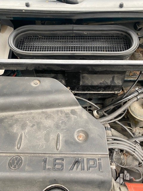

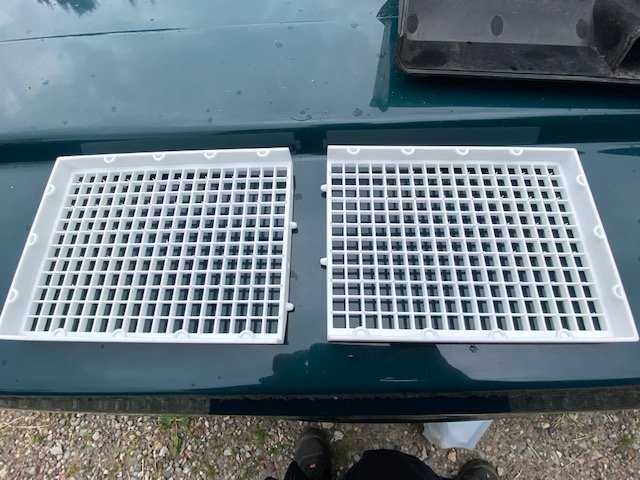

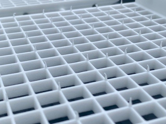

I got annoyed with the lack of available filters for my newly acquired pickup. The previous owner hadn't found one either - the thing is full of dust. So... I've designed a grid that should fit on most 3D printers, and if anyone wants, I'll put the file on Thingiverse. Just print two and they fit together. (Same username as here) It fits in the "correct" place, and is to support any filter-material, and has little spikes to stop it from shifting. I'm going to experiment with making a pleated filter from a large synthetic vacuum-cleaner bag, but for now it has a cleanable fleece-style filter from a cooling fan in it to stop the tiny flies. I might make a second part to "clamp" the filter down. I'll test it first. The current design would need supports... I'll fix that.
