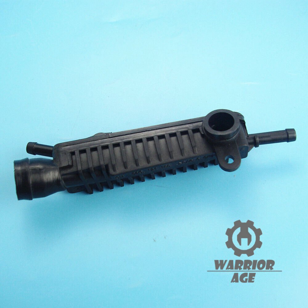

  9. Just a quick update. Car went to garage where they pressure tested the cooling system. There was coolant dripping from the inlet manifold but they couldn't see where from. Removed the manifold and found the item in the picture had opened up along a glued seem. Seems to be some sort of device for heating the inlet manifold using the hot coolant. Garage (ex Skoda dealership) said they had never changed one before. Anyway thanks for the advice.

  12. Thanks for the quick reply. There has been a slight leek for sometime but it was so minimal I just lived with it. Just before my holiday I had a new cam belt and water pump fitted. Could this have disturbed the o'ring where you have circled it on the left?
  13. First post. 2009 1.4 BXW with 70000 miles. I have a coolant leek from somewhere at the back of the engine. It is wet on the underside of the inlet manifold from where it drips down to the ground. I have just done 1200 miles on holiday and I had to top it up three times from min to max. The engine never missed a beat and is still running fine. I know it's possible that it could be the head gasket but is there anywhere else it could be coming from? I have done all the usual visual checks for gasket failure but I appreciate that it could still be the problem. Regards
