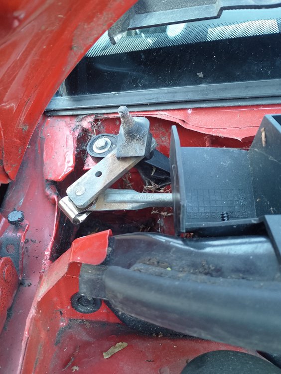

I put them the new linkages in and they worked fine for just under 4 weeks but on the drive home last Friday the drivers one went again. On inspection I I can see the rubber bit that holds the metal ball has worn out!
So I ordered those clips as per my OP. They are similar to the ones on Amazon but just designed slightly different.
I couldn't fit them in situ so I undid the 2 bolts on the wiper mechanism thingy (either side) and then 4 torx screws to disconnect the motor. I was able to take the mechanism out without taking the motor out of the car itself and I didn't need to disconnect the motor wiring.
I managed to get the clips on quite easily - there is a knack. I ended up cutting down a bit of the washer as the clip has to go into the same gap.
The clip is not a tight fit - but I am hoping if the linkage comes out it will hold it there by gravity??
If this doesn't work then I could maybe buy a new kit, a new genuine linkage if mine not genuine or maybe screw a hold through and put a bolt or something in?
Just to add - this is what it looks like
The way I could do it is put the open part in first and then use a screwdriver to stretch the other part over. Its easier said than done in situ in the car though.

I managed to fit them with the motor in situ with some clips I ordered off eBay.
I think the key to it is you put the clip onto the ball first (the long arm is off) - you then force the long arm in using its leverage to push the clip down and squeeze the long arm in.
I think I was trying it the other way round by trying to push the clip in when the logn amr was connected
