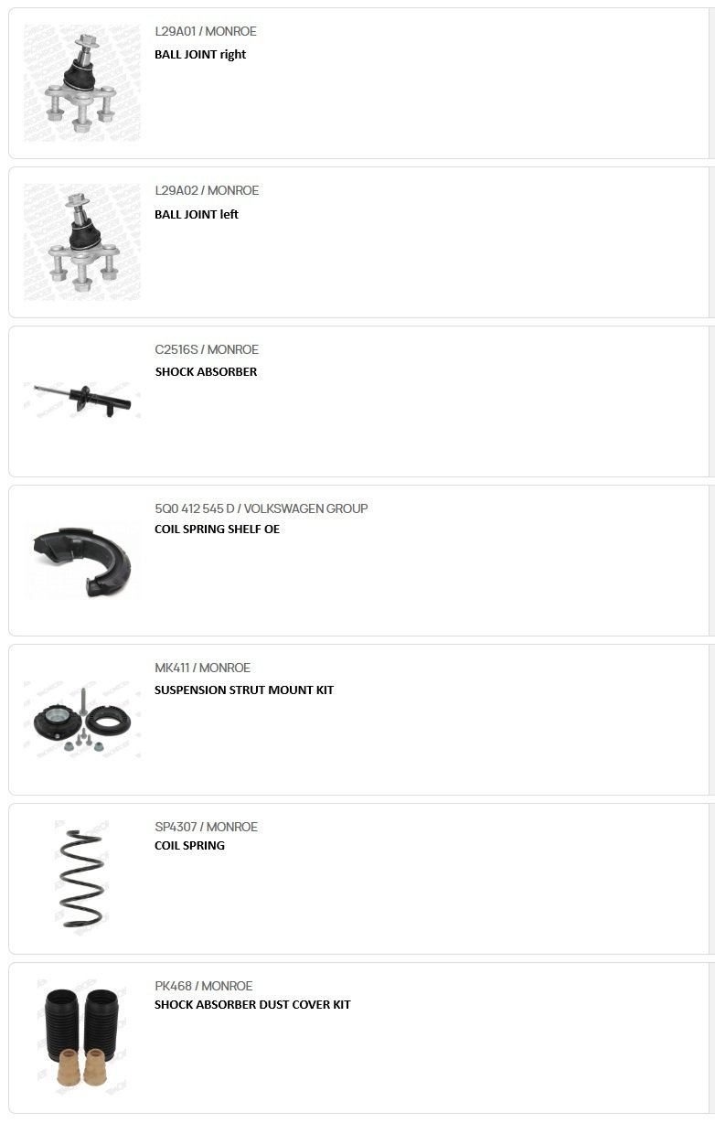

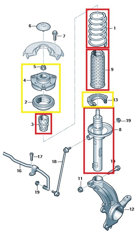

I need some good advice. It was recommended to replace the front shock absorbers and ball joints. I thought I would look into what is a good practice to replace them. I was told that I should also consider replacing the coil springs and dust covers with new ones. Is there anything else? I have attached a picture of what the area requires and what I am currently considering replacing (in the red box). Is it also a good idea to replace the parts in the yellow box?
the plan is to replace the shock absorbers (new shock absorbers MONROE C2516S) and ball joints. Would it be reasonable to also replace the coil springs and shock absorber dust covers (new Monroe PK422) in this case? Skoda Superb EstTe L&K 2018 2.0 TDI 140 kw 4x4
