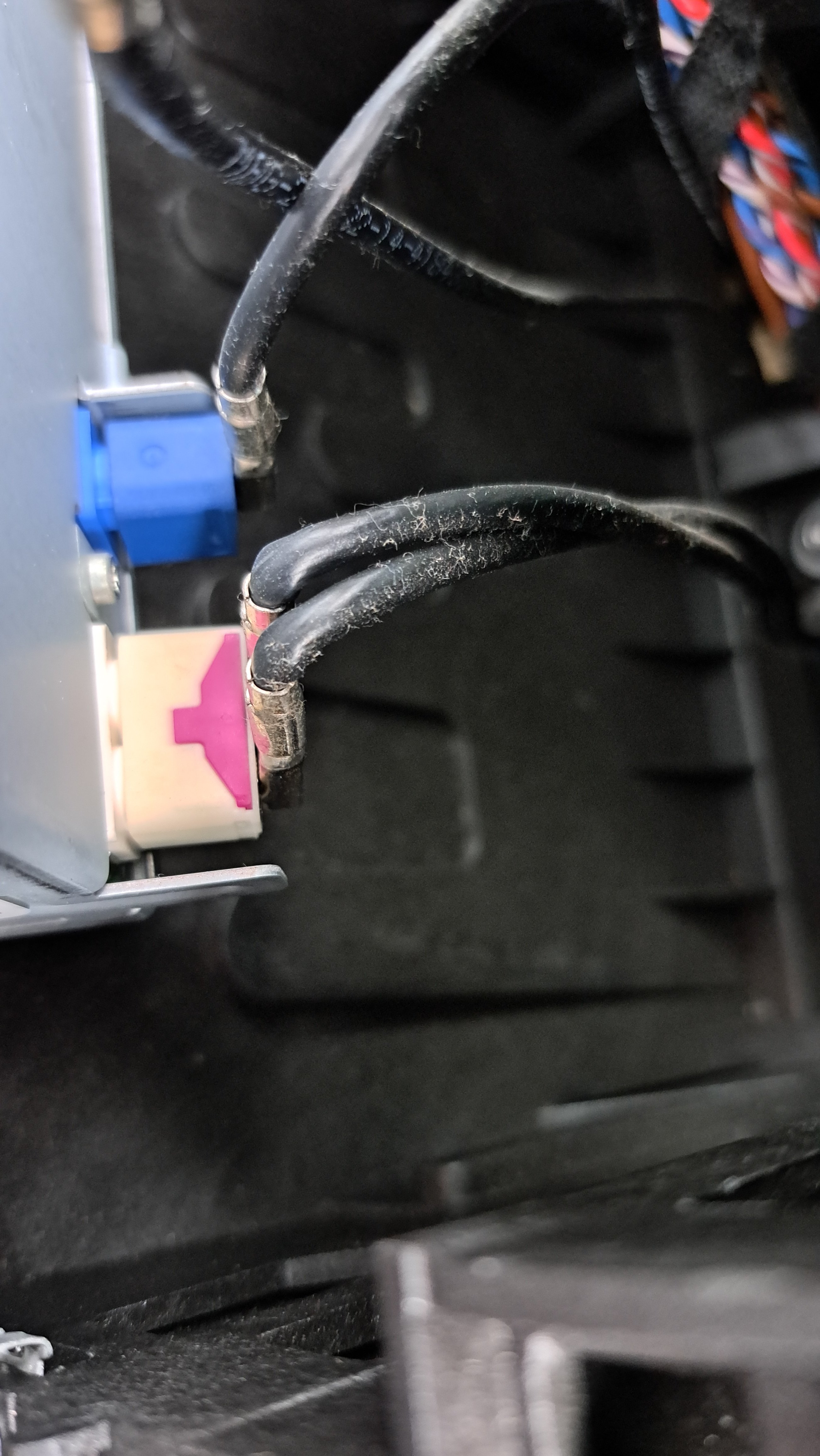

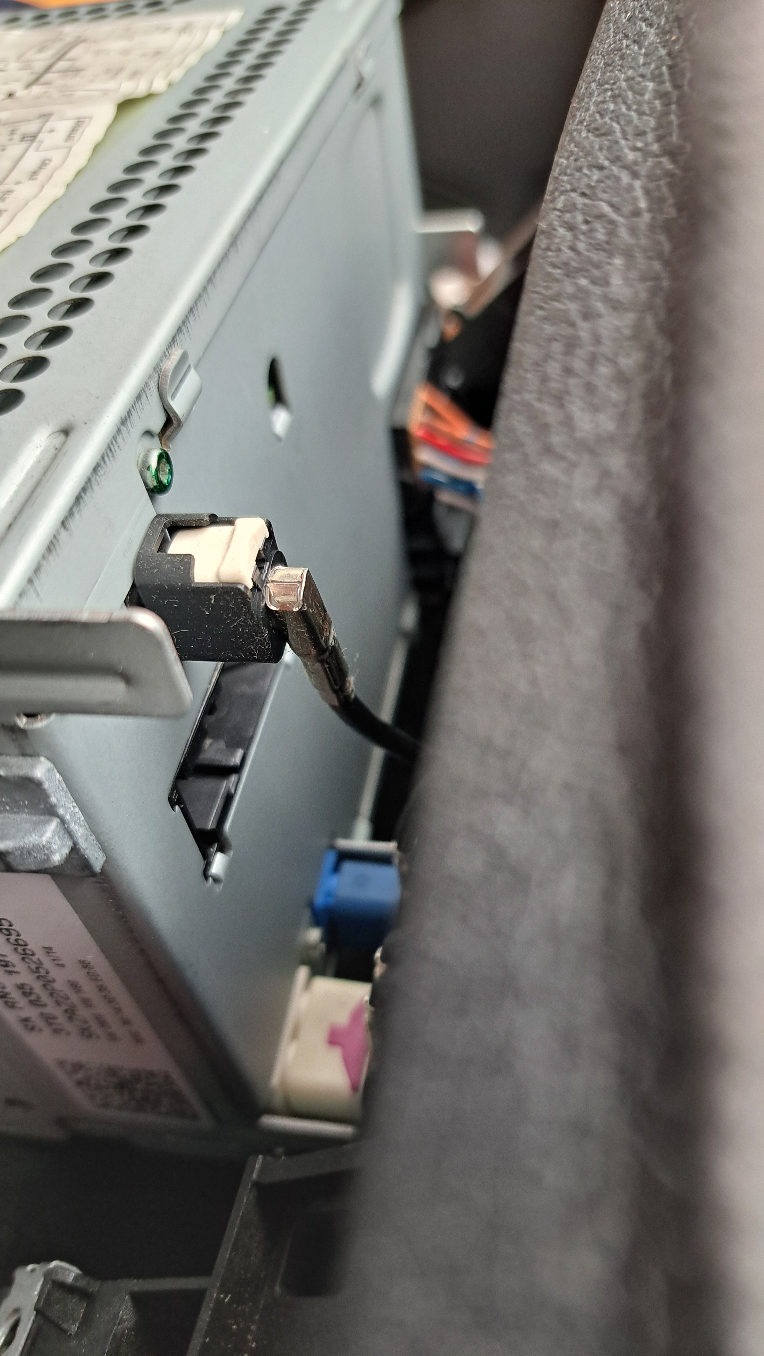

  2. Hello, I have an RNS315 unit in my Yeti. I have purchased an xtrons unit to replace it with. I want to know which cables in the car are which. As in which one is radio, which one is DAB, and which one is GPS. My aim, if possible, is to use the existing cables and connect them to the new unit, rather than connect the new antenna to windscreen and such. Bad pic of the 3 cables disconnected from RNS315 attached. I think white one at the top is the radio antenna, which does FM and possibly AM radio. Which one of the remaining two at the bottom is which (DAB, GPS) please? Thanks 🙂
