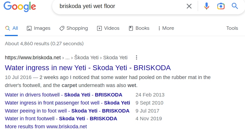

Do you have a sun roof?
eg
Edited by toot
