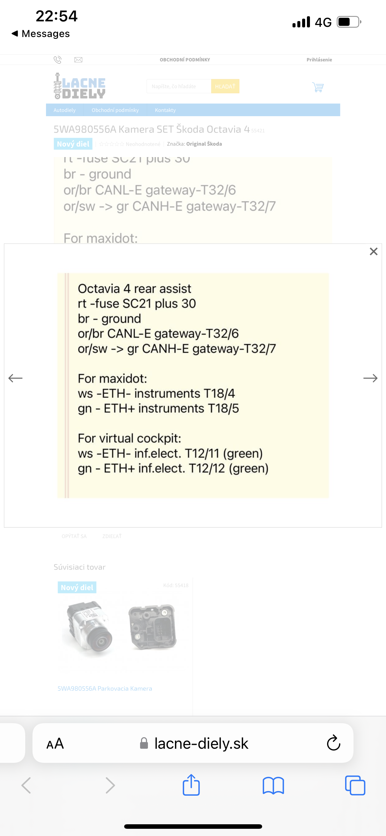

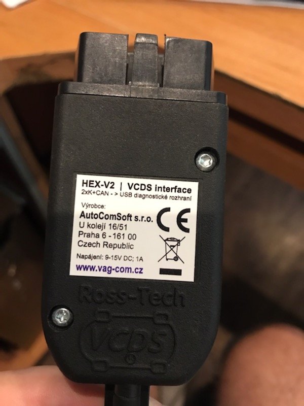

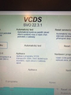

  1. this is how camera was fitted. Also regarding diagnostic system I have this: I need help with online access, because apparently Skoda cars made after 2020 need to have online access. So in order to make my rear camera working in need someone who has licence with VW concern to do so. Can someone help with this please, I heard this can be done on distance as well.

  3. https://www.lacne-diely.sk/5wa980556a-kamera-set-skoda-octavia-4/
