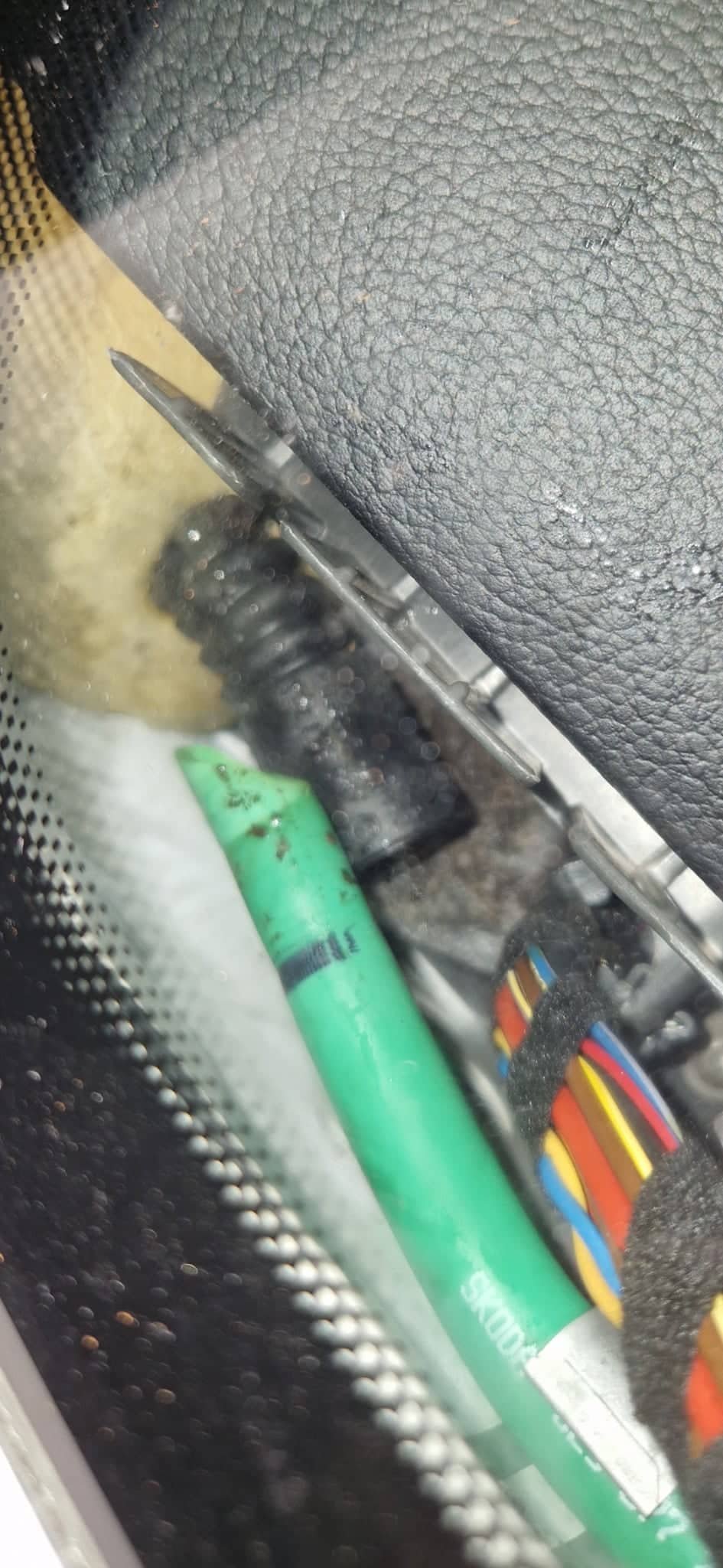

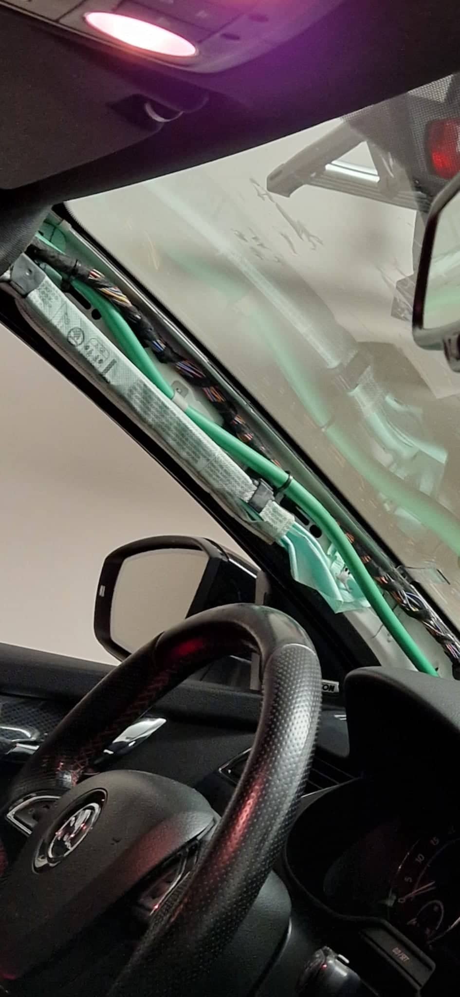

  1. I think that this is exactly what the previous owner of my partners Octavia RS 2014 did... I had a floding in the floor after the first heavy rain... If this happens to anyone you have to take off the front A pillar trim cover, behind the trim there is a tube that is probably disconnected. I have glued the tubes back together with some epoxy, because I dont want any future problems with this... Luckily there was no damage on the electronics.
