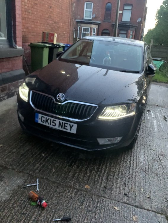

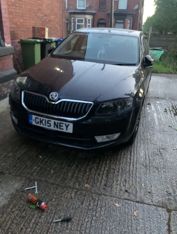

  8. Hello all, just to close off this post; I’ve gone ahead and opted to fit 3rd Party LED headlights whilst fixing another issue. Here’s how they look;
  9. They look great still. If it comes up on MOT in a couple weeks, I’ll try solder in a new row of LEDS with green light to create yellow. And yes, they do a light dance. Always when headlights are switched on. very nice when unlocking the car at night, always gets a few wows

  14. Another update, error codes are easily removed by changing some adaptions to reflect a factory LED installation. I can include the diagram here but it’s in the ‘Tried and Tested’ adaptions thread. I’ve set my parking lights as DRLs which looks nice for now!
  15. You’re exactly right. I didn’t realise this, thank you! It might just sneak by due to the standard indicator working as normal. If it causes issue for myself, I’ll need to get a soldering iron out…
