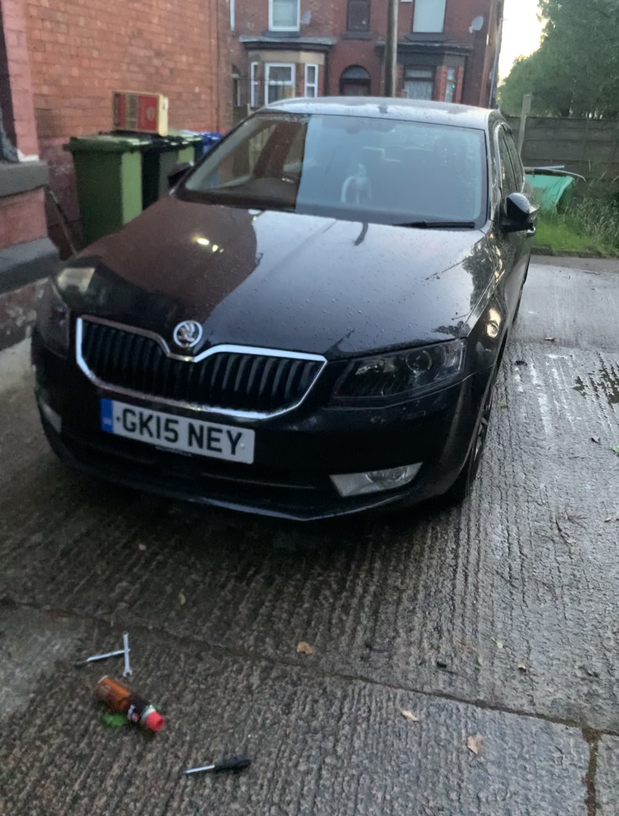

Hello all, just to close off this post; I’ve gone ahead and opted to fit 3rd Party LED headlights whilst fixing another issue. Here’s how they look;
They look great still. If it comes up on MOT in a couple weeks, I’ll try solder in a new row of LEDS with green light to create yellow. And yes, they do a light dance. Always when headlights are switched on. very nice when unlocking the car at night, always gets a few wows
