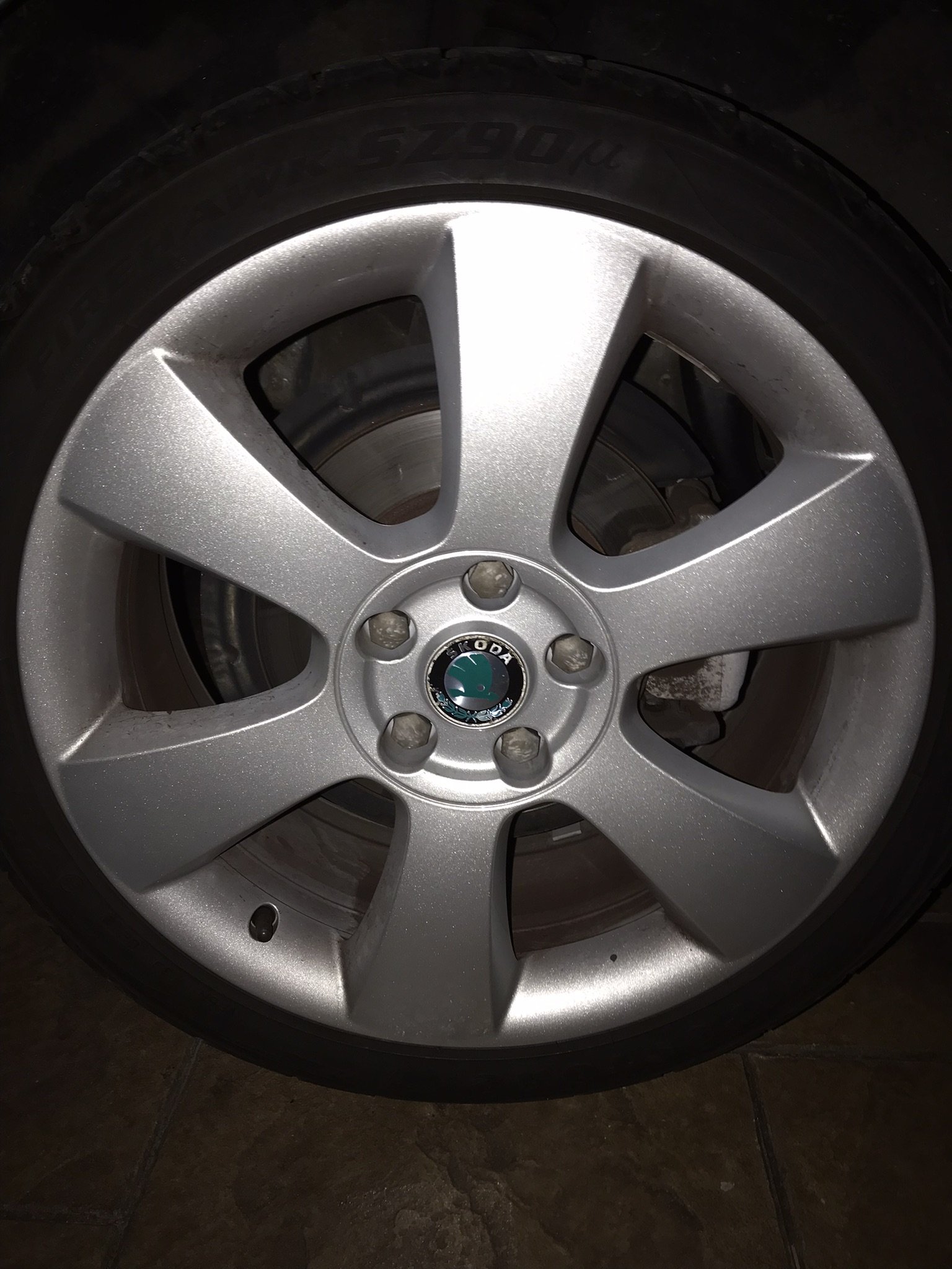

Cheers Ken I have now established that I have 3T0601025K wheels which are 7.5J x18H2 with an offset of ET46. Then on the inside of my fuel filler flap it shows tyre pressures for a 16" option (205/55R16 - which I think will look too narrow) a 17" option (225/45R17) and my current set up of 225/40R18. I have looked at loads of different "will they fit" type sites and input all the different parameters and it seems there are several options to consider. I have taken photos of the codes cast into the rear of the wheel but I can't see anything relating to a centre bore dimension - what would it look like please As a few people have suggested, it does make sense to check out tyre options for my existing rims first, so I am going to speak to a couple of tyre fitters about the ride quality and wear performance of different types of tyres about what the road noise and ride quality would be like.

Hello everyone, I have a MkII Superb estate 4x4 Elegance running on 18 inch alloy wheels, with 225/40/R18 Firestone Firehawk SZ90 tyres, and I absolutely hate the ride and road noise from them. I have been told on a Skoda Superb FB page that these are too low profile to start with and should be 45 minimum. I break out in a cold sweat every time I ride over the slightest road defect of any kind, and am just waiting for the warning to pop up on the dash telling me one of the tyres is deflated. I am considering moving to a smaller wheel diameter (probably 17") with a larger tyre wall, but I know as good as nothing about the types of fitments, offsets, rolling radius etc . . . Could anyone offer any advice regarding which OEM VAG/Skoda 17" alloys would be suitable in terms of fitment and offsets, and what tyre side wall I would need to go for to achieve the correct rolling radius for the speedo and odometer? Further to this, would there be an opportunity to sell the wheels and tyres (all in very good condition, wheels pretty much unmarked as they were refurbished before I bought the car at the beginning of August) to offset the cost of replacing them with ones where my fillings stay in my mouth and I don't need to see a chiropractor every time I go over a dropped inspection cover? Thanks in advance.
