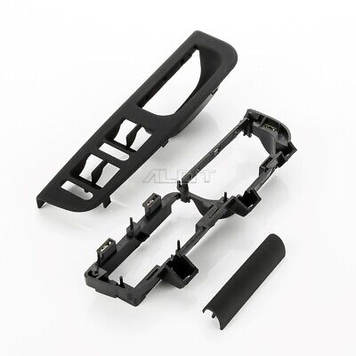

  2. I recently broke my driver's interior door handle, the chassis of the handle is bolted to the door pannel than the cover which holds the window controls gets pushed down onto the chassis. What i found is that the normal passat b5 chassis doesn't fit on a superb's door. Did anyone else have this problem before and where do you even get a handle that would fit.
