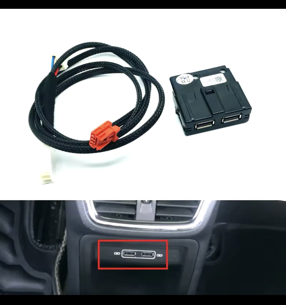

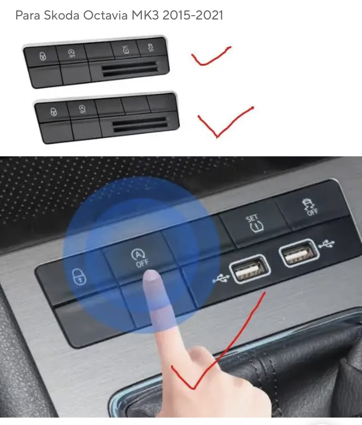

  5. Hi I installed rear usb from Aliexpress (following one tutorial on this forum) but it is not QC3 and my iphone it consumes more battery than it charges when Im using wireless CarPlay. Does anybody know if exist a Quick charge version? Also I saw next picture in Aliexpress, but I didnt find those usb. Does anybody know how can I find them (qc version better)? thanks in advance.
