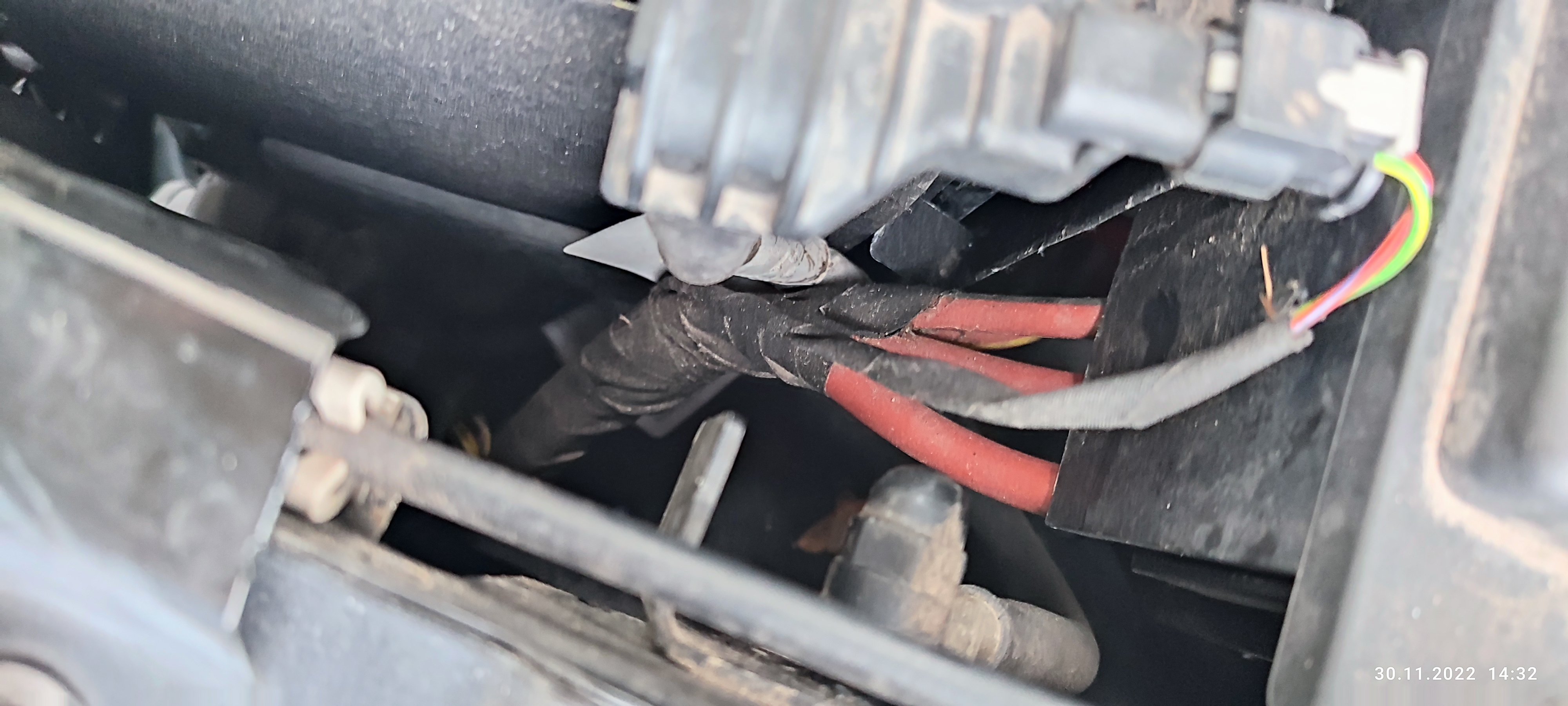

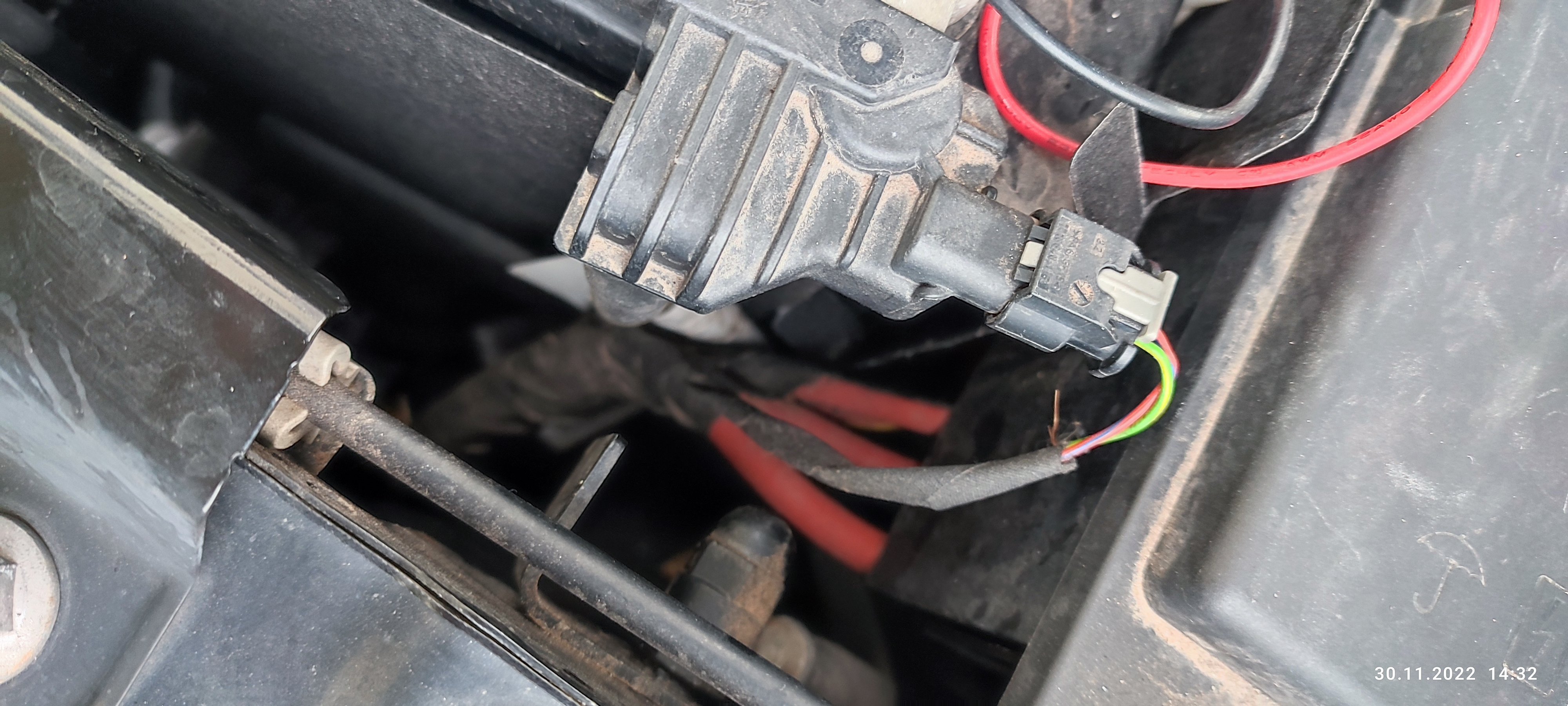

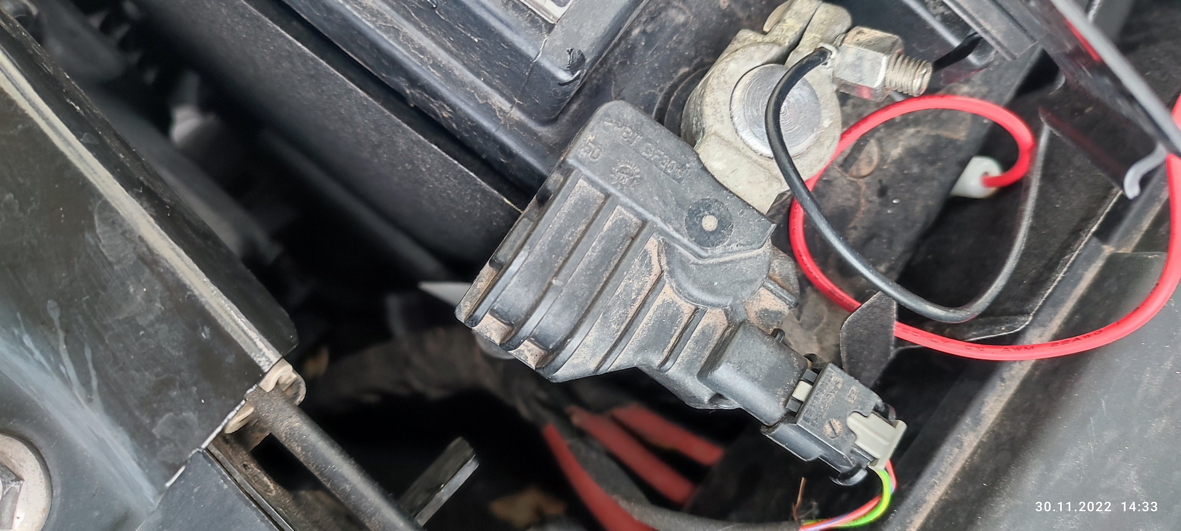

  5. Here are three photos. Please do not be surprised that is a Mader protection connected to the pole with. Only before, that was already before! The error message.....
  6. I have looked at the negative terminal of the battery. I noticed that there was probably once a Mader damage, because everything is taped with insulating tape. I have seen that two small wires come out of the pliers must be so? Or must there be more sticking out. I'll take a picture tonight. An EFB stop-start battery is installed. @nta16 thanks for the photos, that's exactly what it looks like. I'm only concerned about the two small wires. And don't worry, I'm not a mechanic either.

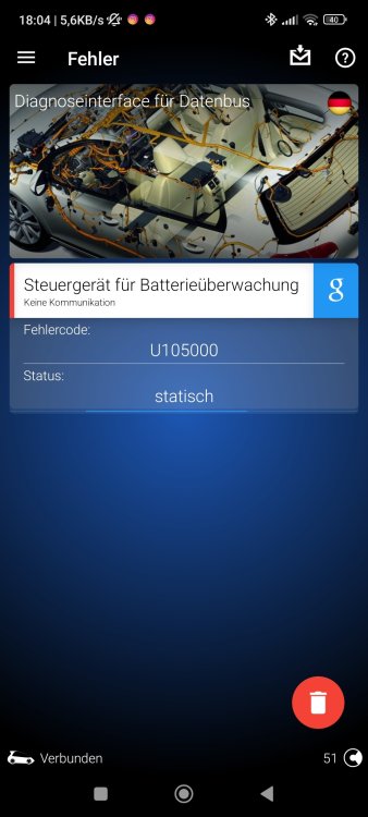

  7. Hello, dear since I bought my car brings my car the following error message control unit for battery monitoring. I have once after a battery replacement the battery re-tuned, but that was also without success. I was once told that the Skoda Fabia actually has no control unit for battery monitoring? Do you have any idea what the problem could be? A photo I attach below with.

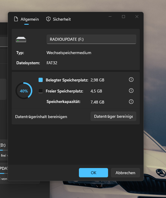

  9. Hello dear ones, is there a possibility for the rear windshield water pump to disable or code out with VCDS or OBD11? I catch myself again and again that I want to use the rear windshield washer. But there is no wiper more there. For any tips I am very grateful! Until then....
  10. Greetings varoom, I was supposed to get back to you last week, but I had a lot on my plate. The update has worked without problems, what it was now I can not tell you! I have taken another card in NFTS format, and there it went without problems. Either it was the actual card or the formatting. I do not know! Thanks for your help anyway

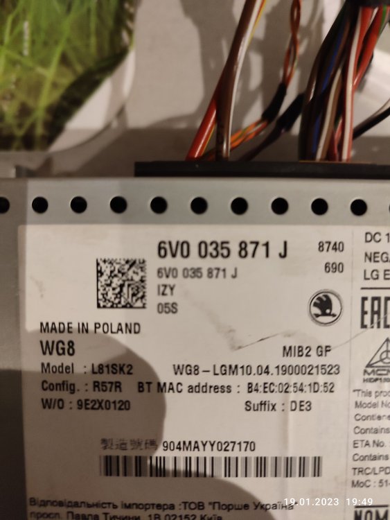

  11. Hi guys, here is the little tease I have now done the following, made the folder structure on a stick. And tried to push the update without success! Attached is a picture of the service information from the radio, maybe it's different?!

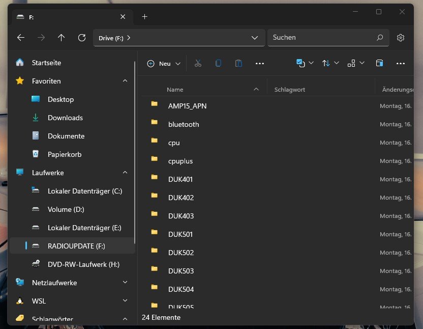

  12. This is exactly how the structure looks. Will try it with USB stick tomorrow and would let you know tomorrow. Maybe I can find a few more photos that would help you. Until then....
  13. Yes exactly I can see and also the button update I can click and also the SD card and then he grumbles around. No package available. Have just looked if I find the metainfo2.txt. It is also on the SD card. Something else, how long does such an update take?

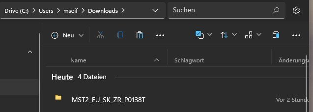

  18. Previously I had the folder MST2_EU_SK on Drive F.: , there was exactly the same.
