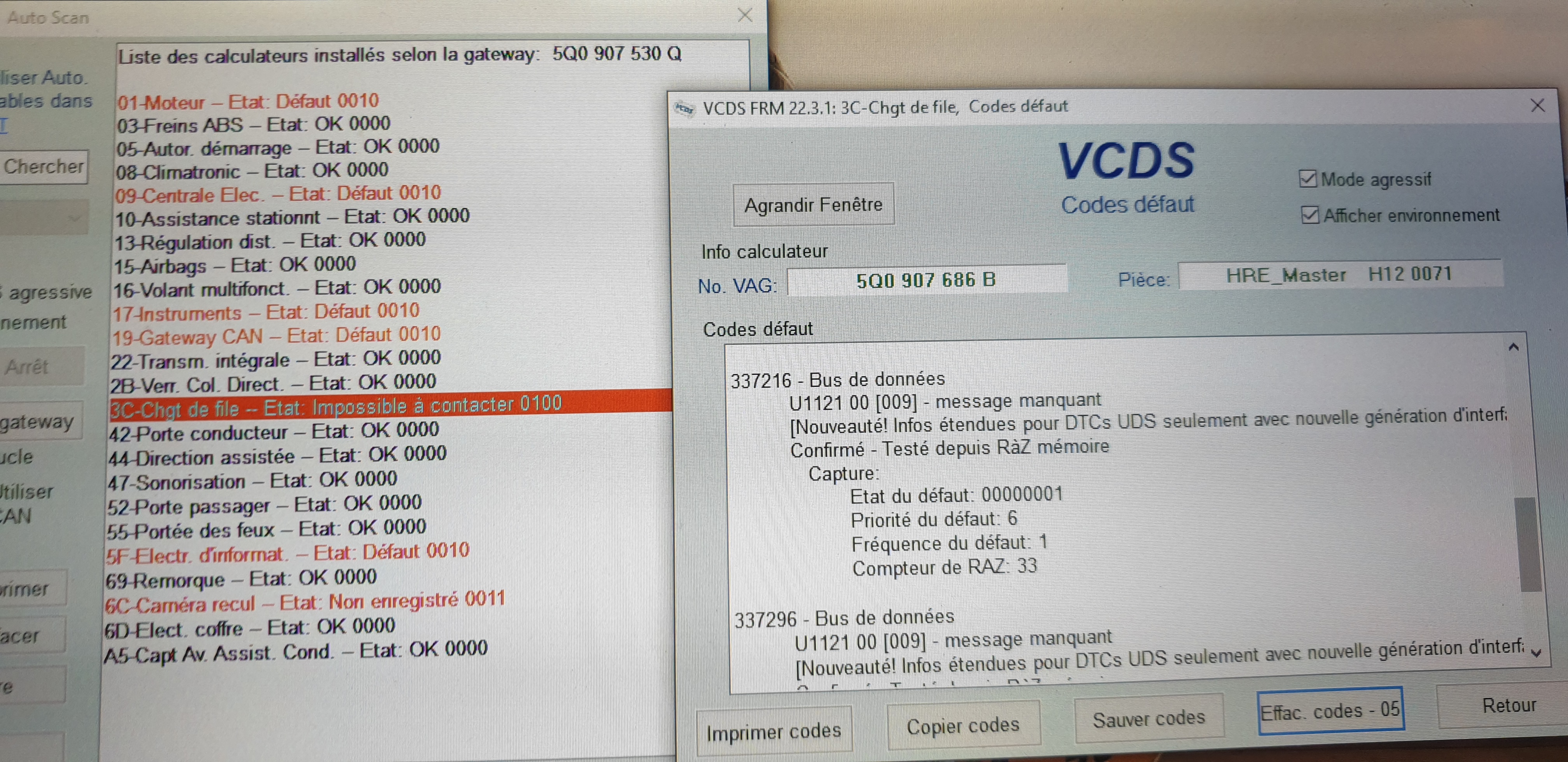

  2. Hello everyone, I come back to you because I have made very little progress on my problem. A member of the community started to help me but decided to stop because my VCDS is not "real". I bought this VCDS because it is in French on a site that seemed good to me. That's if despite that someone wants to help me it's with pleasure 1🙂 I can't encode my ABS byte 29 byte 7. I don't have the checkbox, I can modify the binary code but when I save I have the error message "time exceeded" Another problem, I don't know if I should update my PLA, and if so I didn't understand how to do it 🤔 Thanks for reading

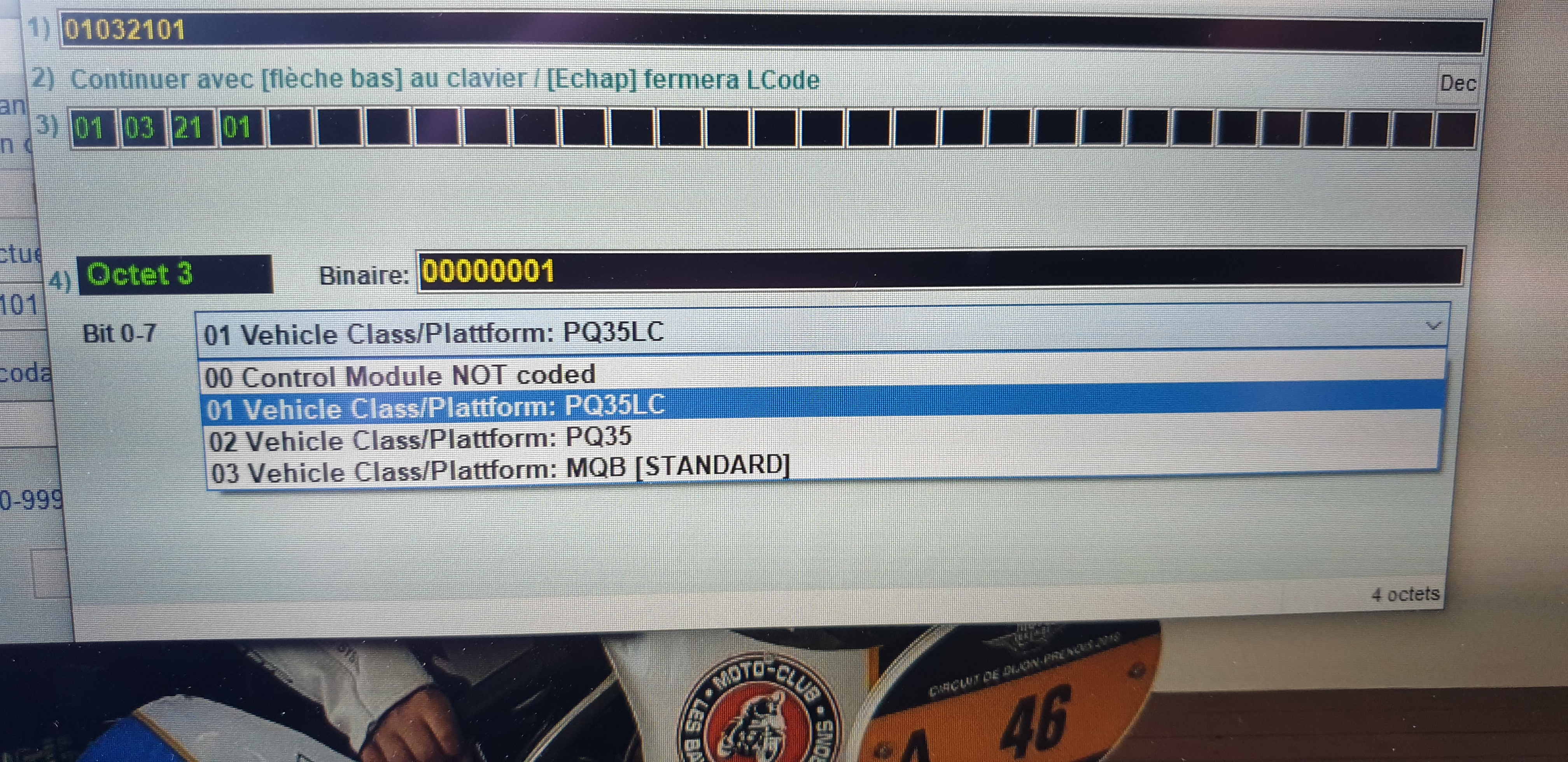

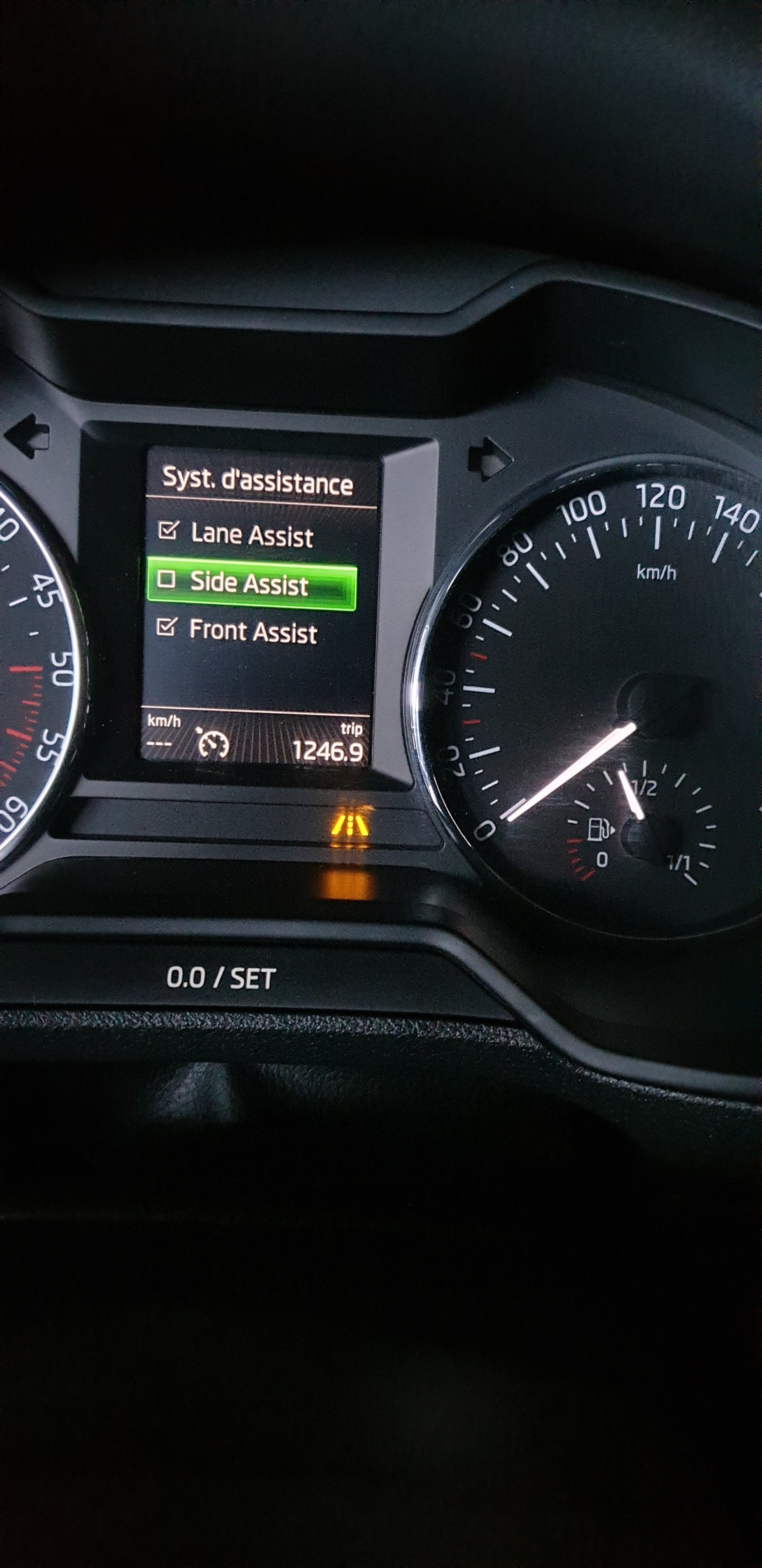

  7. Hello ApertureS, first of all thank you for taking the time to read and answer me 🙂 The procedure I did is as follows: For the "master" sensor I put that there was left-hand drive, the trailer box, for Latin American waves and the rest of the world. For these three parameters I am approximate in my description because I do not have VCDS in my eyes For the bus parameter: If I put MQB it puts me two menus on the instrument panel + puts me in default the Lane assists With PQ35 and PQ35LC he puts "Blind Spot" back on the dashboard et Lane Assists works again I checked the connection of the bus wires and everything is OK (if I reverse them I can no longer communicate with the sensors) I also tried to reverse the right and left sensors and as much as possible to communicate with the master For car coding 19 - Data diagnostic interface bus The list of equipment → item "3C - Lane change system" → activate it → save. 03 — System Electronics braking Byte 29 Bit 7 enable I can't change this one, I think my ABS block is not the right one. When I go under the byte I just have the byts displayed but no text (with VCDS), I tried to modify the encoding of the byt directly, it can do it but when sending the encoding, I I have a "request out of time" fault code 17 — Combined instruments Byte 5 Bit 3 activate Byte 11 Bit 3 activate 76 — Parking assistant Byte 3 Bit 6 enable 5F— System of electronic information Adaptation → Car_Function_Adaptations menu_display_side_assistant: enable menu_display_side_assistant_over_threshold_high: enable Car_Function_List_BAP:SWA_0x1A: enable SWA_0x1A_msg_bus: CAN_Extended Once all that is done, I have the "blind Spot" on the counter and MI1 assistance menu, when I try to activate it it marks me "system not available" I hope you understand me because English is not my language😥

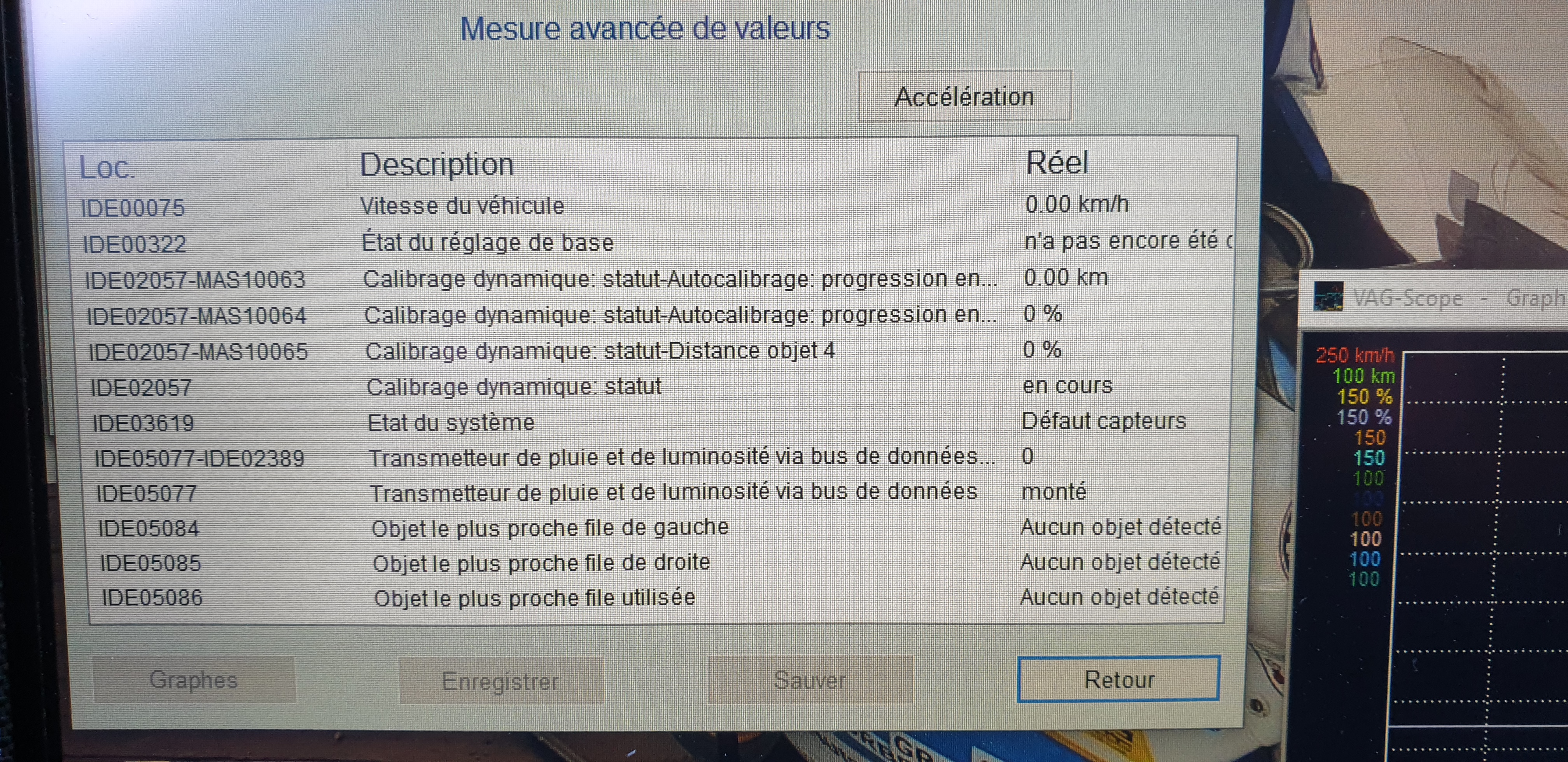

  8. Hello everyone, I started to mount the Blind Spot on my Octavia. All hardware and wiring is mounted according to the various information I found here and there. On the other hand, I have problems with coding / configuration First it marks me a Bus error And also faulty sensors Finally, here is the full scan of the car scan comp.txt Who can help me? I think it must be an update to make a box, but I must say that I'm in trouble......thanks for your help Fred

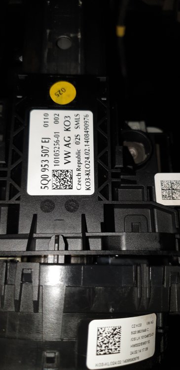

  9. Hello everyone, I'm coming back to you to see if anyone has an idea of the number of the rod that I have to put to have the limiter? Thanks for your help 🙂
  10. And here is the number of the switch

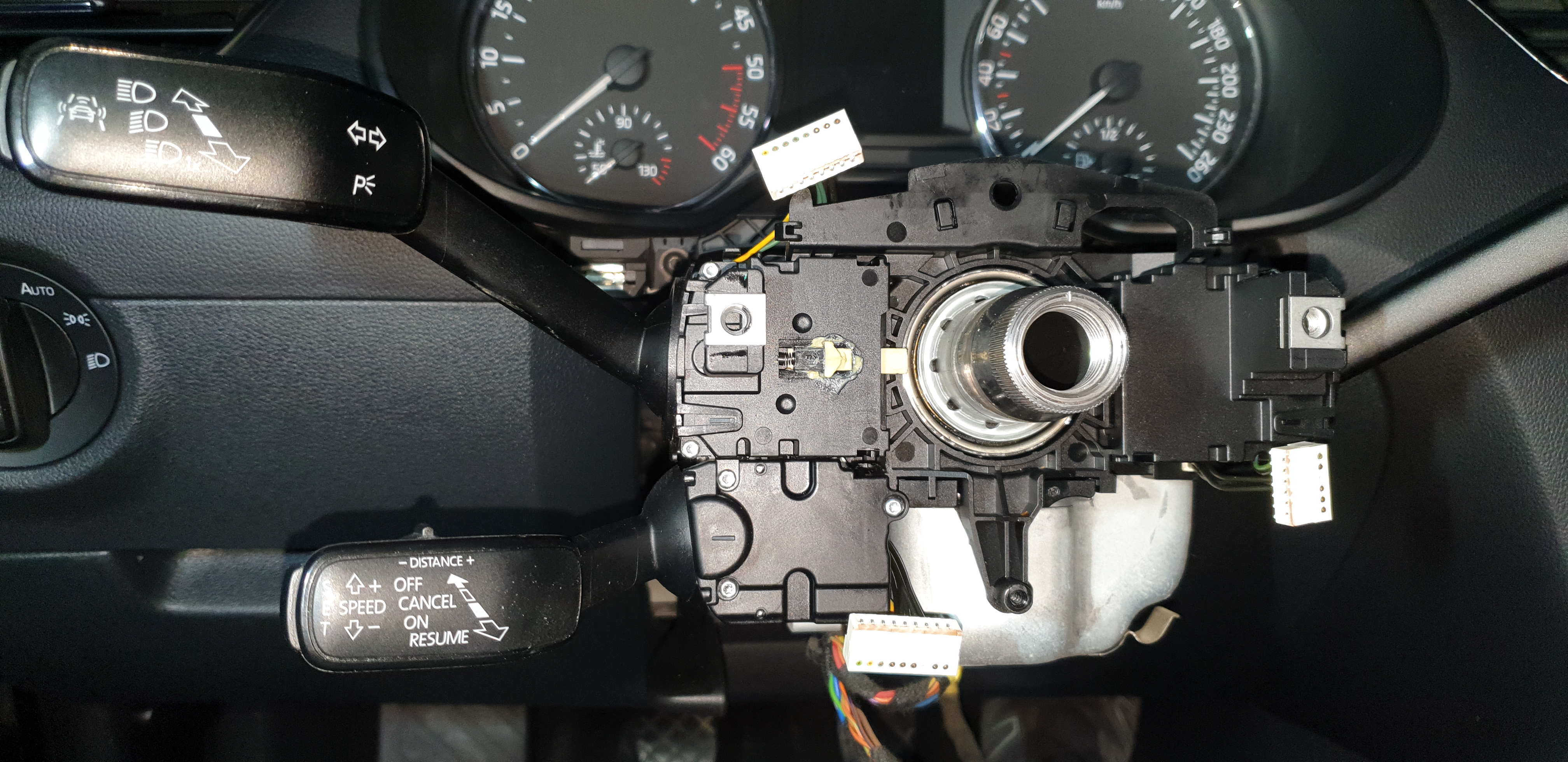

  11. First of all thank you for your answer 😃 here is the montage I have, does it help you to advise me?
  12. Hello, I am digging up the topic 😅 that I have ACC but would like to add the limiter. Who could give me the number of the rod with the mode button?
