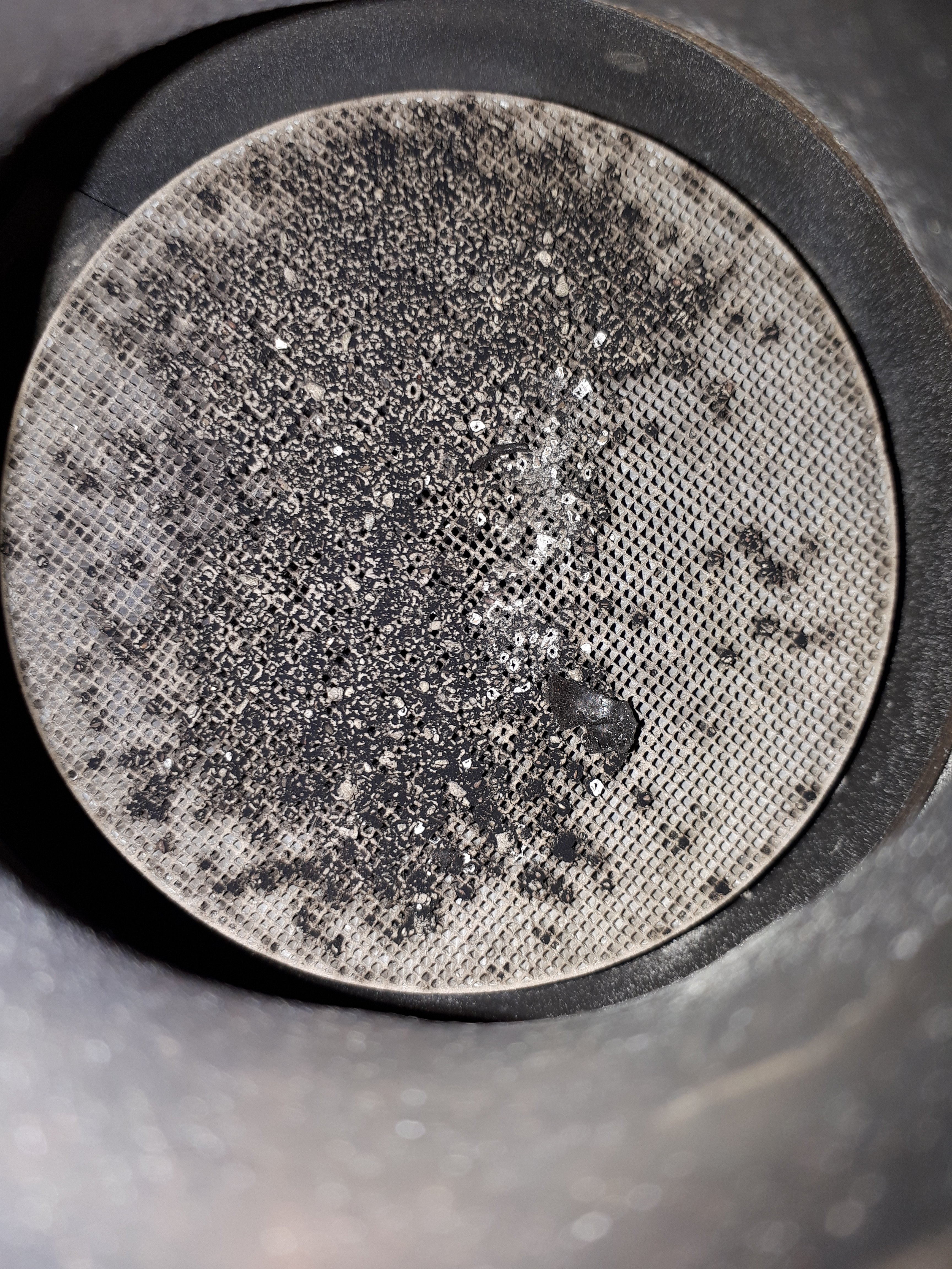

  2. I thought that I would update you on this as I have fixed the car. As discussed above I bought an exhaust pipe front to back so 3 bits, the single catalyst front section and the 2 silencer sections for the rear end. All purchased and delivered for a remarkable £182. They were fitted and the car drives nicely now. The forensic examination of the exhaust showed that the centre catalyst was clean and solid whereas the front catalyst was partly blocked as can be seen on the photo. It is clean on the downstream side. The new exhaust pipe information sheet indicated that this is possibly due to incorrect fuel or poor running. Well it does burn a little oil, but only a little. Attached is a photo of the top of the front cat through the hole it bolts onto the manifold. I am pretty sure that this part blocked catalyst prevented full revs and confused the engine management unit as the inlet manifold pressure sensor and throttle body positions were way different to the map in the ECU. Thank you for your help and advice and if anyone else has such an issue they can shortcut to the solution.

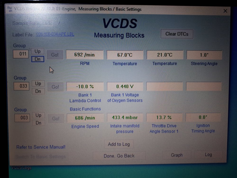

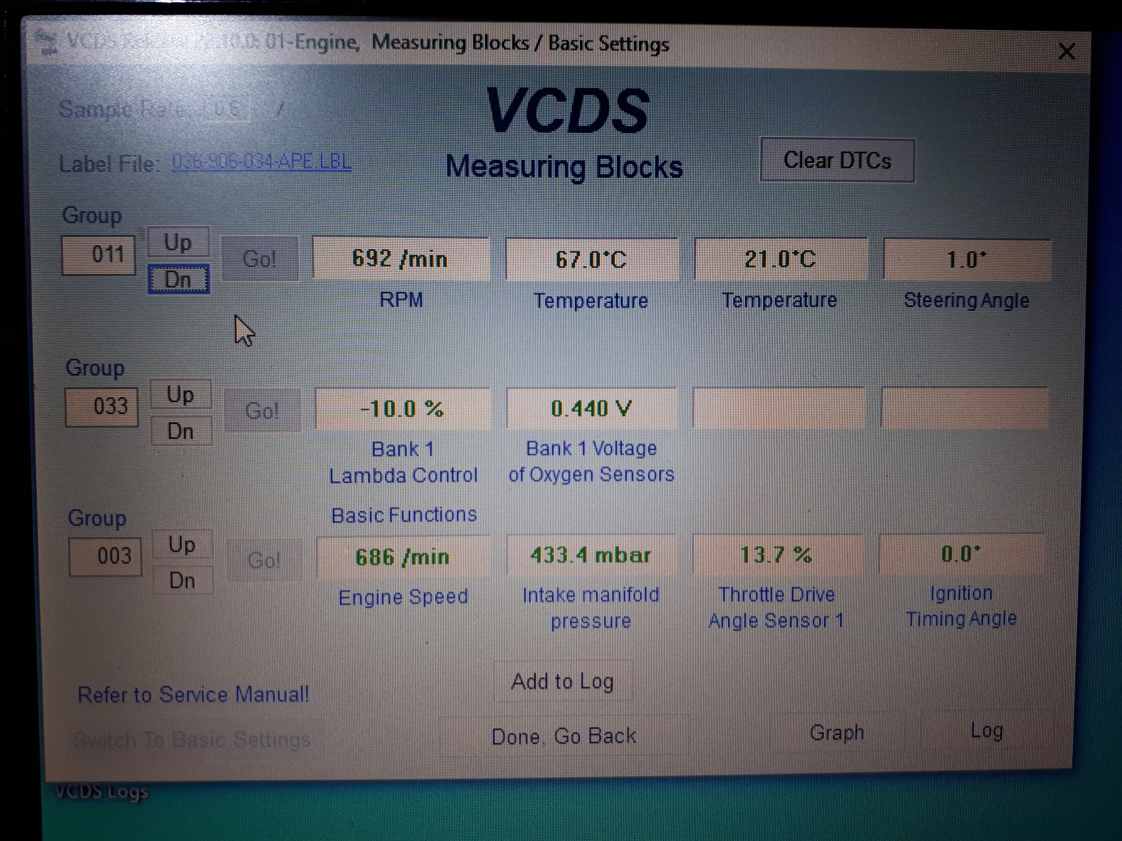

  7. Hello Pete and others. I have had the VCDS plugged in and run the engine after warming up and a quick blip on the throttle it settled into this state. My impression is -the Lambda is about right at 0.44V, I understand the desired Stoichiometric is 0.45V. -idle speed is good. -the inlet manifold pressure is 433mBar and is rather higher than the 300mBar I see on a different thread I caught on this forum. I swapped the MAP sensor for another and it is exactly the same and with the engine running reads high 900's which is atmospheric. So all sounds good with the sensor if not the result. -the Bank 1 Lambda Control of -10% means that the ECU is trimming the injection low to keep the lambda at close to 0.44V -the throttle drive at 13.7% no idea. With the engine running I tried wafting an unlit blow torch around to see it it would pick up any air leaks apart from finding that lambda control value drops to about -40% when playing on the throttle body it showed nothing. I tried pulling the brake servo pipe off the moulding below the throttle body and blocking the hole, no effect. Like the earlier message above from Pete it appears to be an air leak in the inlet tract but can I find it...... Any ideas ? Thanks John
