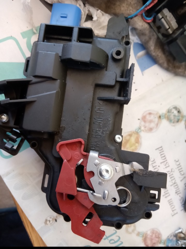

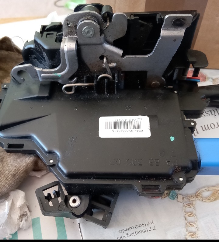

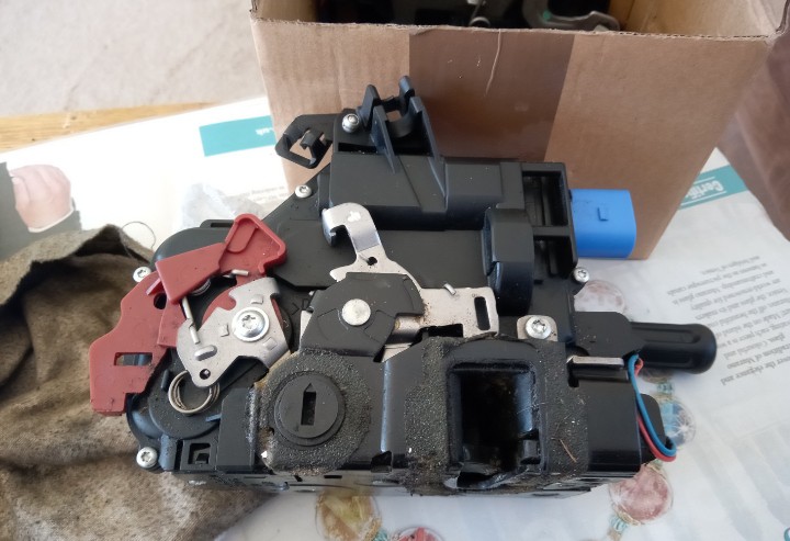

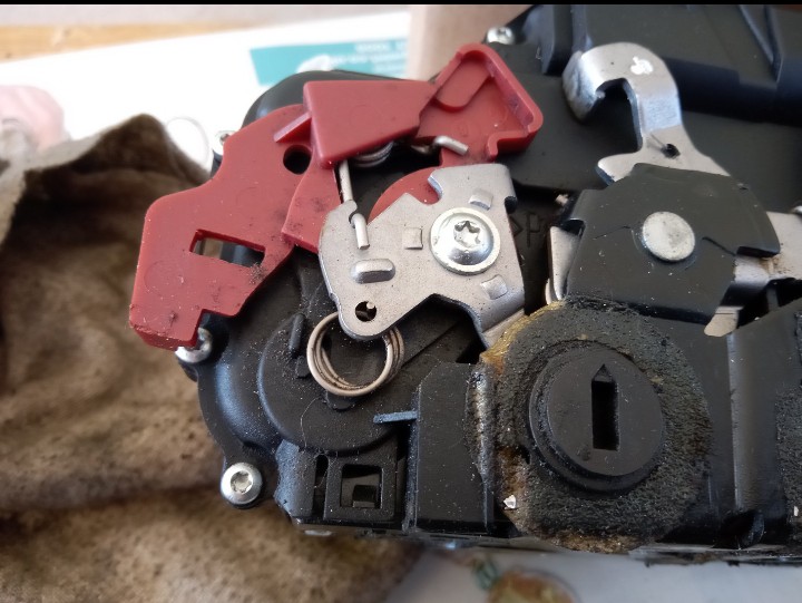

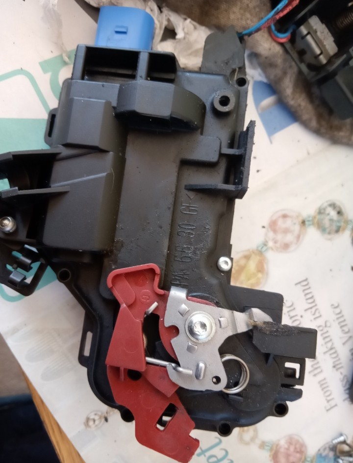

  5. It looks like the one I took apart with help from a YouTube video. Prob best to view that but take photos, there are a couple of springs that have to go back in the right place. The motor actuator housing comes away from the lock mechanism with a lever between the two. When bringing the two parts back together the lever has to be in the correct position to fit into the slot in the lock mechanism. I don't know what part you're replacing but in the three I've changed it seems to be wear and tear in the metal cam that drives the micro switch and in the plastic screw driven mechanism that operates the lock mechanism. I couldn't find exactly what had failed, just replaced the whole thing. There are a couple of plastic ramp clips that have to be released to pull the two housings apart.

  12. Just for info. Fabia 2007. Over the past three years I've replaced driver's door lock and both rear door locks due to them failing to release. Fortunately with all locks they could be 'encouraged' to release by banging on the door near the lock while operating the key fob. Bit of a pain as the internal panel is rivetted in place. I examined the old locks and the actual motor seems clean and spins ok. It seems to be an intermittent failure in the plastic cam driven by the motor thread. Also the micro switch cam was worn on one of the locks which affected tailgate opening and interior lights. Replaced with locks for about £22 off a well known auction site.
