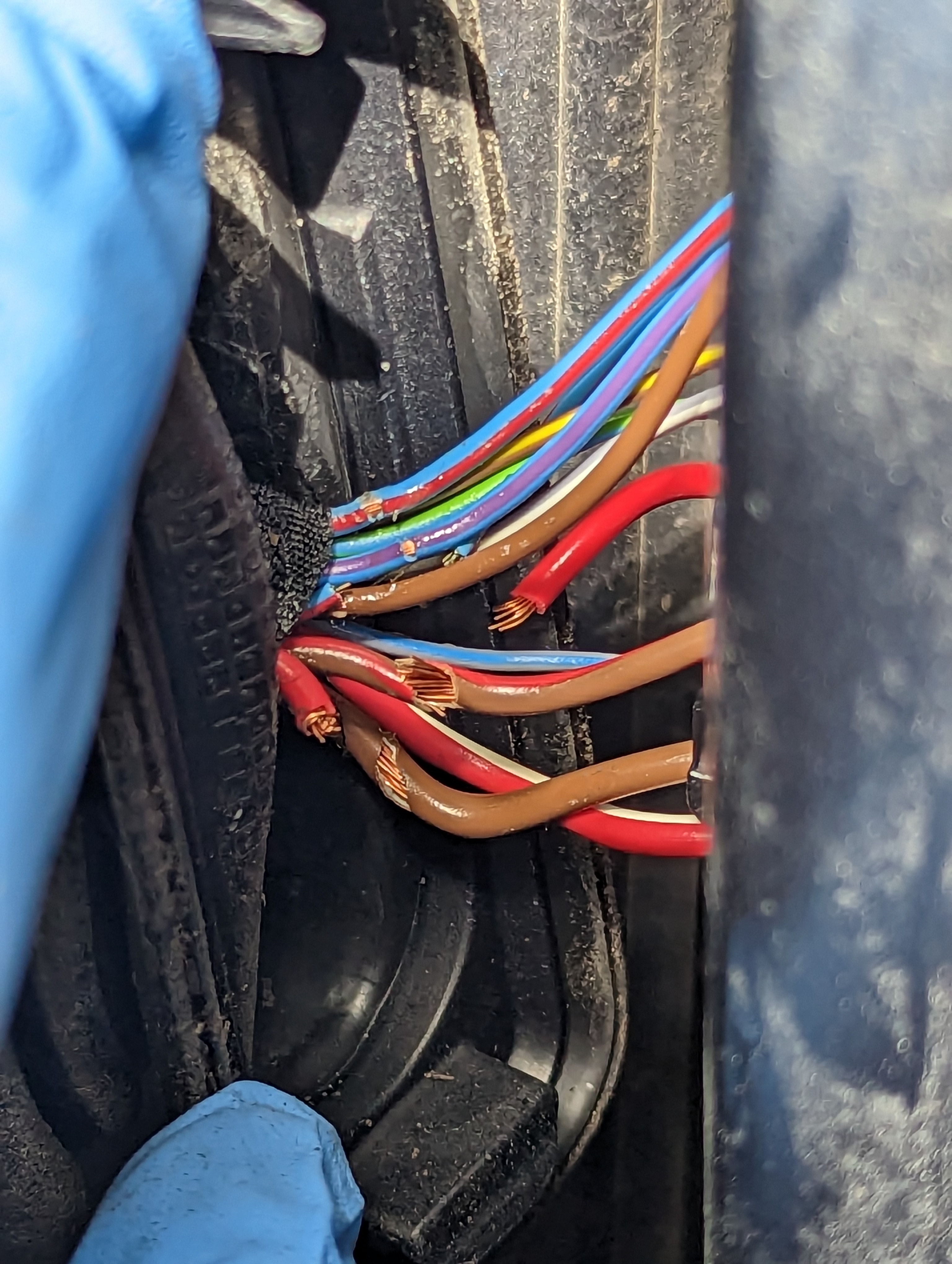

  10. @Breezy_PeteWell the driver's door loom looks fine. The passenger much less so. Picture attached. Two wires broken and at least 4 others damaged. Great design, but many thanks for the diagnosis ! On my Superb twinboot, once I had repaired it, I threatened all of my family to never let me catch them using it as a boot, but only as a tailgate (which means we can't use the button on the keyfob). Is there an way of stopping this happening again once repaired (other that climbing in through the tailgate) ? If I wrap lots of pvc tape round it is that just going to push the 'flex' elsewhere ? Why is the passenger door loom shredded and the driver's door loom look perfect ? Surely the use factor should suggest it should be the other way round ?
  11. @Breezy_Pete Thanks for that info. That is indeed a possible/plausible explanation. Sound like I'm on the joyous Skoda broken wiring loom hunt again. As a side question, I presume that the central convenience unit can be enabled for remote control on some models ? If the car were equipped with remote control central locking (in future) it would maybe provide easier diagnosis as it would provide a third way of locking/unlocking the car that independent of the door locking mechanism and door wiring ?
  12. @Crasher - ODBeleven reports no faults @toot According to the V5 it is a Fabia 1 HTP 70 first registered in September 2007 @Breezy_Pete Yes - I have read some of your discussions with other members about failure of the loom in this area. I am no stranger to problems of this type as I have a Superb II with the twin folding tailgate/boot which I have had to repair. I may well have to resort to this type of inspection, but I was trying to apply some logic before I started to 'poke and hope'. I can't understand why the two doors with keyholes would be able to control themselves and the rear doors and tailgate but not each other UNLESS there was some dedicated connectivity between these two 'master' doors that had broken. If so, I suppose that could be explained by your broken wire theory/experience ?
