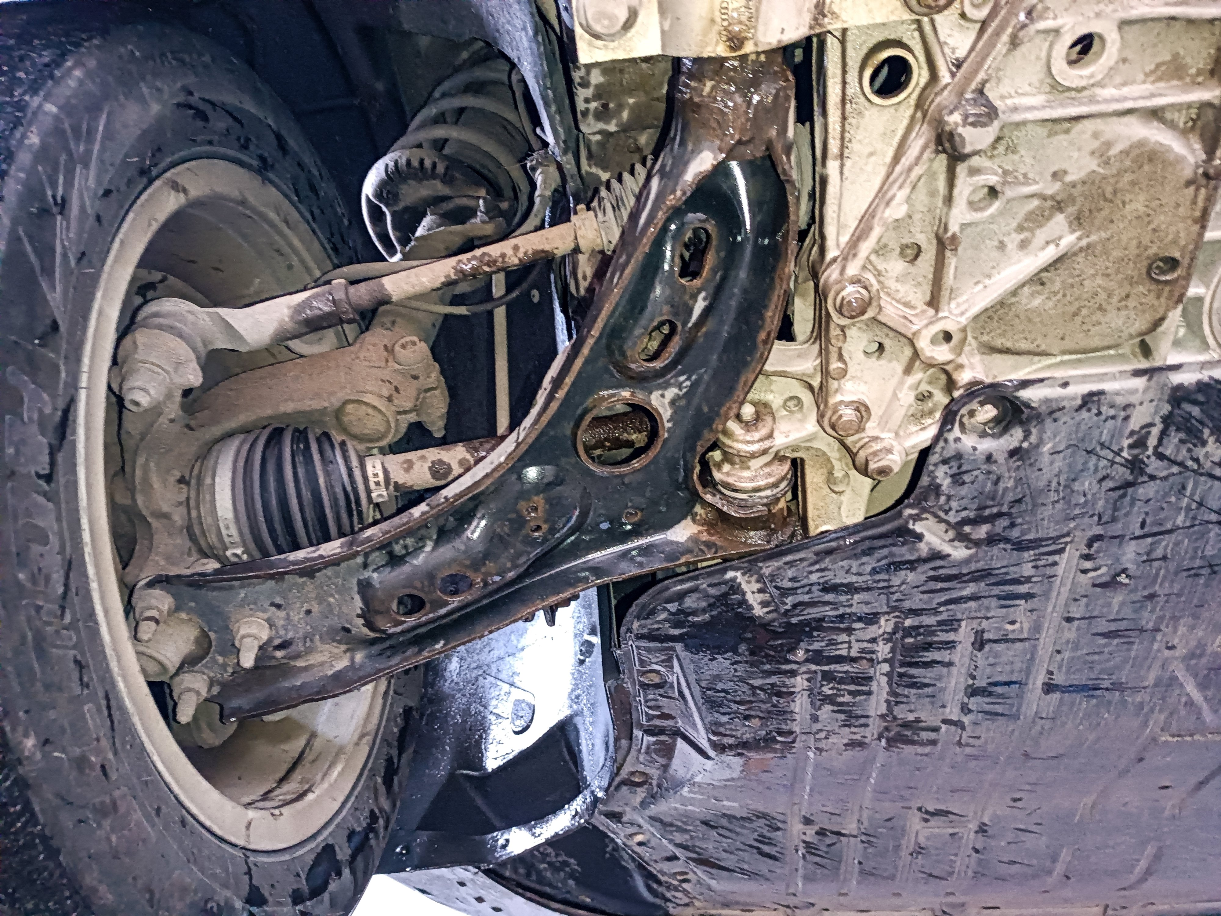

  3. Hi Breezy_Pete, Thanks for you thoughts - appreciated. One of my first thoughts were; that this might be the case. Whilst up on the ramps I checked the heatshields, nothing found. It's a much more of a metal to metal bouncing sound.
  4. Thanks for all your suggestions - appreciated. I got a big lad to bounce the car whilst I looked @ the top mounts, little movement & equal both sides. there's no play felt through the steering wheel, which makes me rule-out track rod end??. But something is causing the R tyre to scrub both sides. Left is normal. ... Now looking at all my typos, I really must write these posts a bit slower:
  5. Have a listen to the audio & share your thoughts. I've replaced both wishbones & anti role bars a couple of months ago. This rattle started about a week ago & is progressively getting worse. The right hand tyres is wearing on the edges, both inside & outside. Turning the teering wheel on a flat road doesn't create the sound. Only when driving over drains or potholes. I've had on ramps and had the wheel off. I can't see anything obvious Skoda front suspension rattle.mp3
  6. If your unsure whether its a faulty bush, try this test. If your wheel moves this much the bushes are knackered. VID20260311155157b.mp4
  7. I have today discovered the cause. The front bush on the left Wishbone / Suspension Arm is knackered. I've ordered a replacement. Febi 39489 Wishbone / Suspension Arm. £34 +VAT from PartsinMotion. https://www.partsinmotion.co.uk/car-parts/steering-suspension/wishbonesuspensionarm/febi-wishbone-suspension-arm-front-lower-left-39489-detail? I post this just in case anyone else lands here after searching Google for rattle under car or similar. On the 1.6 TDI 105bhp it's a steel sheet part. NOT a cast iron part. I order the entire wishbone, complete with bushes to avoid me having to fight with pressing out the old bush. Life's too short. And I order new bolt too £6. Stay Safe!🙂
