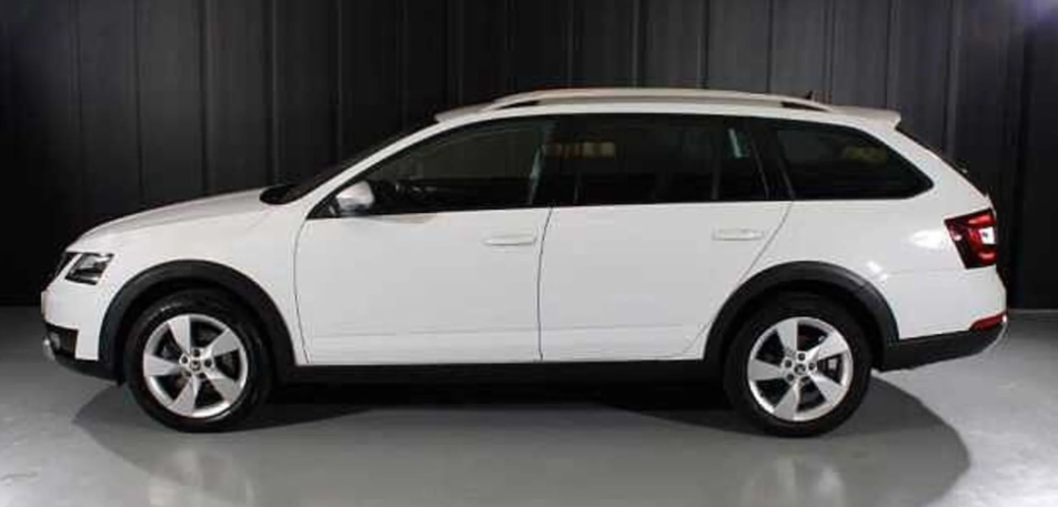

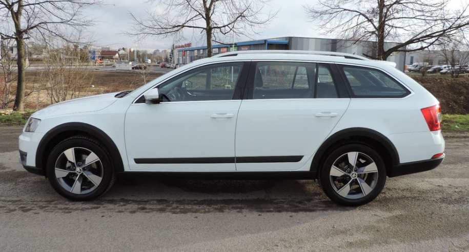

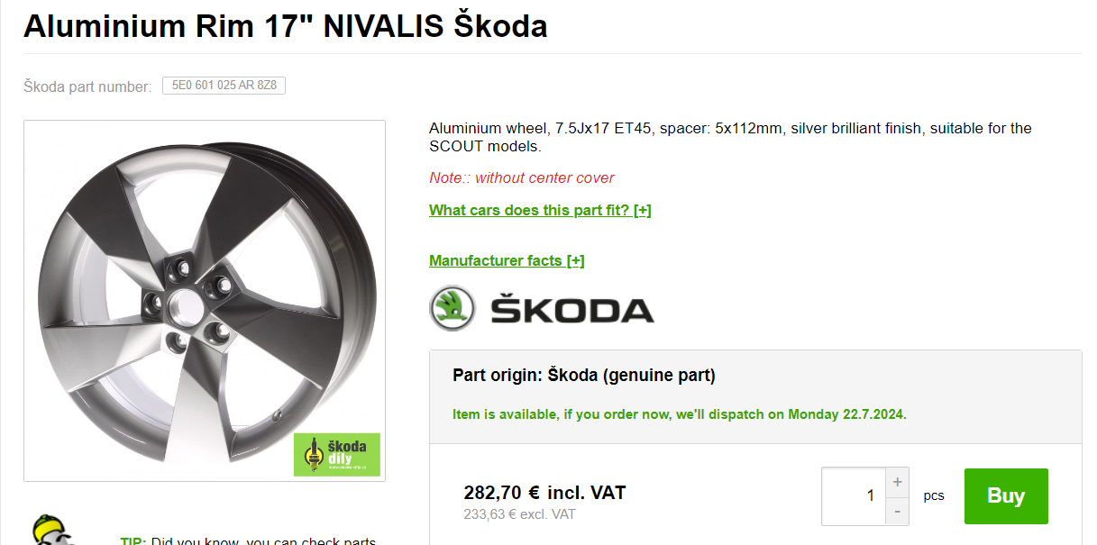

  4. That's awesome info, thank you! Doing some research I found out that Scout3 facelift do actually come out with 7.5 ET45. (Scout FL was NOT imported in Australia, hence I didn't find much before really looking into it) Below is the comparison btw the Nivalis 7 and 7.5: 7, ET45 (same I have) Not my car - but it looks the same 7.5 ET45, on FL models 2017 onwards I didn't realised FL models don't have the door trims - much more balanced IMO, this gives me ideas for the future! There are also 18x7.5 ET43 for Scout3 FL (Braga alloys), and Golf7 Alltracks (same chassis and suspension of Octavia Scout) come with 18"x7.5, ET45. I'd say this all corroborates 7.5 channels with ET40 to 45 does fit no problem

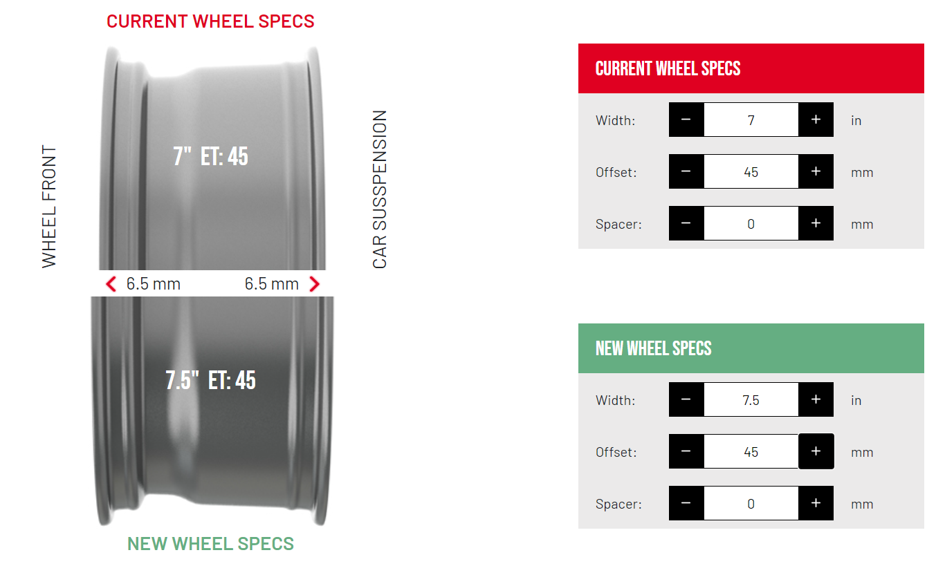

  5. No, I have 45 now. I think keeping 45 on a 7.5 shouldn't be an issue: Anything 40 to 45 would also fit easily I think, and make it appear slightly larger:
  6. So no problem with either of the inner designs (trapezoids vs circles?) are they fully interchangeable? Yep, with 7.5 channel I'll have: ET 45: around .75cm extra each side of the rim (current nivalis are ET45 but 7inches wide) ET 40 to 45: most of the extra rim surface on the external side. I'd prefer this actually, I think the wheel arches would look a little fuller - especially the back ones.

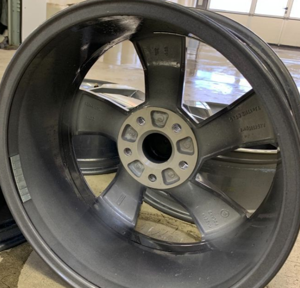

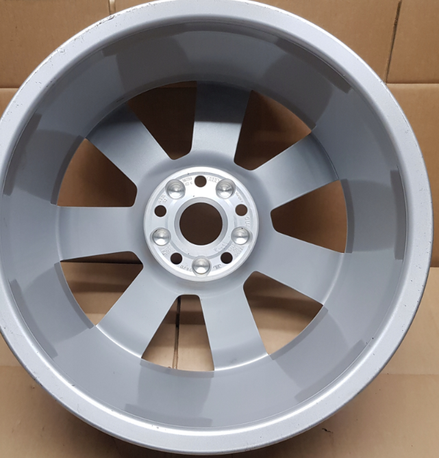

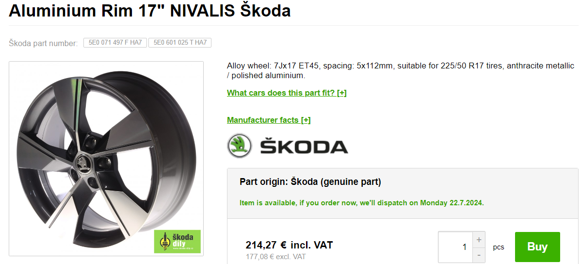

  7. I'm looking to change the original Nivalis alloys on my Scout with something else; I was never a big fan of the 5 spokes/star-ish design, I prefer 7+ spokes designs in general. I'm happy to keep 17s as I prefer a softer ride and don't mind some light off detours on outback tracks every now and then, but will increase the channel to 7.5. I realised most of the OEM VAG wheels are pretty much interchangeable as stud diameter (112) and bore (57.1) are the same - so anything with ET40 to 50 should fit with no issues. My concern is the inside part of the rims - I found there are 2 different design/patterns around the bore and studs. My current Nivalis have some sort of trapezoidal spacing as per the picture: Some of the Audi and VW rims I like have instead circles: Can either be fitted without modifying anything? More in general, is there anything else I should consider other than stud/bore/channel?

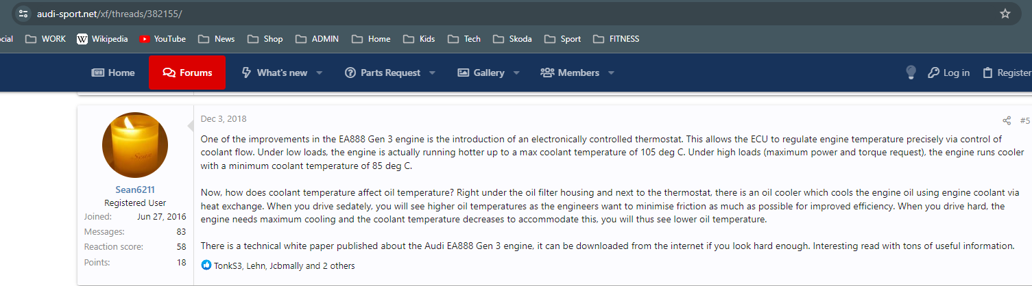

  10. I found this on a Audi forum - I wonder if that's what makes the oil temperature changing. It makes sense to me.
