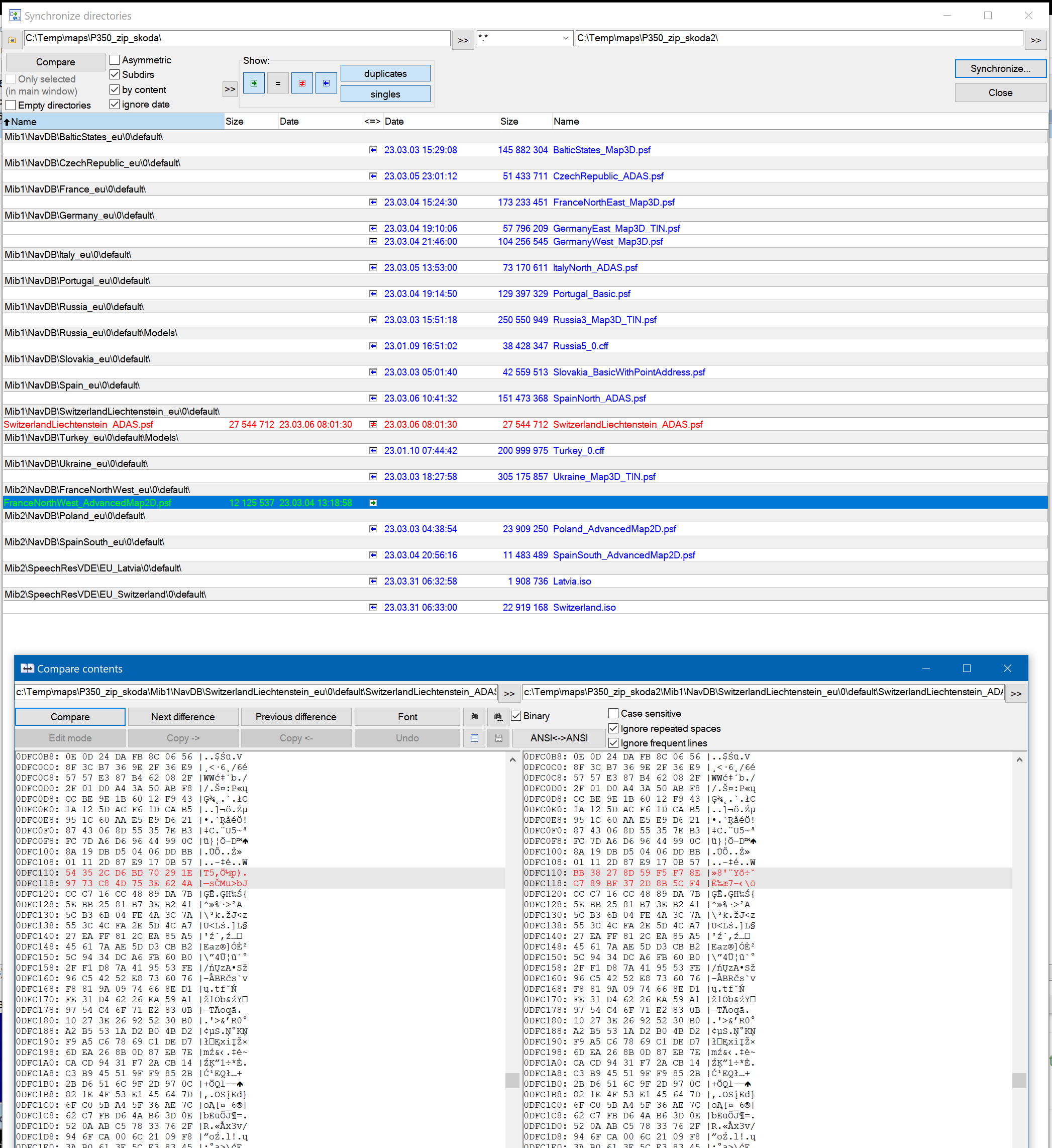

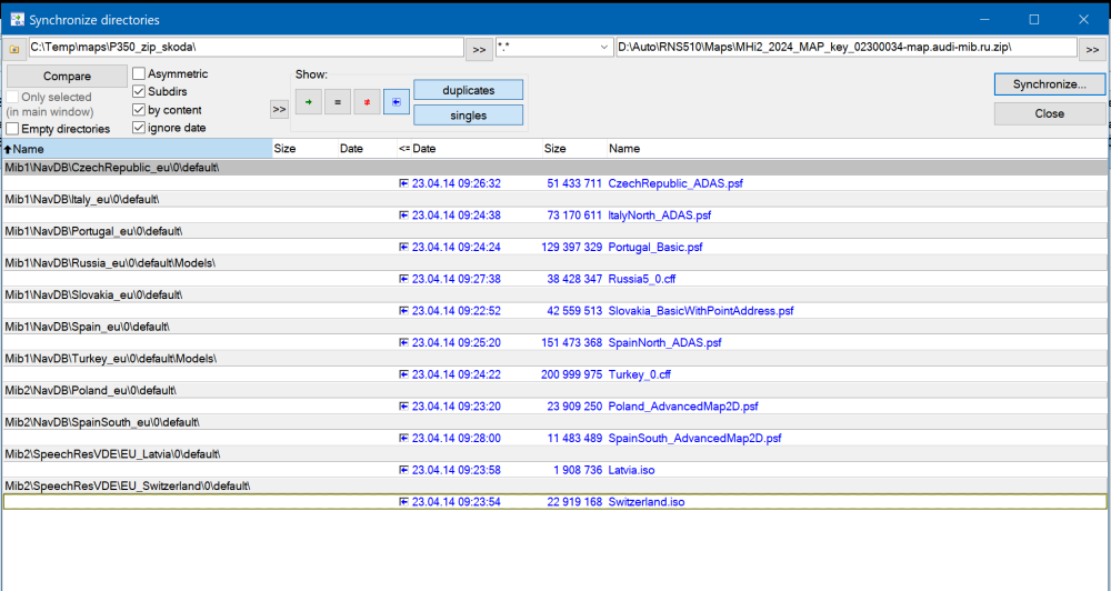

i did compare archives -
in Audi were 11 extra files
in Škoda were 369 extra
but files, which are present in both, have identical content with just different Date Time

interesting, that 11 Audi files just partly covers damaged in Škoda's zip, which were skipped during extracting
\Mib1\metainfo2.txt presents only in Škoda's zip
\Mib2\metainfo2.txt contains huge list of diffs

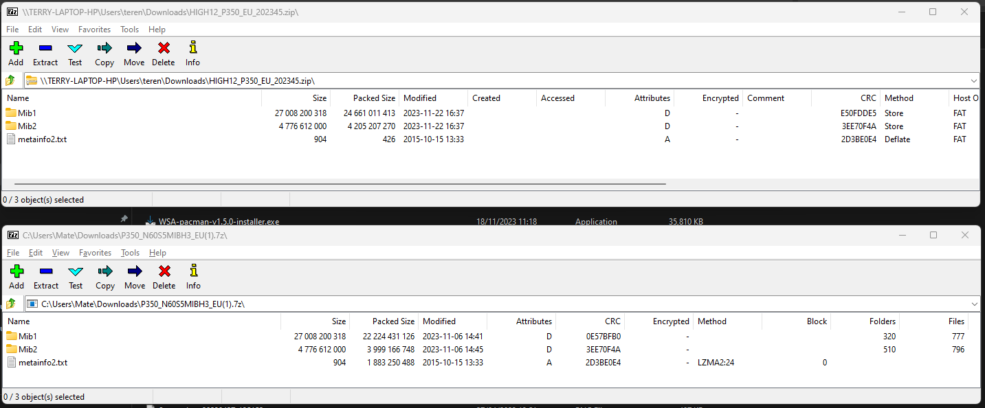

Here's my unscientific quick and dirty comparison between the Skoda and VW files:
Unzipped the file size is the same which suggests it's the same file. You then have to workout the SLA1 check....

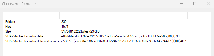

I did do the SHA256 check on the groups of files, and they are different 🙄. Basically the byte size is identical but the contents are different between Skoda and VW.
What I get on the VW one using the 7zip CRC check.
Scholars of this process you use
It's like a constructed finger print of the files.... they are different. Probably Skoda has yet to fix the issue ?.

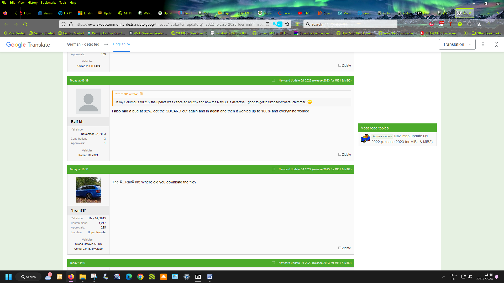

Interesting page on the German Skoda board,,, failing at 82% on the Skoda file is common... pull out and push the SD card back in :). I'd stick to the VW link.
