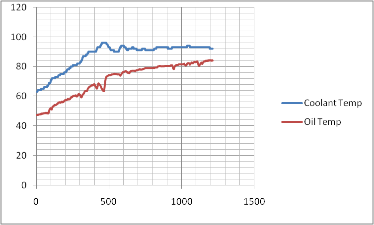

I know that all EA211 engines have two separate cooling circuits, cylinder head circuit stat opens at ~ 87C and the cylinder block circuit stat at ~ 97C, I have a 2019 Polo 65bhp petrol engine with two stats, and have noticed a similar drop in oil temperature around the time I would expect the cylinder block stat to open, the oil temperature then increases steadily again, no oil cooler on this engine.
The 0 to 1500 reference scale below would roughly represent 1500*0.75, 1125secs or 18 minutes or so, the luboil temp dropped ~ 7 minutes after moving off, it eventually rises to 95C to 105C depending on engine load.
