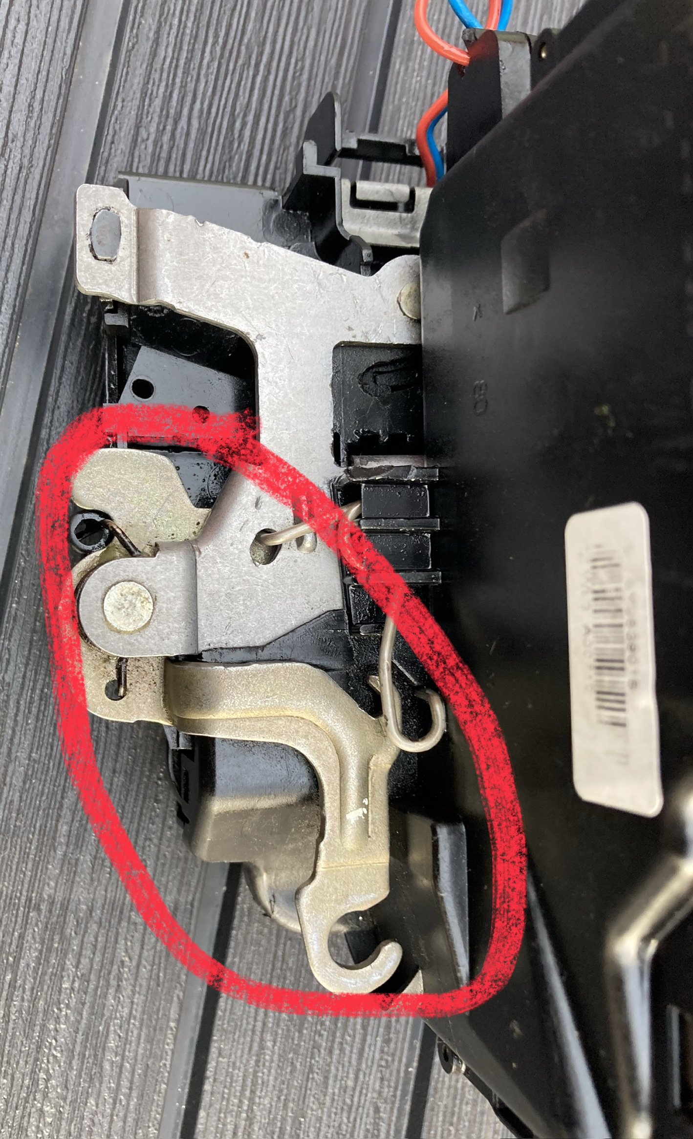

  1. Hi Andrewtyre, I had to use quite a significant amount of force on the lever before it released the lock. It was quite easy to push to a certain point then for the last 10mm it did take a decent push. Other people have more experience than I in these matters and I would appreciate their wisdom on this, but if I was in your position I would use a meter to check on the continuity of the wires and any that are suspect I would repair. The rubber boot between the door and car body is kept in place by fragile plastic clips so please be careful when removing. If the clips do break, use a mastic to ensure it’s waterproof. Sorry I can’t be of more help

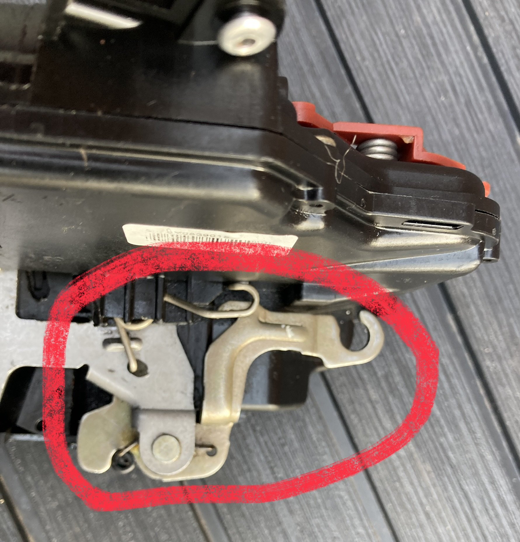

  2. It turned out that the problem was within the unit itself. The actuator was working intermittently but wasn’t able to exert enough force to unlock the door. I used a large screwdriver and using quite a bit of force pushed against the lever circled. This unlocked the door allowing us to to remove the faulty lock. I hope this helps someone and thanks to firejinx. Kind regards John
