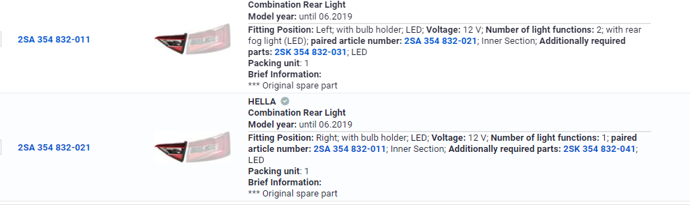

  5. Problem nearly sorted. Lamp. Is working i checked on other superb same as mine. The problem I got its not working on my car. All lights working apart of fog light. Don't know if it headlight switch or cables. But headlights switch is damage I accidentally use too much power and knob turned 360 degrees and fall. How to remove the headlight switch without that hob?
  6. I know that. It's English car. But as I said I contacted directly to company who produce those lamps and they said it only nearside lamp (left one) had a fog on it.
  7. Hi Guys, I got Skoda Superb mk3 2016 hatchback diesel 2l 150bhp. I done the MOT but got some minor warning. They said the fog lights not working but the problem i got i try buy new lamp because can't change the bulb because its led lights. Then I try to find replacement part but the problembi got its only for left rear tailgate lamp with Fog function can't find any right lamp. I even contacted the HELLA who produced those lamps directly and they states that fog light is in left lamp not right. PLEASE HELP ME
