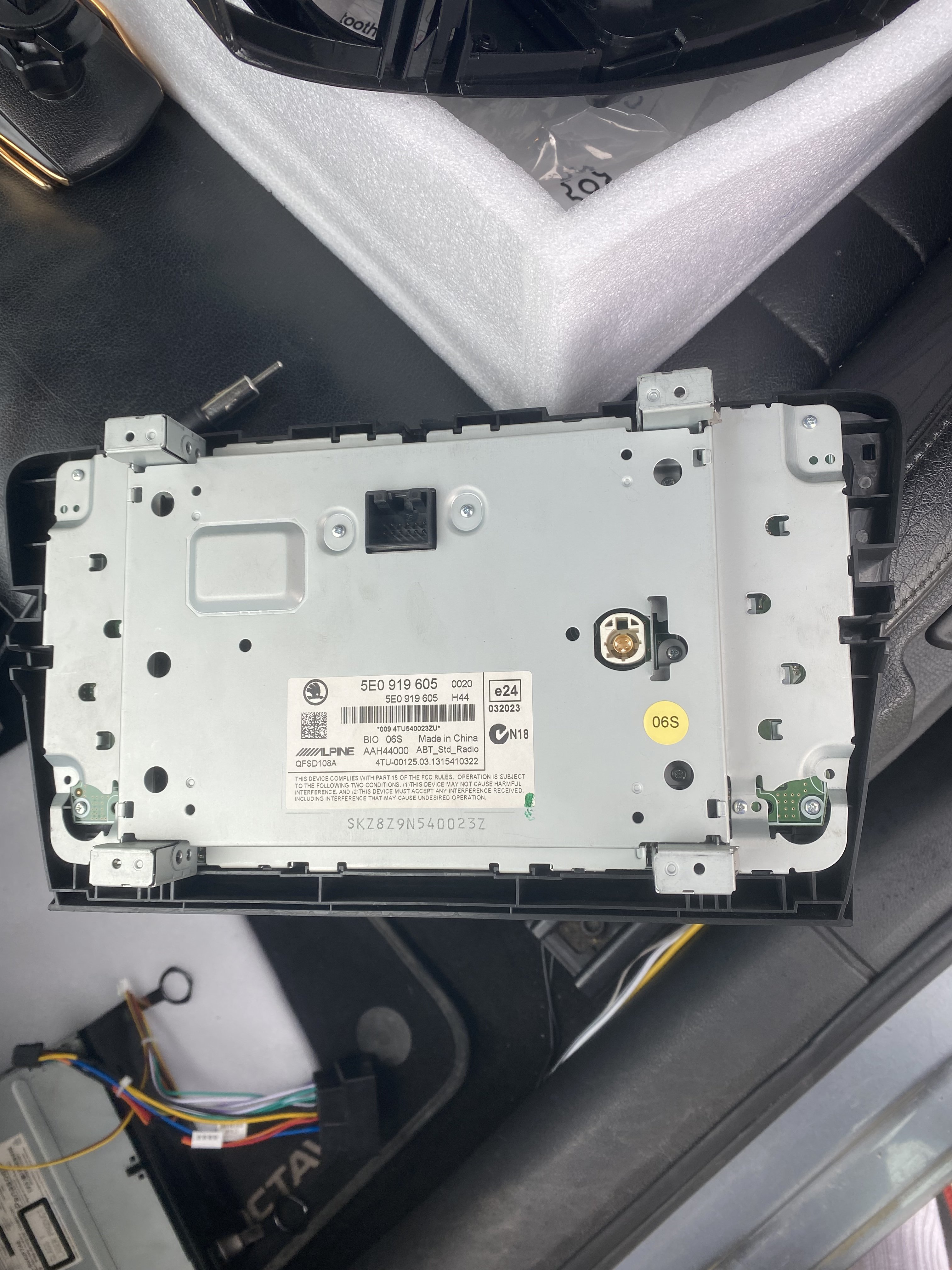

  2. Hey struggling with this rn, how did you manage to get enough room to connect the android head unit? Plug socket is on right hand side of the Android unit and causing to be a right nightmare, need about another 1-2 inches if even. Any ideas?

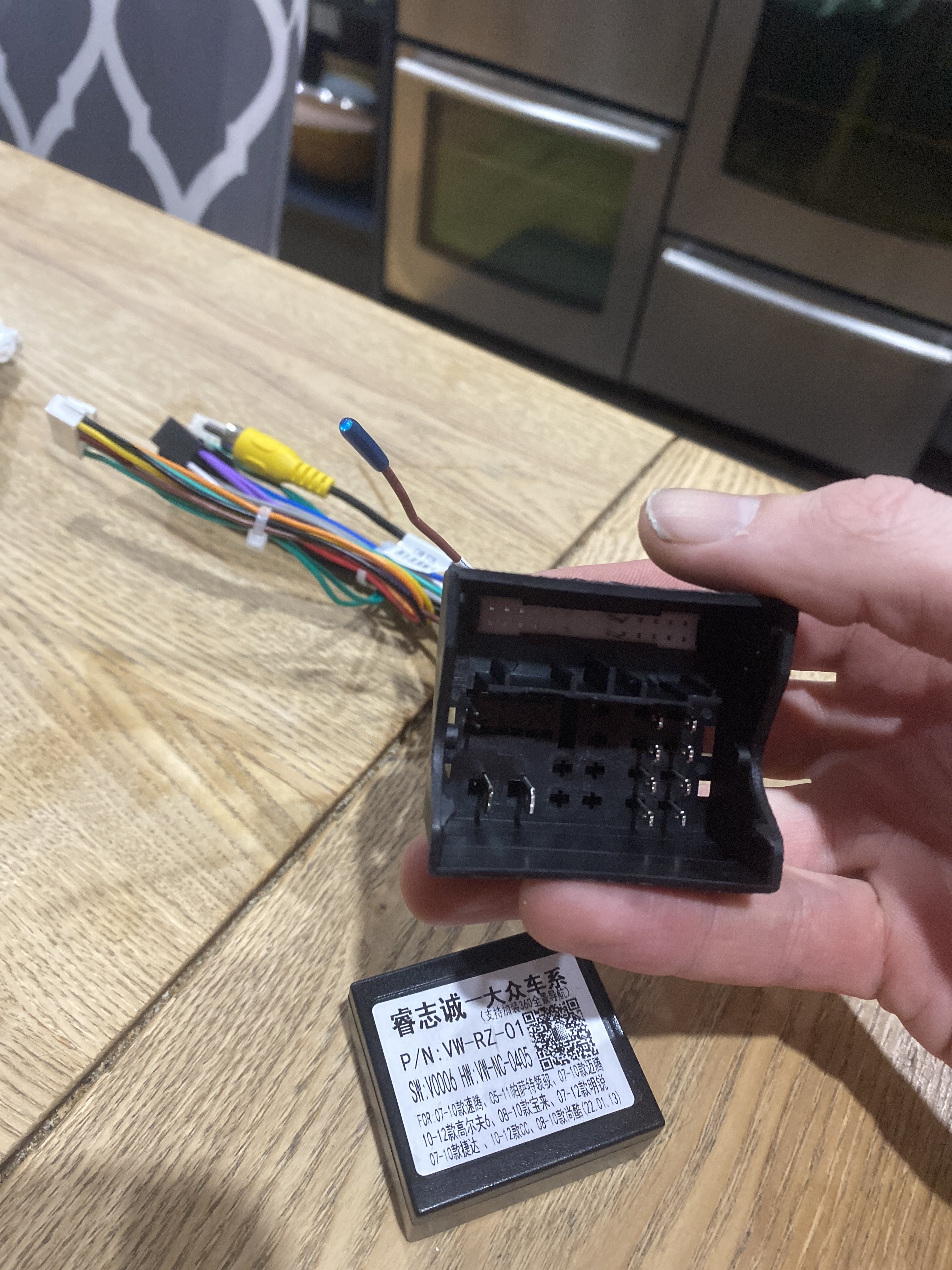

  6. Thanks for the reply! This is the CANbus yeah? And if this was the wrong one would this stop it from powering on and **** yeah?

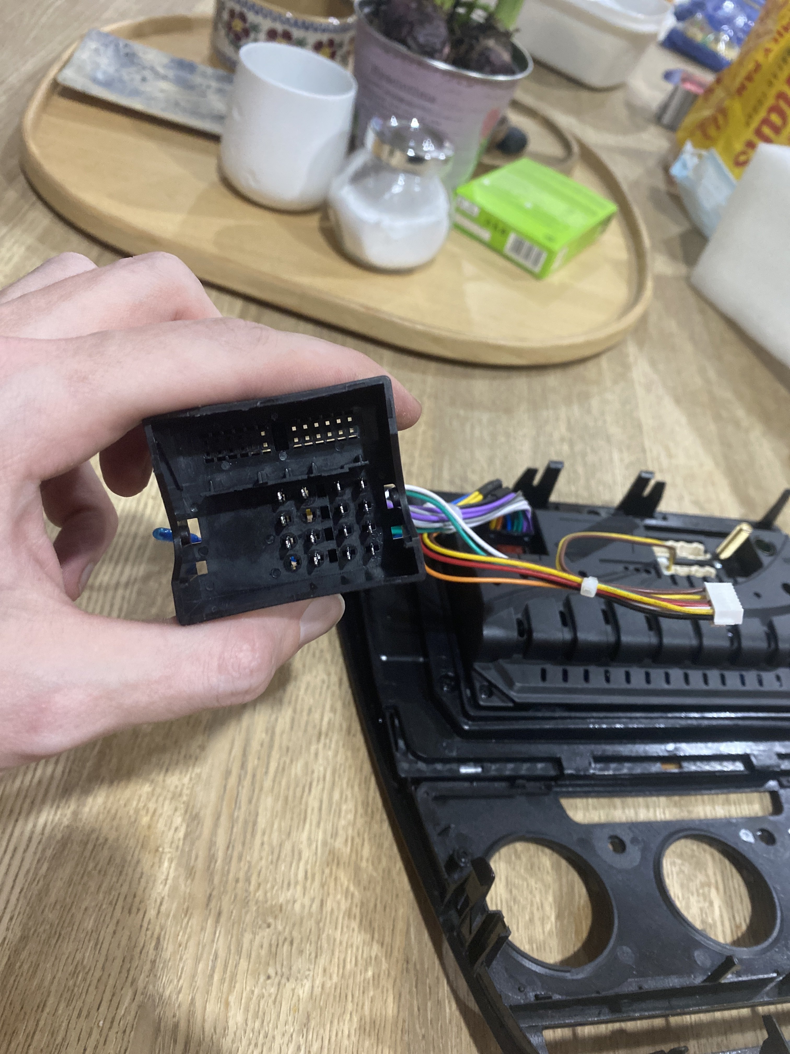

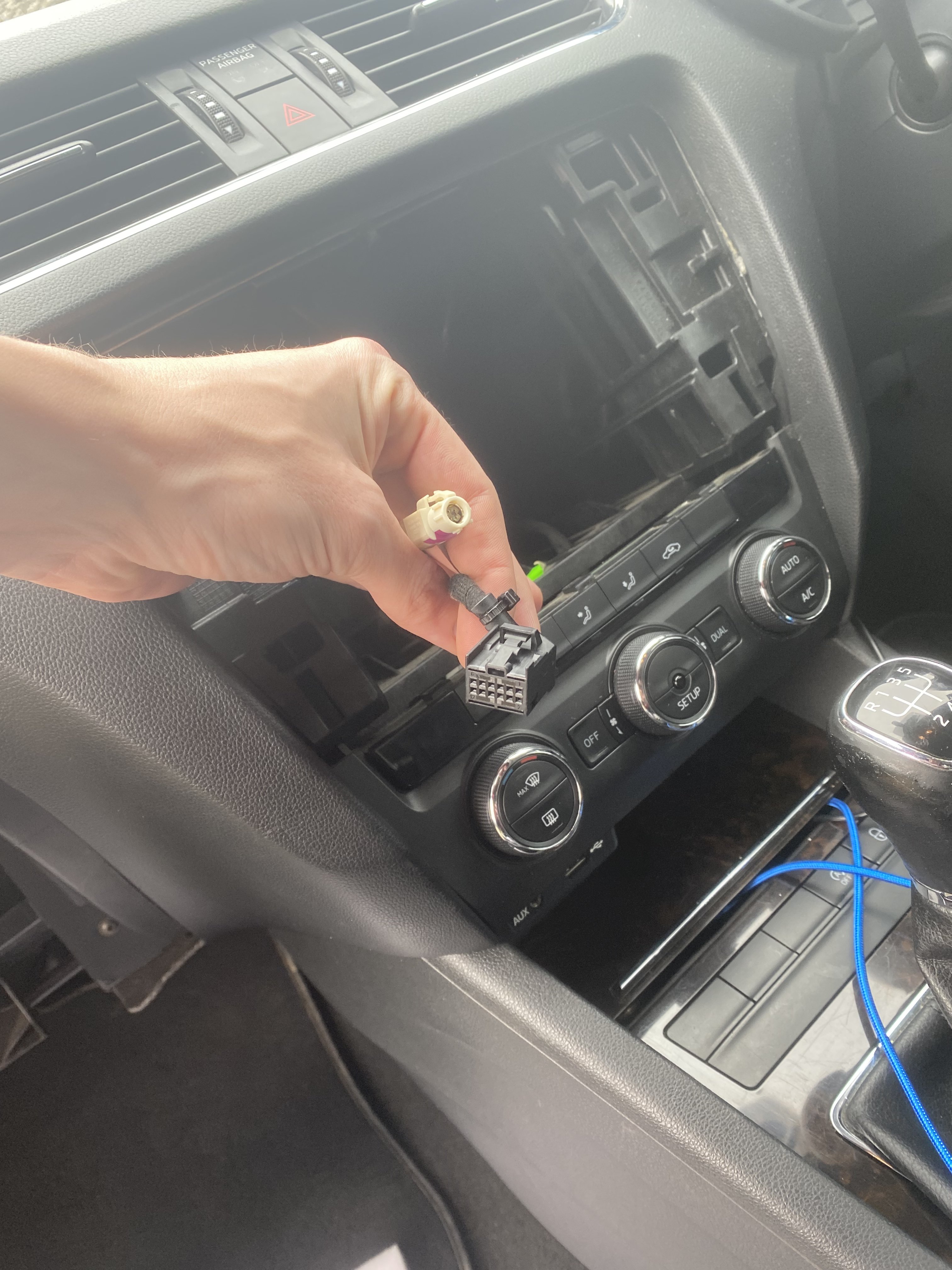

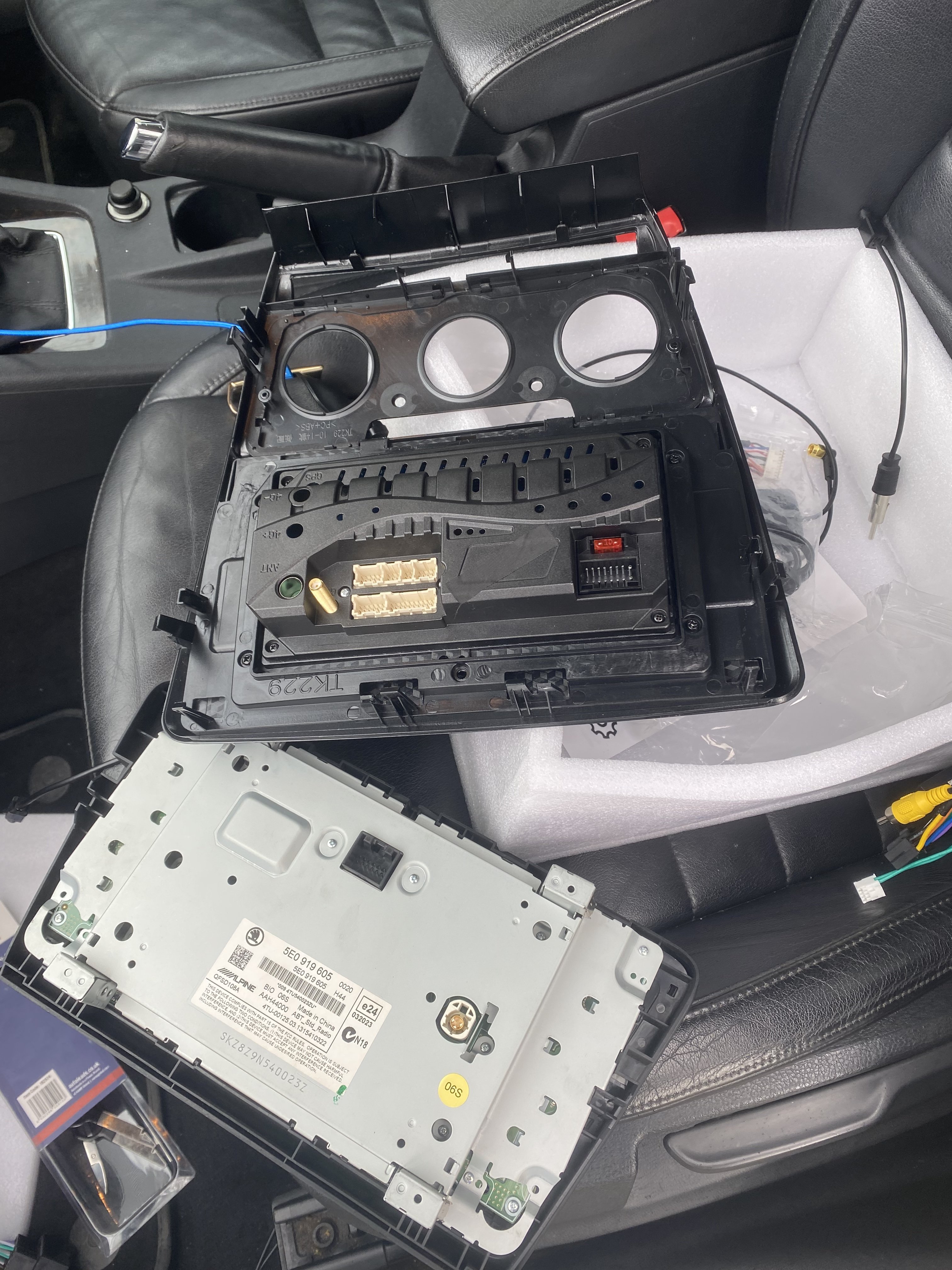

  9. Even more lost now ahah, so I have all of the bolero taken out, the glove box unit and the screen itself, so just cables left the big connector that hangs from glovebox one with numerous different connections that the bolero unit would usually connect and then as pab mentioned the 12 pin black and 4 pin white is in the centre console for the screen. So I don’t want to be connecting to the glove box at all and rather connect to the centre console cables? Is that right cause would make sense as these the cables that do not fit and will need an adaptor.

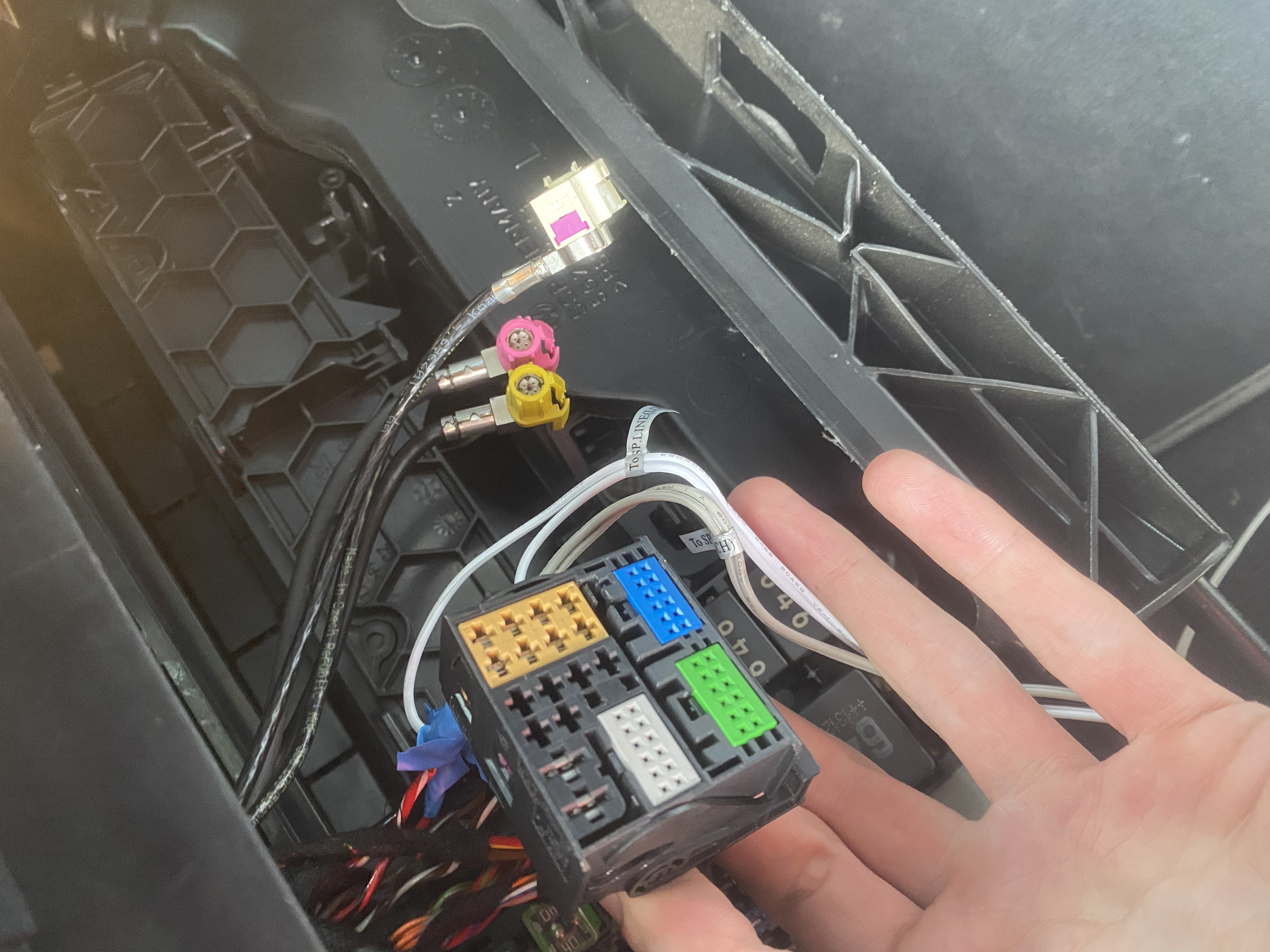

  10. Thanks for the reply pab much appreciated! So both cables I have are the wrong ones and I need a quad lock is that right? Or is one of the cables I have to connect to glove box unit sufficient?
  11. Yeah fits perfect, just need to remove the trim around the ac plugs and it just clicks in. I am only looking through videos now and didn’t actually turn on the ignition when I had it connected at first, not holding out that that was the reason why because current bolero system turns on just by switching on the electrics, so not hopeful but will try again regardless. As to why there is two main connections I have no clue either but did try both also, again not by turning ignition just by turning on electrics.

  13. Yeah so the Android unit is just by itself has everything built in processor etc and these are all of the cables provided with - not sure whether split unit system or not but the power cable for the android unit is connected to the glove box and still no power going to - and both cables in mid console where usually connects to bolero screen are still left unused.
  14. Many thanks for the reply Mark! I have no probs connecting to wire under glove box etc but there is still no power going to the screen. I must be missing some sort of adaptor as under the glove box when I have the connection with CANbus connected - there is still no power getting to the screen. Headwrecker it is!
  15. Skoda1996 started following pab567
