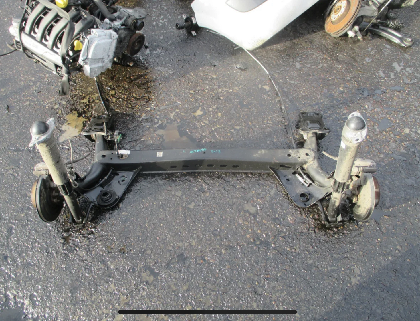

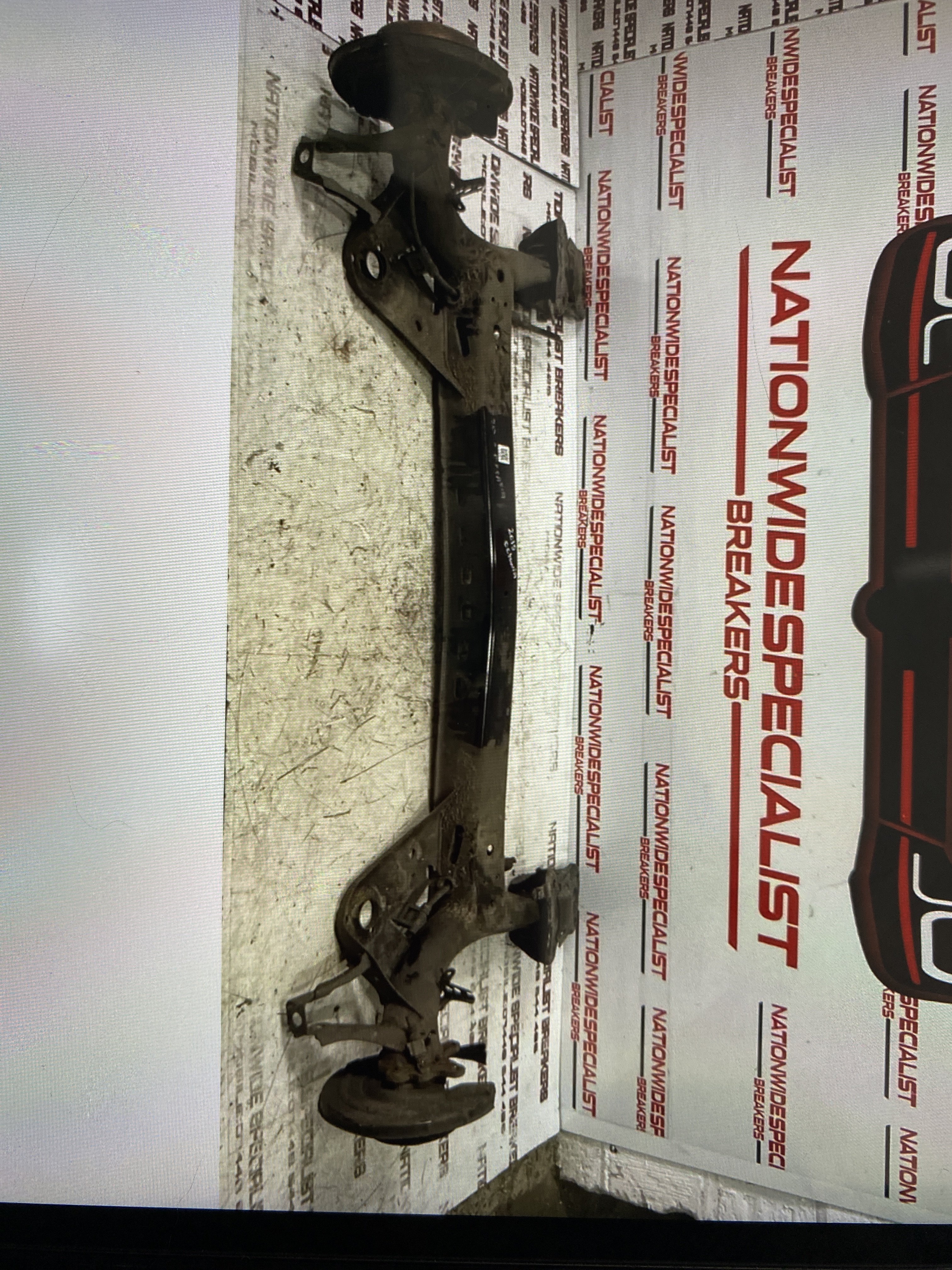

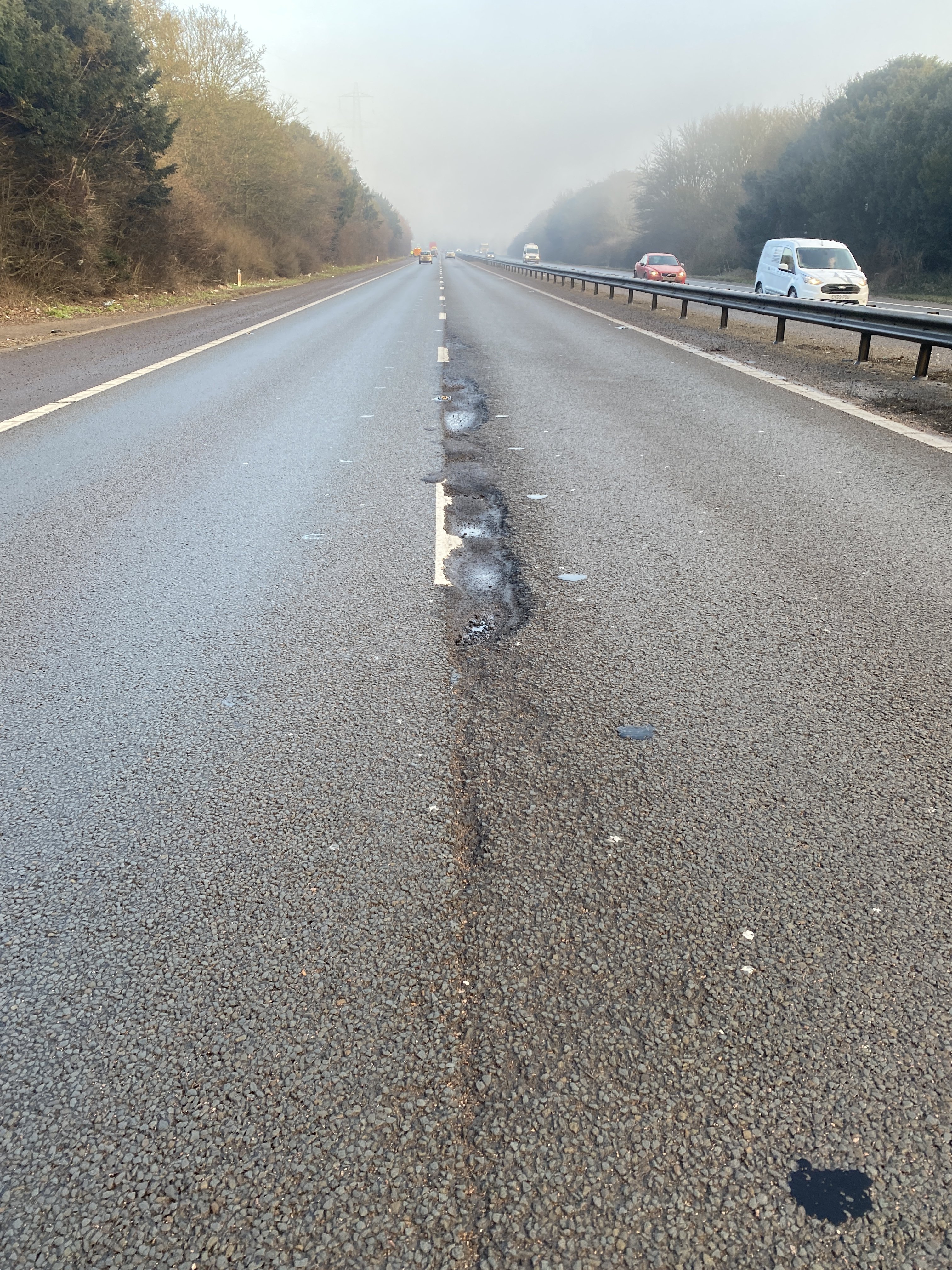

  3. J.R, you are absolutely right never thought a pothole can do such damage. Yes it was a hard one and did a lot of damage to my wheels but never thought the axle would be damaged. I will buy a second hand and get someone to replace it for me and take it from there. It seems that everyone thinks the pothole created all this. Here is the pothole I hit. also attached is the axle I will buy and have installed.

  5. Time for a new axle I guess. If you mentioned a pothole could have caused that then yes I hit a pothole on the A1 back in Jan. still waiting for NH to reimburse me. Squashed the NSF wheel and punctured both near side tyres. That could be the culprit.

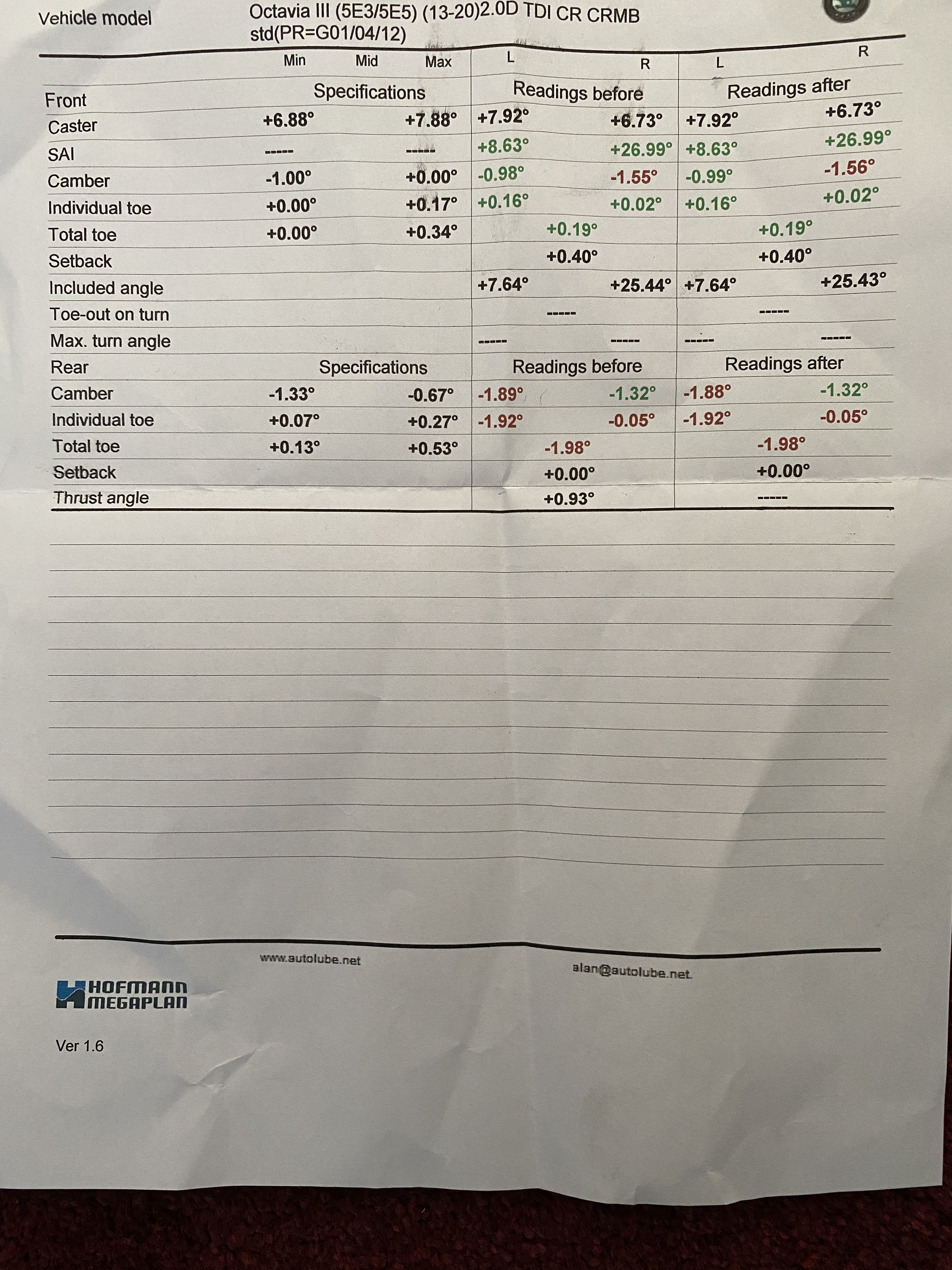

  12. The correct values should be 1’32. I have 1’89. What could cause this?
  13. Dear All, thank you for your comments /input. I had actually a blow on the A1 at 85mph but nothing happened. Pulled over and changed for the spare. All garages I have been have told me that I need a new axle. I booked it in so that Skoda will confirm that this is the case. I have replaced the tyres again yesterday to a set of brand new Bridgestones. They won’t last because i am doing about 3-4000 a month. These are the current values given to me yesterday. What is weird is that left and right are identical almost. I attache a photo of the axle as well. You can all see there is nothing to adjust. Even if I buy new shocks and coils not sure this will fix the issue. Seems that no one had this issue otherwise someone would have come up a solution.
