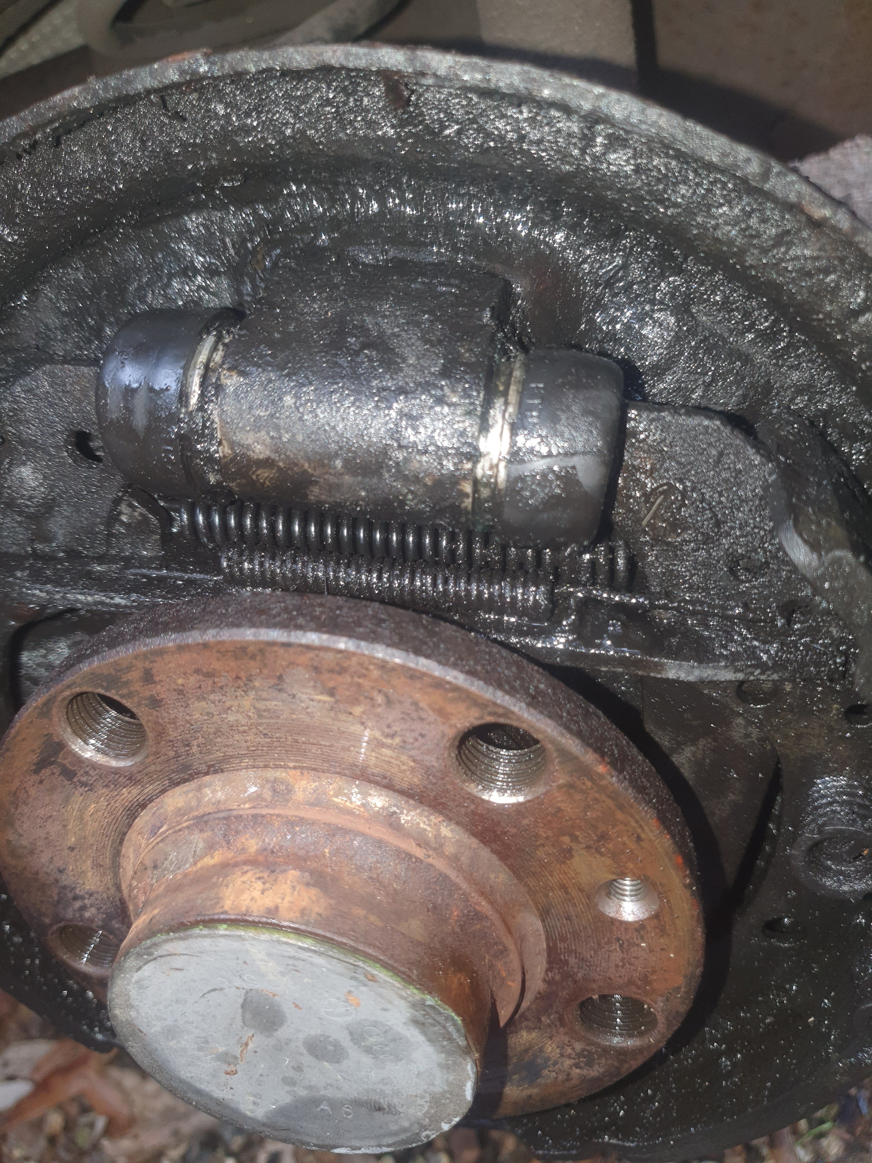

  8. Just replace the wheel cylinder and put the drum back. Terrible noise and almost no brake force nor handbrake. Disassembled again and found these bits knocking around the drum. Any idea where they go? Thanks Justin

  13. brake cylinder seems to be the answer! I should have guessed given that it's more or less the same in French. new one arriving tomorrow.
  14. Hello all I've been suffering a loss of brake fluid and find that there's fluid leaking through the nearside rear brake drum. Being a clever fellow I've diagnosed this fluid as brake fluid. The seals on the outside of the hub appear dry. And the inside of the drum was a nightmare of sludge. It looks to me as though the brake fluid is coming out of the rear boot. But that could just be gravity. What is the part called in English that I need to replace please? Thanks Justin
