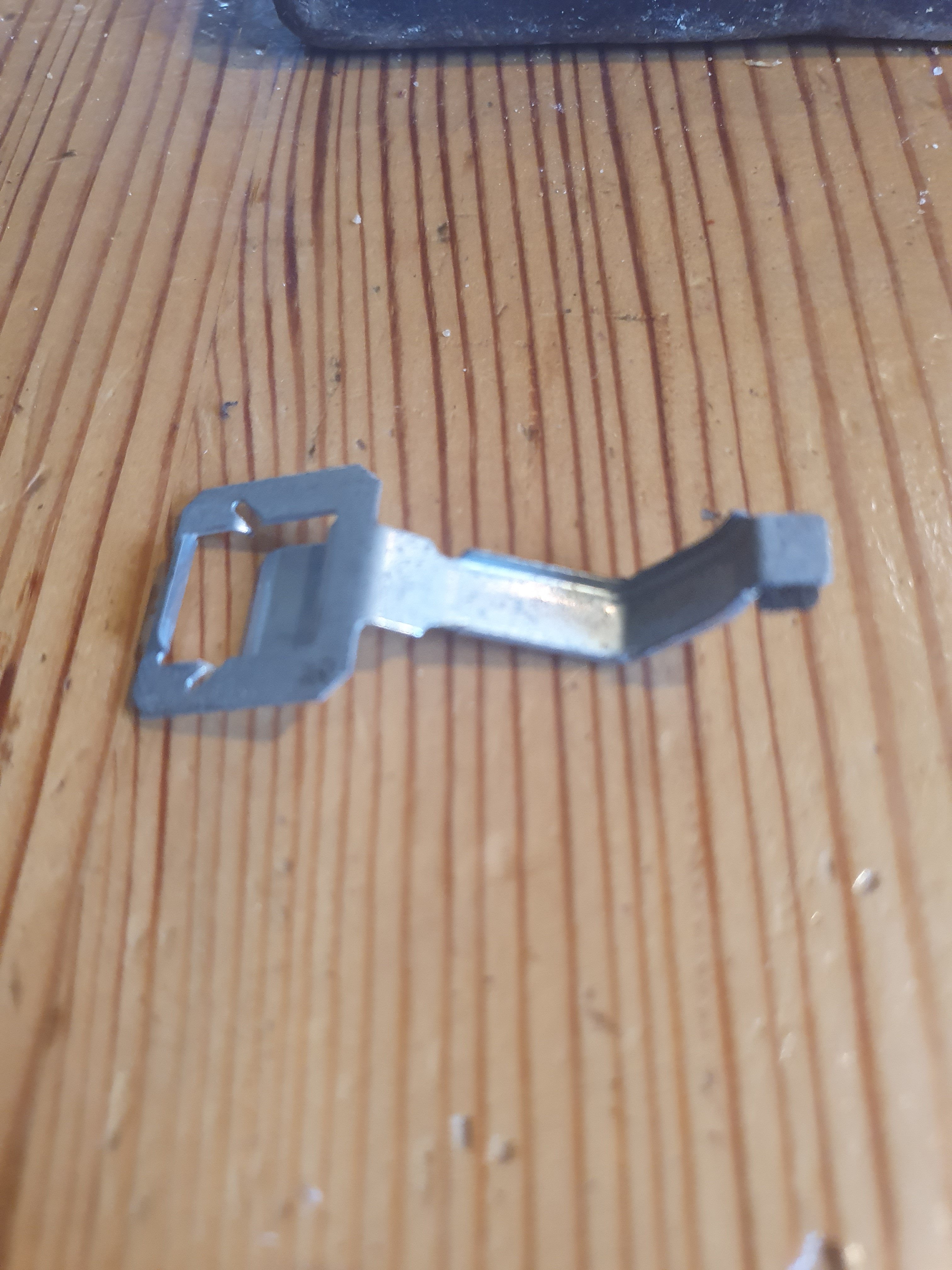

  17. All fixed. Had to remove the panel again. Turned out that the cable wasn't properly seated in the lock. Turning it around allowed an extra 15mm in the cable which solved the problem. Thanks for all the help. Justin

  20. Hello all I was taking the lower dash off to fit a relay on the fag lighter (loony that this is always live). A clip fell down from around the fuse box/drivers right knee. I can't immediately see where the clip goes back. Any experts with good memories out there?
