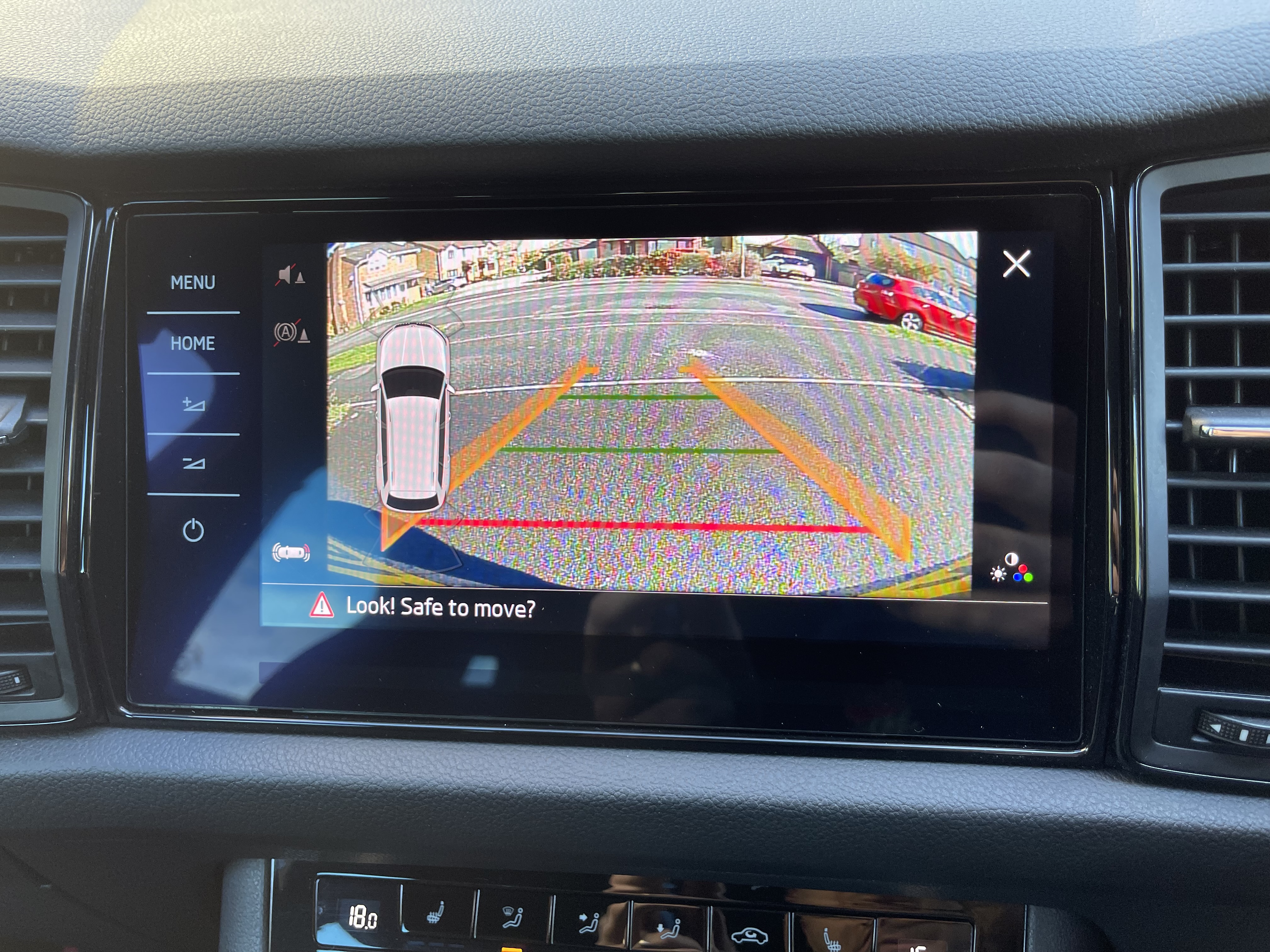

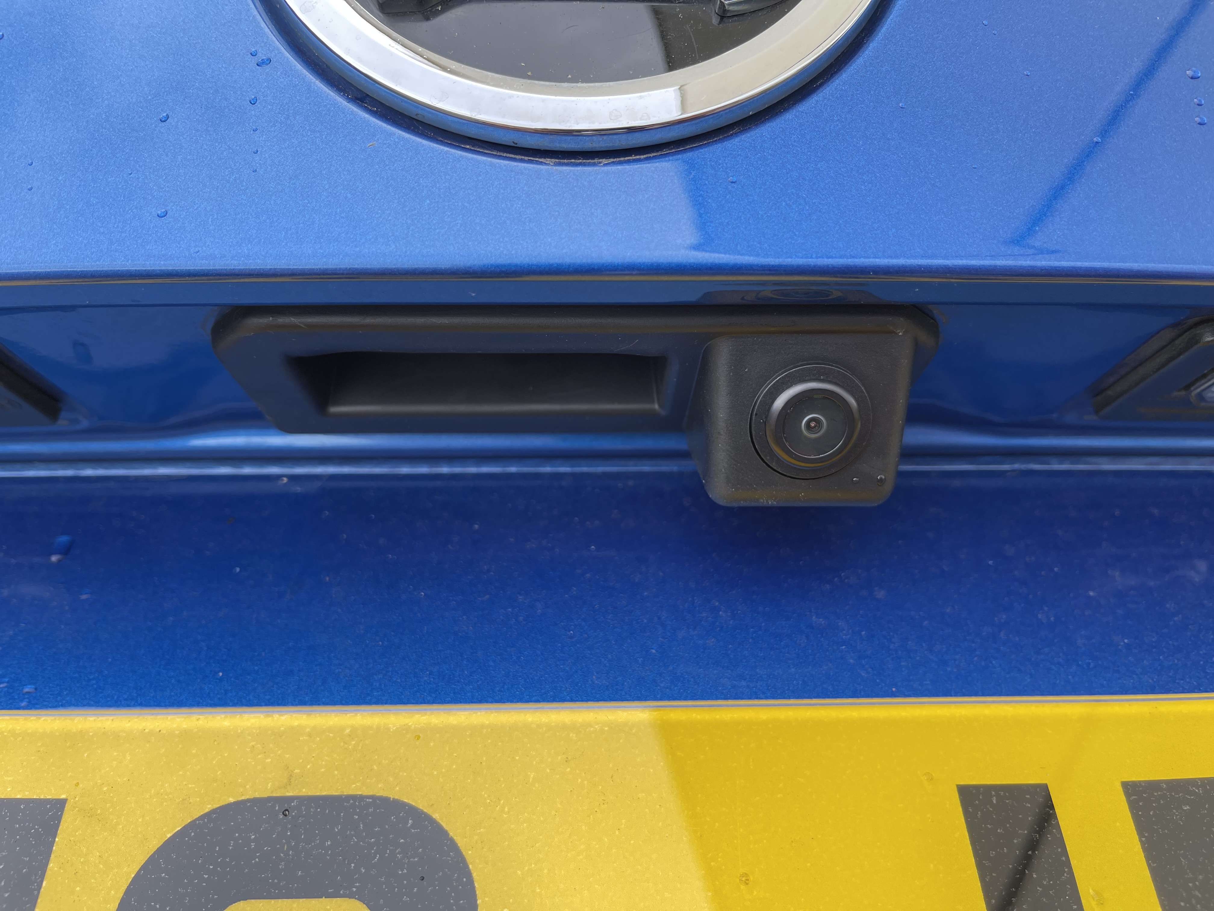

  1. Here are some photos.
  2. Hi Stewart yes I ordered the camera set from AliExpress. was delivered in 6 days to me. Fitted without issues and works without any coding. cost was Β£41.67 delivered
  3. Hi all. im looking to retro fit a reversing camera to my Kodiaq vRS. It’s a 2019 model. I have searched here and didn’t find anything where it has been done to this model before. I am looking at fitting an OEM or original tailgate handle with camera. Wondering if anyone has any experience with where to purchase the correct kit and if there is any additional programming needed and install. I would be confident in installing myself. Thanks
