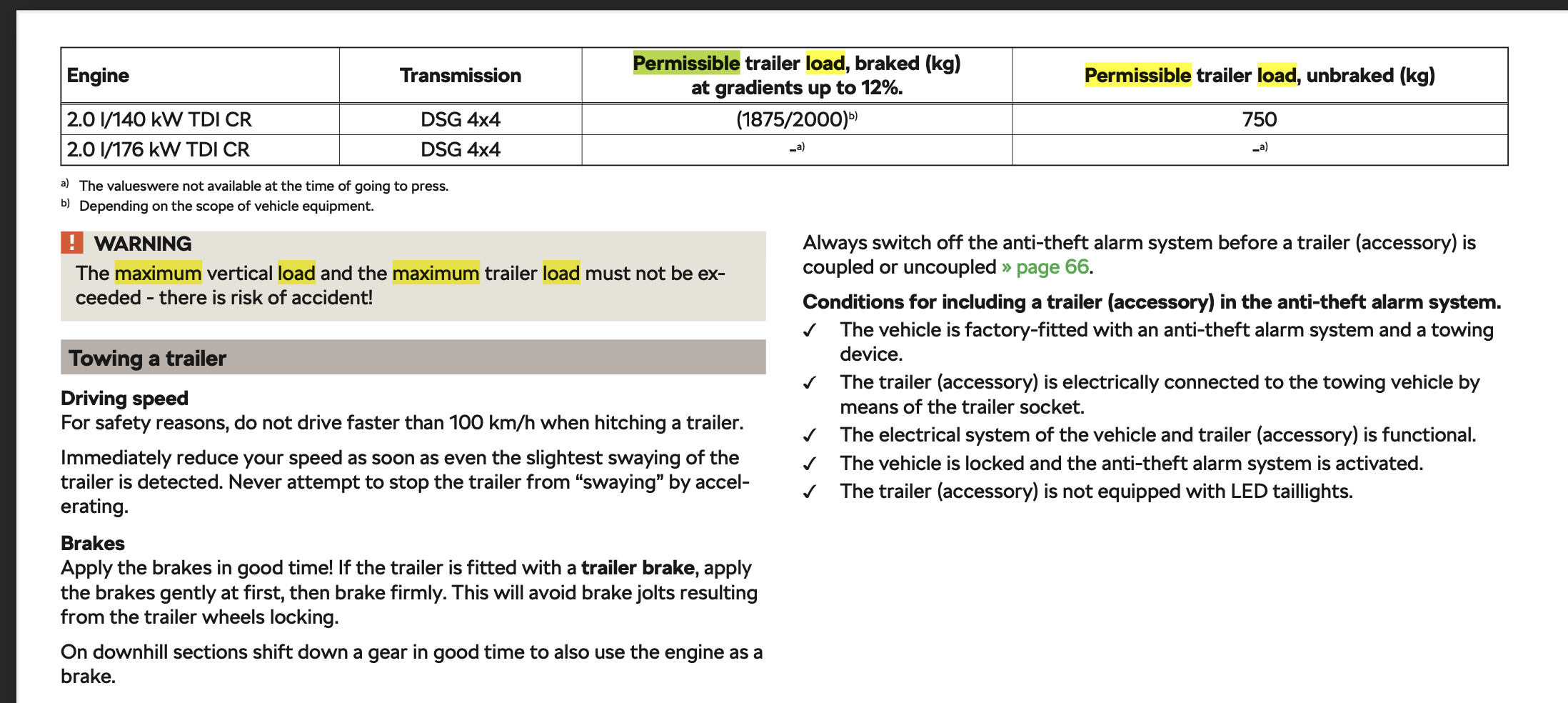

I punched in my VIN on the Skoda Website and brought up the user manual relative to my car.
The information for maximum permissible towing weight was there as was the maximum nose weight.
According to some sources, it depends if the vehicle was fitted with Towbar Prep or not as to whether there is a need for any upgraded engine components like cooling fans, aircon compressor etc.
I will try to reach out to a nearby Skoda dealership and see if they can obtain that for me.
Thank You
image.thumb.png.b28169d5ce66ea39e07f3244ed37f209.pngimage.thumb.png.22e427d3325e22dd51c439ed363d1fde.png
Errr... if you have a vRS, then you have the 176kW (236hp) engine. So no, the weights aren't there.
You are absolutely right.
a) Values were not available at time of going to press.

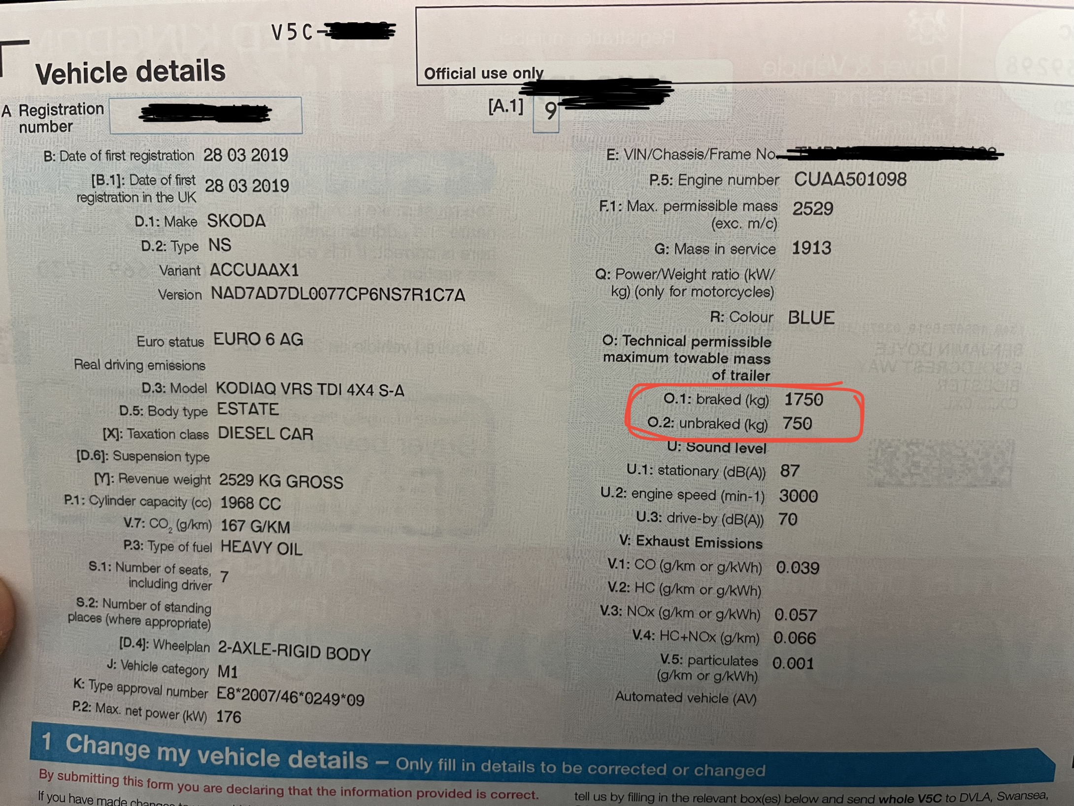

how convenient. Not sure how accurate the V5C is but that has 1750kg

On the vin plate, I checked on mine that It can tow 1750kg, however, without towbar prep, they can not fit one 😞

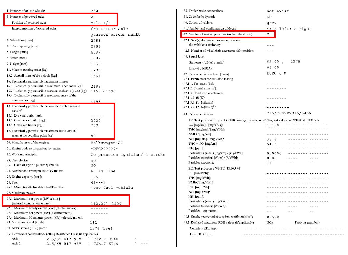

First of all, if you want the definitive figures for your car, ask Skoda for an EU Certificate of Conformity.  Legally, they are obliged to issue ONE, free, to the first purchaser of the vehicle.  They don't look like much (just a single sheet of A4 with lots of data printed on them), but they're a valuable legal document.  They're unique to each vehicle, so there won't be any messing around with weight ranges, it will simply tell you exactly what your car can legally tow, braked or unbraked, including nose weight.  Look around Field 18.  The certificate will have your car's 17 character VIN on it.
Secondly, towbar prep is, as has been said, various cooling system upgrades, plus the necessary interface for the wiring.  Lots of people (me included, have NOT had towbar prep and tow things.  There is no legal problem with doing so, but there may be warranty problems if you cook your engine whilst towing.  Just watch the temperature.  Most of the time, in the UK, unless you're towing the maximum weight in the middle of summer, up a steep hill, you'll be fine.
Thirdly, we had ours done by PF Jones in Manchester and we're happy with it.  Make sure you go for "coded" electrics.
Thanks all for your help.
I have PF Jones fitting a towing bar at the end of the month.
Everything  checked out in the end and the towing limit is 1,750kg
I retro fitted a towbar to my vrs back in 2019, and it has 1750kg as max weight on the plate inside the drivers door.  No cooling changes required etc, and tows like a dream with no issues.  Have a search for a previous thread I created with pics etc
