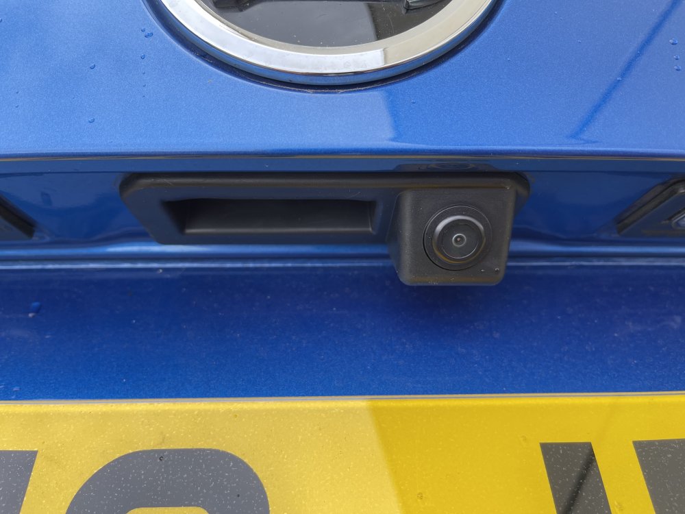

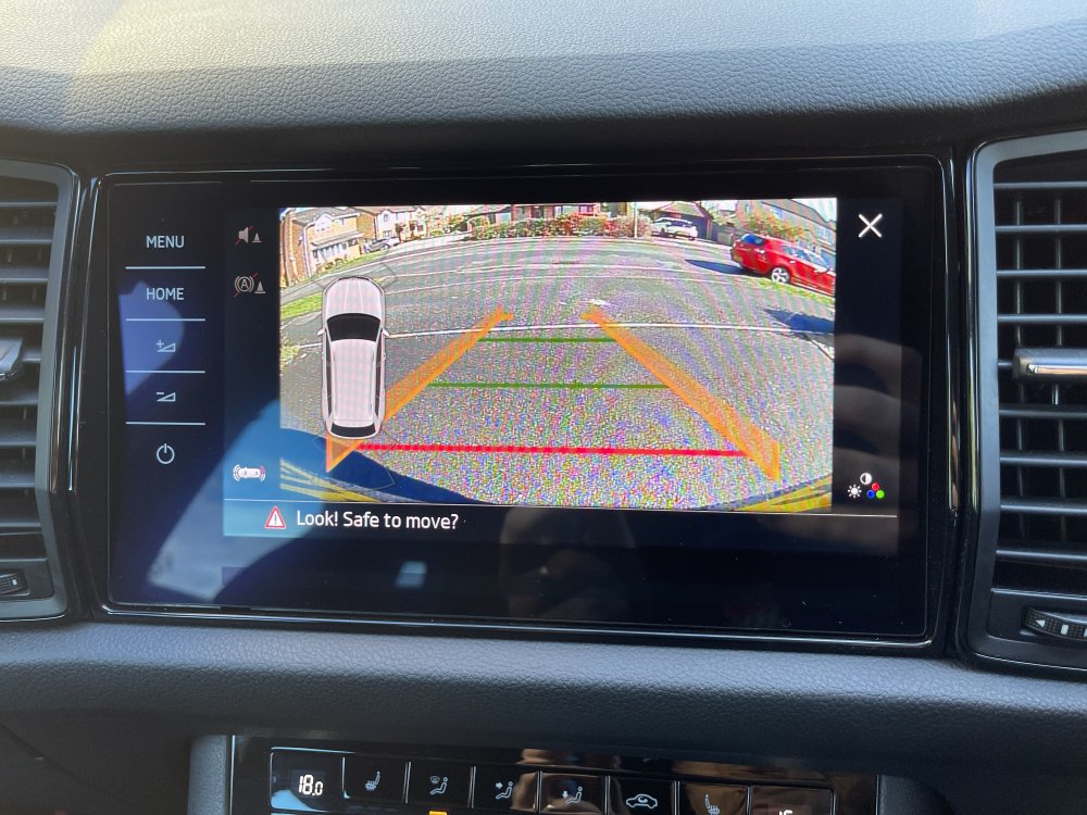

Hi Stewart
yes I ordered the camera set from AliExpress.
was delivered in 6 days to me.
Fitted without issues and works without any coding.
cost was £41.67 delivered
Edited by Magik
Here are some photos.
